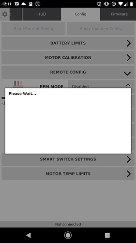

I have an Iphone. So first we tried to get unity app on @kook’s android to connect to it, but it wouldn’t find it. ( force quit metr on my phone so it wasn’t connected).
eventually did motor detection and config from metr. which I’d never done before. but it mostly worked. didn’t seem to get the hall sensor detection quite right though.

I think I’m running into the same issue here but with the Flipsky vx2. In the UI I had to set the uart to 115200 baud and applied that to get the remote input in. But when I go to calibrate it just hangs
and the motors are not going full speed.
