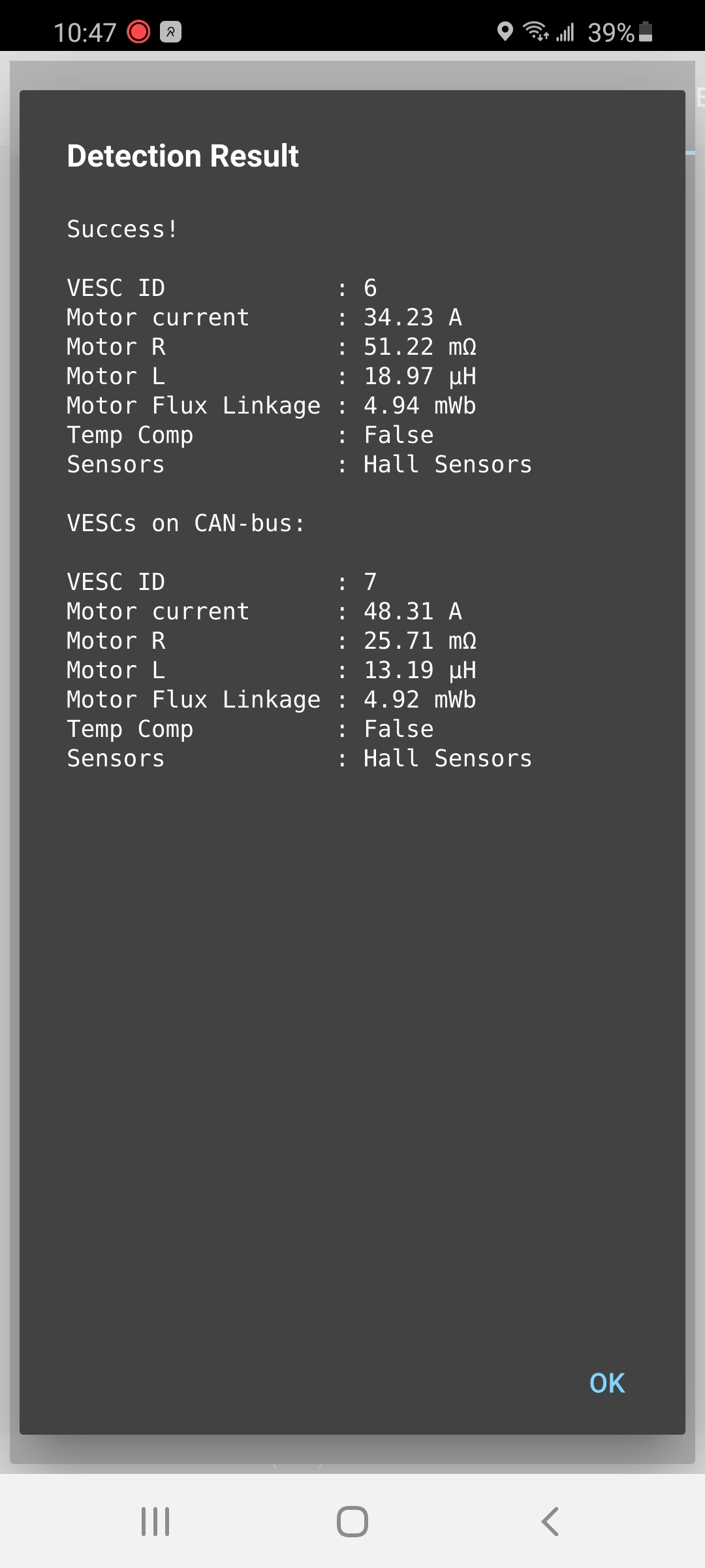

I tried to put my new unity from the raptor shop to work.
I had bench tested it on different motors and seemed fine.
So I decided to put it in my DB Coreflex build.
It has a 10s4p 30q pack.
Maytech 6354 170kv motors.
14/38 on 100mm Boas.
It had a Flipksky 4.20 dual in there and ran fine. But I thought it would be an upgrade to add the Unity instead.
I keep getting some weird values with motor detection. One vesc recommends 35 amps and the other 50…
I had turned both to 60 amps and tried to ride and got some weird stuttering on one of the motors.
Ohh. I’m running the unity on the vesc tool.
I reinstalled the latest firmware and have ran motor detection a bunch of times and have not gotten similar values for the motors.
Any more trouble shooting I can do.
Bullet connectors seem all good.

If you switch which side of the ESC the motors are connected to, does it switch the recommended currents?

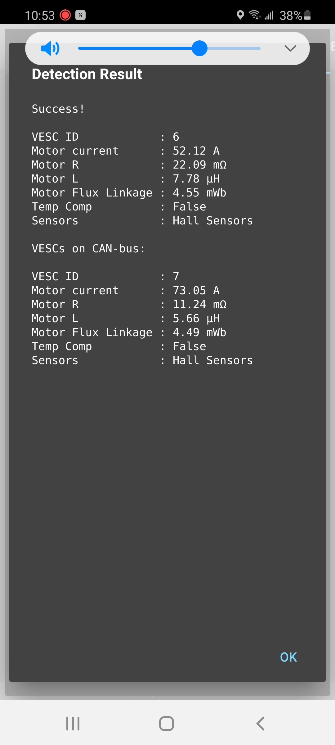

Ok. Just tried. The 35 stuck with the same vesc I’d. Going to slap on some other motors really quickly.
I had bad resistance measurements on one of my original unities on delivery and was told to send it to bara and that it was a bad resistor. Maybe check random resistors values on the side that’s giving you troubles.
If you switch motors and it remains this way than something is wrong with the controller. One seems to be detecting double the winding resistance, my best guess would be a bad leg in the three half bridges. Check solder on bullets. Otherwise it could be the FETs in which case it would probably need an expert to repair.

Still there.
Just slapped on the Flipksky 6384 190kvs and there is a big difference again low value on vesc 6.
So no fixing this right…
I guess I’ll contact them for service. And if needed file a credit card claim.
