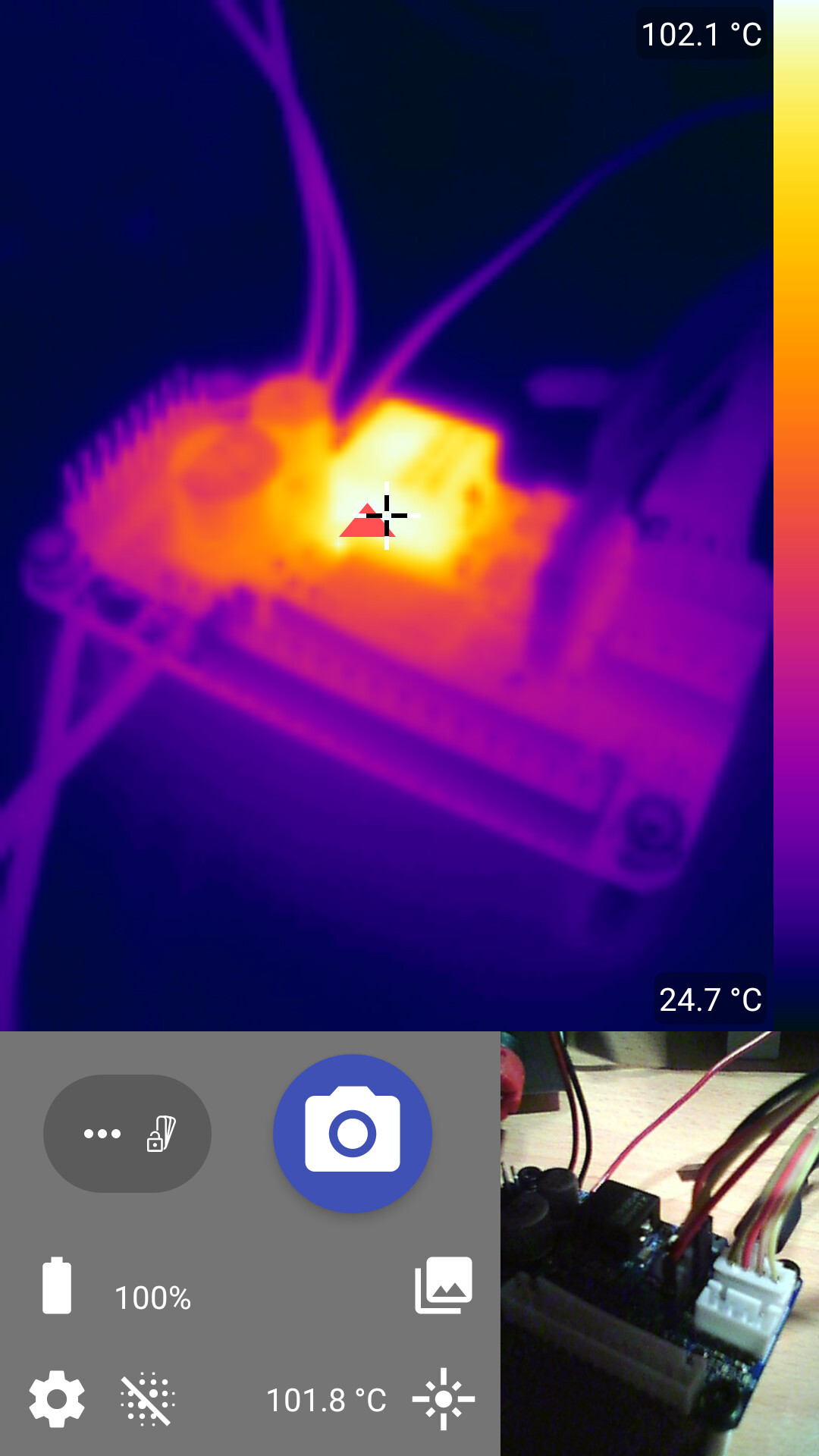

Don’t trigger me like this…
What a thermal nightmare it was…

@SimosMCmuffin any idea how much power loss it would have at 100W?
Well assuming we are boosting from the max 20V at the USB-C end to 12S ~50V at the battery… Depends on how many phases we can fit, I would probably try to get at least 2 to just distribute heat generation and minimize losses without eating too much board space…
2-6W I would guess/ballpark.
Is pretty low if we can heatsink it, using a ESC case should work, the losses of a ESC and probably way higher than this and even completely enclosed it manage the heat just fine
It would probably be okay if it had just a 3mm thick aluminium heatsink on the bottom that couples well to the inductors and FETs, just need more surface area then just on the power components to be able to deal with the heat in a reasonable way.

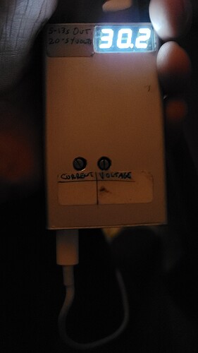

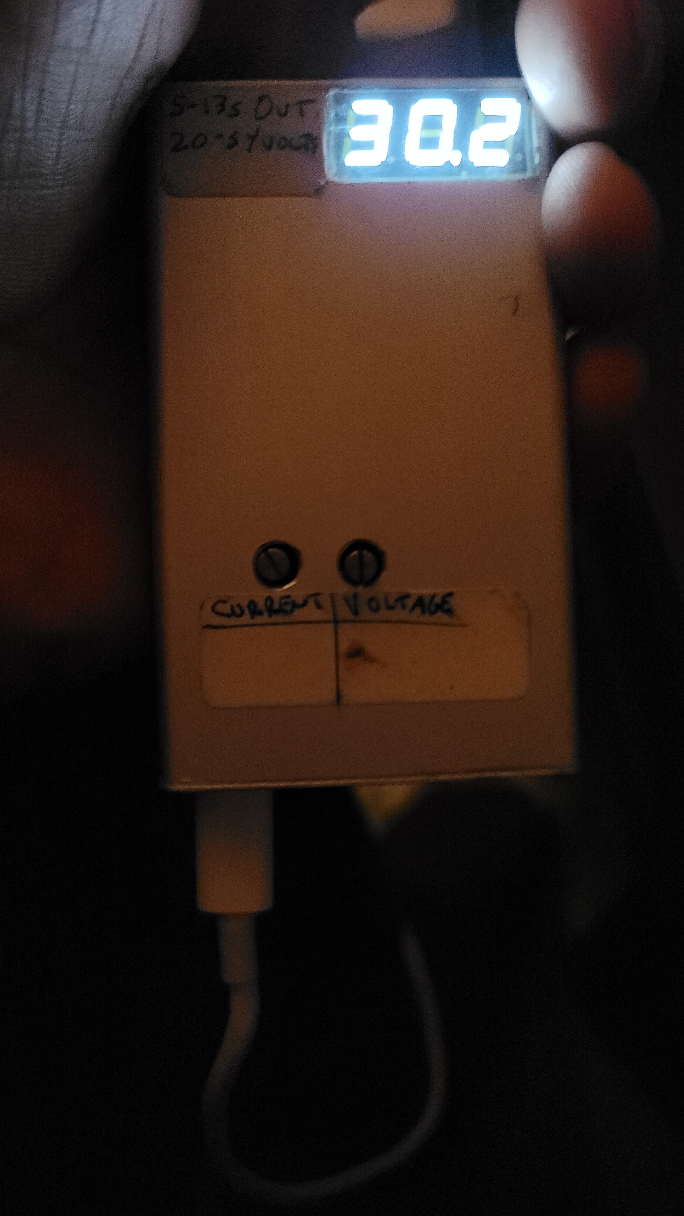

I’ve been doing this for a few years.
Nothing special and what would you like to know if
What I’m curious about without asking you to reveal all the innards.
Did you make it out of available modules or did you design your board and circuits?
What is this SD card connected to in the board?

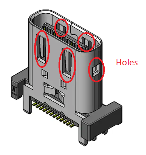

If we’re thinking of getting the design small enough to be integrated into the board enclosure.
Should the USB-C -connector be fixed to the power board or be on the end of a little bit of flexible cable so it can be more easily brought to the wall of the enclosure?
I did find some protective plugs for the female connector:
https://www.digikey.fi/product-detail/en/würth-elektronik/726144001/732-11387-ND/7244571
https://www.digikey.fi/product-detail/en/würth-elektronik/726144003/732-11389-ND/7244573

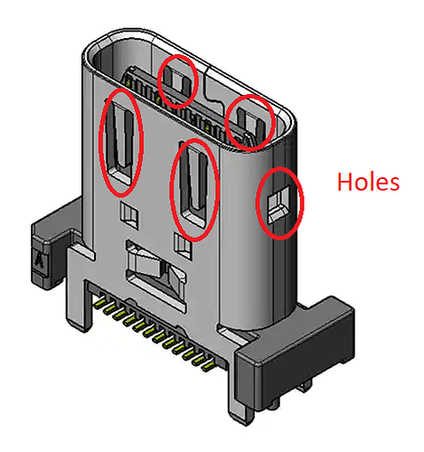

But figuring how to make the panel cutout pass-through at least dust and water resistant on the female USB -C itself would be a good thing to figure out.
And what I mean is that the mechanical assembly of the female end should be “one-piece” as much as possible in terms of no extra holes or anything, so that it when used with the protective end-cap would stop as much water and dust ingress.
vs

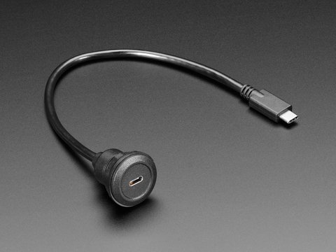

Something like this would be nice:

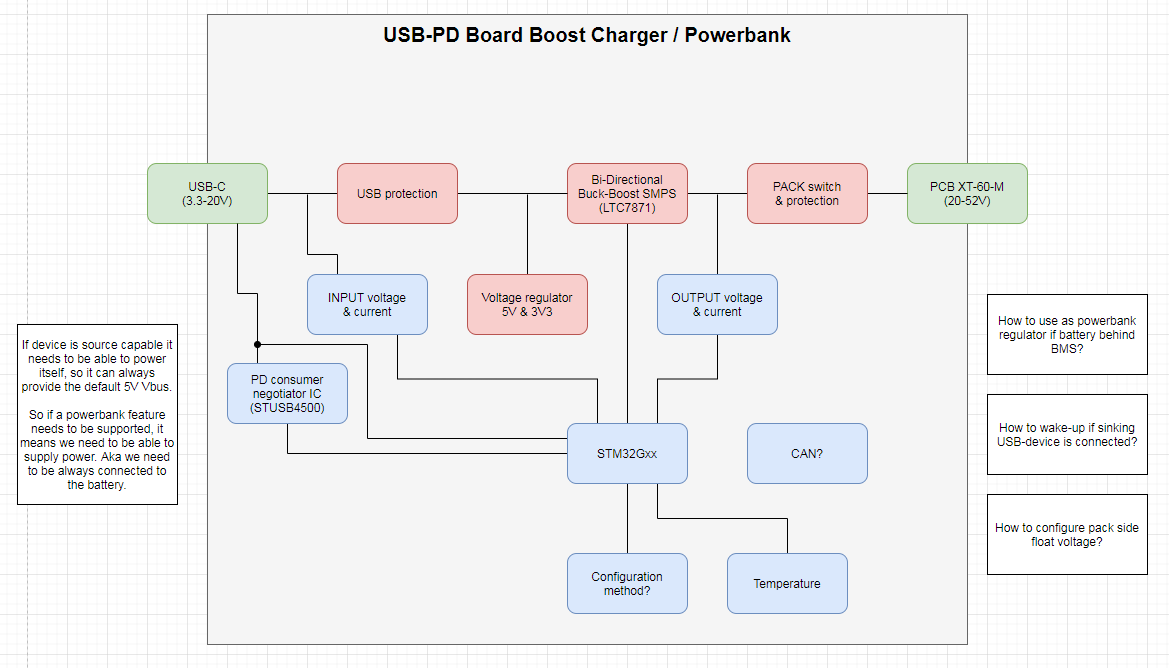

I’ve been working on the charger&powerbank concept and have pretty good idea hardware wise how to go about implementing it, but there are a couple challenging aspects that need to be solved to be able to support both the charging and powerbank use cases.
I will refer to the charger/powerbank module as a “charger module” in hereafter.
Here’s the current block diagram with a couple of the challenges written out in the white boxes.
First and foremost is the challenge of how to connect the charger module to the battery pack if there is a BMS in the system? Charging is easy whether the charger module is connected to the BMS’ charger side pins or directly to the pack, as the external power source can power-on the charger module, which can then boost the voltage up for the BMS’s charger connector, which should then detect the voltage on the charger side, close and connect the charger module to the battery.
But what do we do if the connected USB-device is a sinking device (e.g. phone). The charger module is separated from the battery pack by the BMS, so it can’t provide a pathway to the pack for the charger module to power up.
“Well, connect the charger module directly to the battery pack”
True, this would work. By skipping the BMS in the middle we can always stay powered and we can change between charger and powerbank mode freely, but now the BMS can’t stop the charge/discharge cycle if cells are hitting top or bottom termination limits… And that ain’t good…
From the higher design overview, having the BMS in the middle doesn’t really work, as the charger module will stay unpowered if the BMS blocks the pathway to the battery pack and a sinking USB-device is connected. So based on that I would say a direct connection to the pack would be the way to go. How do we then use the charger module in either charger or powerbank mode safely if we can’t directly monitor the pack cell voltages or temperature.
I’d say connect to the CAN-bus. FlexiBMS Lite for example supports getting the cell voltages and configuration values via the CAN-bus, so the charger module could monitor the battery pack cell voltages that way and keep it safe. Maybe provide also couple GPIO-inputs and -outputs that can signal start/stop-condition if the CAN-bus isn’t available.
But that’s what I’ve been trying to logic’ddddd out, but does that sound sensible?
The real challenge is the dual mode support, if it were one or the other then it would be much simpler (charger only, use with BMS. powerbank only, connect directly to pack), but because it needs to be able to change the power role there are some extra requirements that we need to be able to meet.
