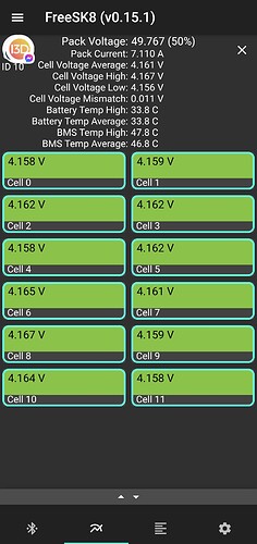

By default, the parameter $12, which controls the allowed difference between the cells, is set to 10, meaning cell voltages must be within 10mV from the lowest voltage cell to be considered “within” balance, if it’s above that range, then the cell will be balanced/bled towards the bottom voltage cell, until it is within that voltage range from it. 10mV is a pretty good tolerance that isn’t too loose or tight.
Just to also let everybody else hear about the solution to this problem that we figured out through email.
Yes, some leads from the balance connectors only made contact on the underside, not the top where the LTC6803 sits. SO I went ahead and resoldered those joints, and voila, now it works. :’D
So it looks like this was caused by bad/cold solder joints on the balance connector, which I’m guessing were causing some intermittency in the connection.

if i want to charge a 12s pack with 6A they default configuration should work, right? do i need to plug the usb in at all? or could i wire it up straight as is and charge?
Sounds like Future Motion built that battery
i know! happened while trying to figure out the cabeling as all pack connecting cables were red. will have to swap it.
hallelujah!
It is set up for 12S pack by default, so you should very likely be able to start using out-of-box. You can then later fine tune the settings.
I assume that’s a sold green, indicating charging. Once charging is done, it will do a double green blink to indicate that.
thanks!
it went to orange, (balancing) and the stopped and went off. no blinking but i assume that’s alright.

There shouldn’t be an orange color on the LED, did you mean yellow, which indicates balancing.
Now I can’t be 100% sure what FW the unit is running, but depending on if it’s running 0.17 or 0.18 (currently latest) there is a difference in the status LED indication at the end of charging.
I believe in the 0.17 when the charging finishes and the charger is still connected, the LED will just turn off, but balancing is still allowed to happen, which is indicated by the yellow color.
In the 0.18 there is now a dedicated end-of-charge LED color sequence of a double green blink to indicate that charging has finished.
