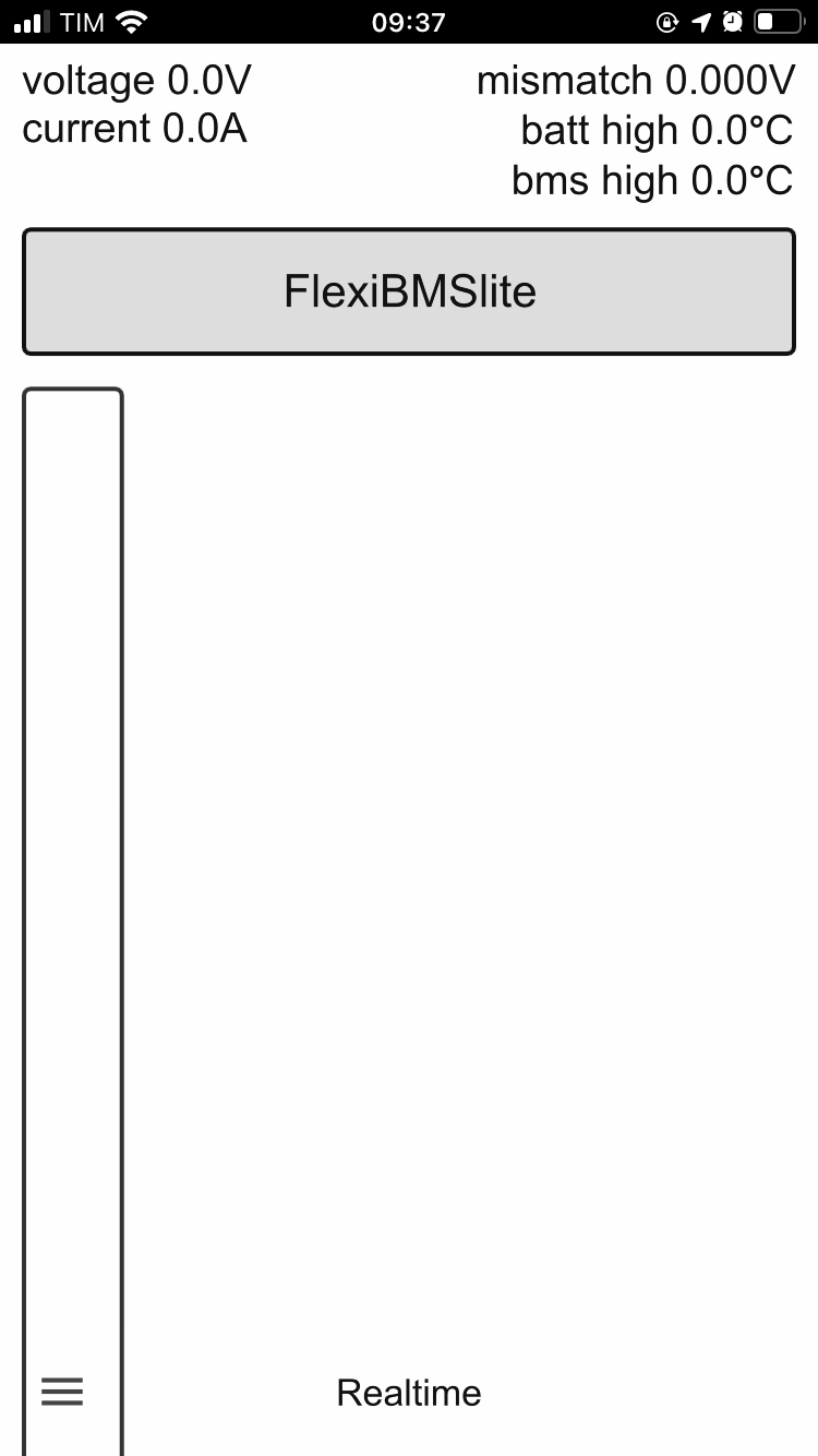

I’m having trouble setting up the FlexiBMS detection within the Metr Pro app after upgrading the battery.
I connected the bms to the new battery and set it up with the new CAN wake-up feature (following this instructions).
Metr Pro detects the bms and the tab FlexiBMSlite appear on the Expert page. Read and write also work as expected.
The problem it’s the realtime UI of the bms which is bugged. I’m not able to check cell’s voltage and main parameters, look at the screenshot below:
In Battery|Battery type I set “DieBie/Flexi/LLT” with * Battery|Auto Show* enabled and Miscellaneous|Detect DieBie/Flexi enabled.
Do you have latest Metr Pro firmware and FlexiBMSlite firmware?
Damn, I’m on the 5.28!! I totally forgot to upgrade the module :upside_down_face:
But unfortunately when I press “Upgrade” it download the firmware for about 1s and then I get Error: SHA-256 mismatch
Please try again!
It worked and fixed the bug!
Thank you so much :wink:
Best-fix-eva :smiley:

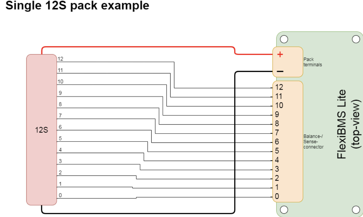

Hi There, Is there any sort of more detailed wiring guide or photo of a wired up pack for this? I’m not trying to become an expert and struggle to find my may through the Flood of information. Is there a simple way to hook this up on a 12s pack? The Wiring guide does not show me where the charge port goes or whether the wires go in relation to the P groups or where the actual output goes. If I look at other diagrams It’s always a little different and I don’t want to break it. Are those firmware updates necessary? I kind of imagined this a little more straight forward when I ordered. :clown_face:
Charge ports is opasit the pac terminals
Charge only BMS there is no output
0= pack -
1= P group 1+
2= Pgroup 2+
Ect ect
12= pack +
In battry talk you go from - counting up until pack pos
Don’t forget to Disconnect the connector from the PCB when wiring up
