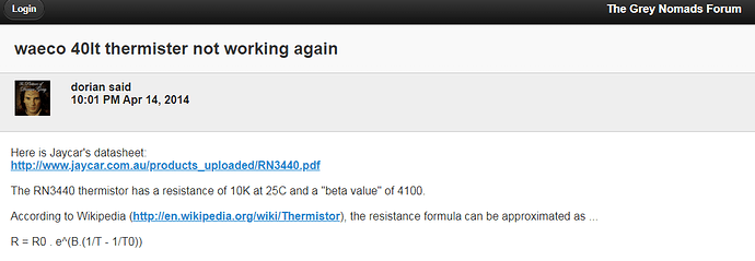

Any NTC-resistor with a 10kOhm resistance at 25C can be used, but check and configure the correct Beta-value.
That is a bit weird, I checked the store page and didn’t see the beta-value mentioned anywhere… nor a datasheet.
quick googling with the product number got a hit on a forum, which said that it has a Beta-value of 4100. Datasheet link is dead.

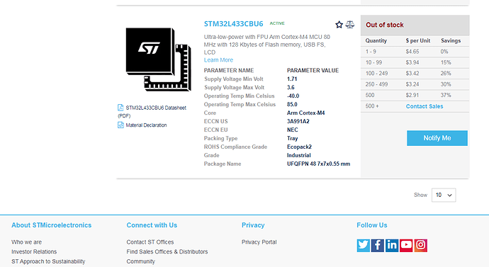

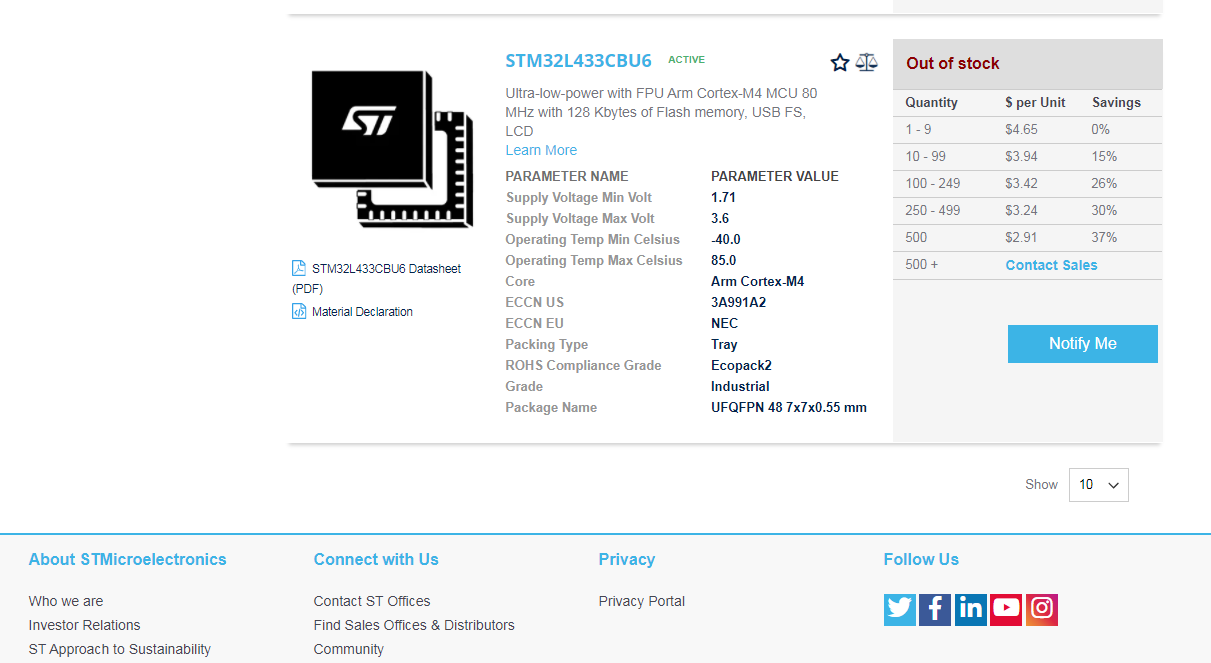

The STM32L433CBU6 is currently absolutely unobtainium. It doesn’t exist in stock, anywhere.
Even in STM’s own store it’s out-of-stock.
I also checked for the bigger flash version, STM32L433CCU6 with 256KB flash (CBU6 has 128KB flash) and the higher temperature rated one, STM32L433CCU3 instead, but both are also unobtainium.
So, unfortunately, and also to my big disappointment, the next build batch is completely on hold. Sorry.
I took inventory and I have 5 units of the MCU, but I think I’ll hold on to those for any possible repairs.
I also looked into different packaging of the MCU, like the TQFP- and WLCSP-packages, but they are also very low on availability. The TQFP, would require a bigger PCB, as it needs more real estate and to be able to use the WLCSP needs BGA level HDI (High Density Integration) for the board design and that requires some special pcb fabrication requirements.
The WLCSP-package with 49 balls (7x7 grid) would be smaller at ~3.3x3.3mm outline compared to the 48-pin QFN package at 7x7mm outline, but the pitch is an insane 0.4mm (distance between the balls on the bottom) that it requires a specialized PCB design and I have attached a video below that demonstrates the insanity of such a small package, with such many balls.

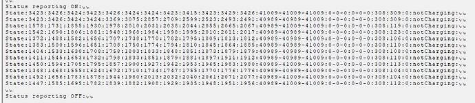

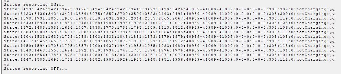

Hey @SimosMCmuffin, I’m getting some weird numbers from status reporting here. The first line shows how the cell voltage actually is (confirmed by measuring with a multimeter), then they start to fluctuate wildly. Funnily enough, the combined voltage stays correct, only cell level is weird. Also the temperature readings are jumping like crazy. I’m running 0.18 FW.
Update: Now its not doing the first line thing anymore, instead the correct voltages show up in a line somewhere into 5-10 seconds of reporting.
