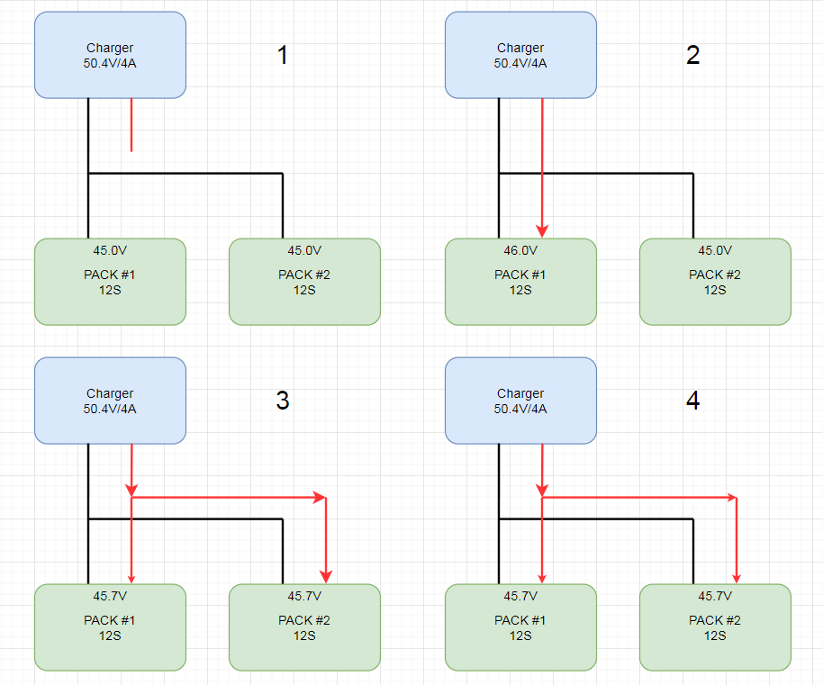

This is something that happens in multi-parallel pack setups with independent BMS for each parallel pack. The problem is that the BMSs need to be able to communicate to each other and figure out how to behave based on the pack voltages and possible faults from the other BMSs.
Here’s an example of a such setup. We have 2 packs with each of their own BMS and they will be connected to the same charger. Note, the values used are arbitrary, but somewhat realistic.
  1. Both packs are at 45.0V, no charger connected.
  2. Charger is connected and pack #1 starts to charge first, it’s voltage rises to 46.0V with the 4Amp current.
  3. Pack #2 starts to charge also. This causes the current to pack #1 to drop as the current now is spread to also pack #2. At the moment of starting the charge pack #1 is also at a higher voltage than pack #2, so pack #1 will actually for a short moment drop in voltage, exaggerating the current “drop” (4.0A → 0.5A momentarily) it sees at this moment and this might cause the termination current limit to trigger. (this is what @philo is seeing)
  4. After a short moment the two packs will even out both in voltage and charging current.
The above explanation is a generalized description of why the behavior @philo was seeing is happening.
But there are other possible scenarios where bigger problems may happen, say both packs are even and charging, but the other pack triggers a fault (e.g. bad crimp on a sense wire that causes intermittent dropping of a sensed cell voltage for it) and it starts to spend a lot of time in a fault state. If it’s intermittent then it might see the step 3 described above a multiple times, but if the fault stays on then it might completely stop charging, now you might have one pack at 50.0V and the other at 46.5V and this will most certainly cause the BMS to start ping-pong behaving while charging (basically the higher voltage pack won’t charge and the lower pack will and then the roles reverse at the next charging event).

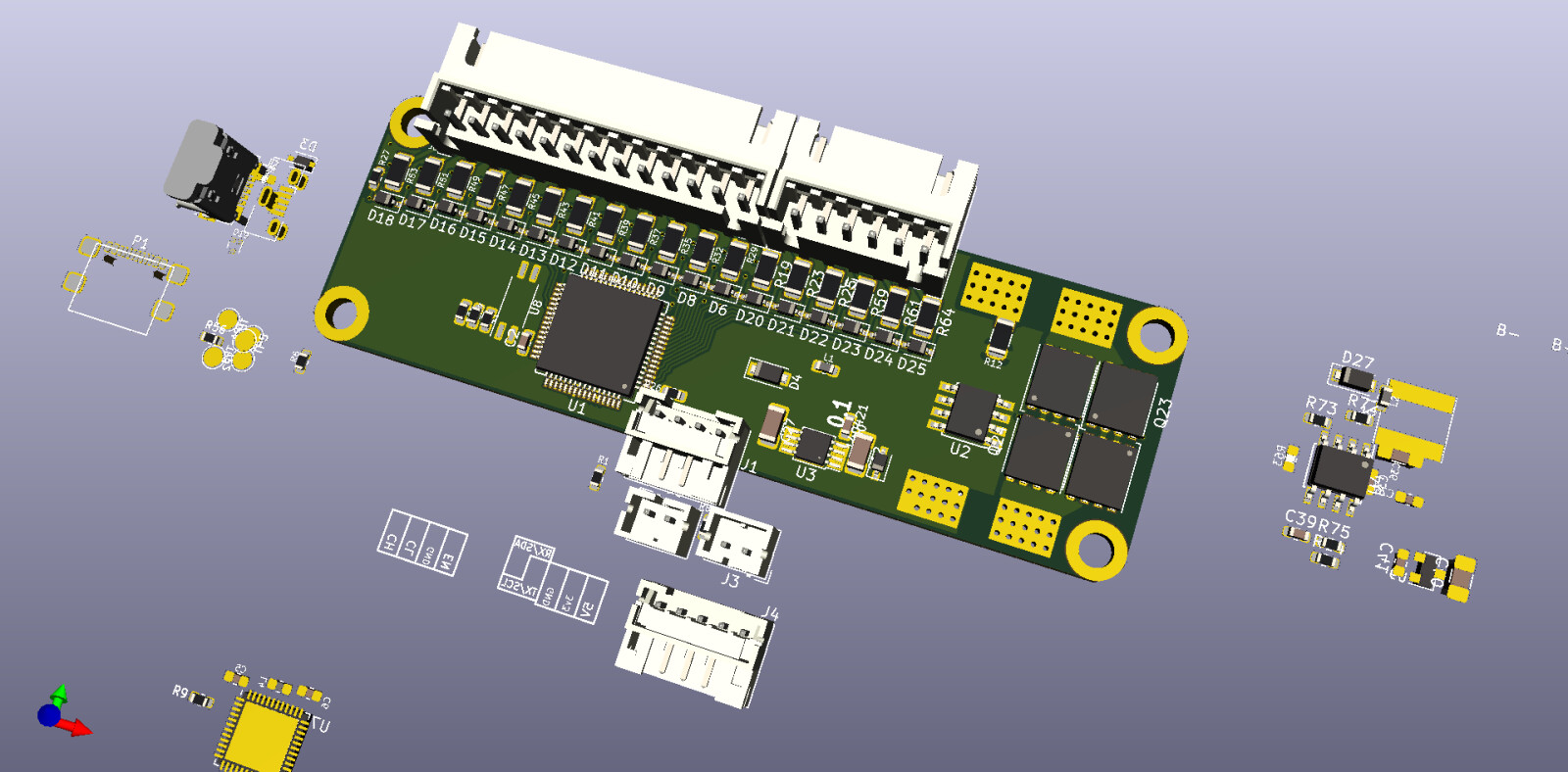

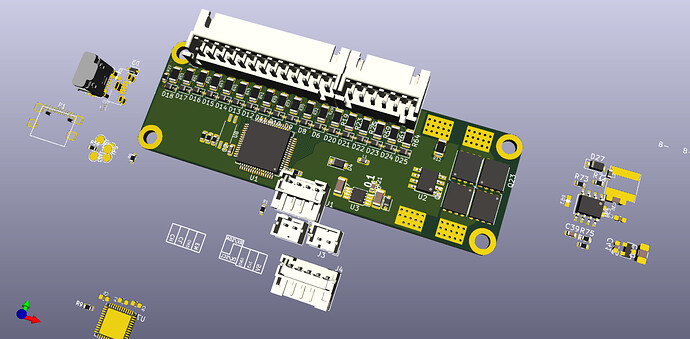

Weather has been improving and warming up, so I’ve been skating around a lot for the past week.
Progress on the Lite 12S is finished, but I haven’t ordered the boards yet, as I’m looking at what the component schedule is gonna look like.
Lite 18S is in the works. I think I might be able to keep the formfactor otherwise identical to the 12S, but the board has been stretched from 62mm length to 83mm to fit the additional balancing circuits for the extra 6 cells. I’m planning on keeping the JST XH-13 for the first 12 cells and then a JST XH-6 for the top 6 cells.
In addition I was looking at adding a USB-C -connector, but unfortunately it is bigger then a micro and as the pcb width is the same as before (26.5mm), it doesn’t neatly fit, so I’ll poll for opinion on this.

I have like 85mm of space length-wise to work with in my 16s build, so this is great news for me! :grinning_face_with_smiling_eyes:

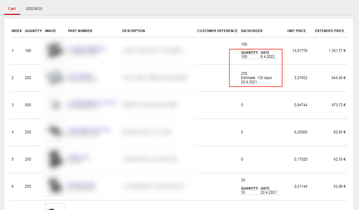

Also, here’s a little detail about why I don’t feel comfortable promising any kind of time schedule at the moment, which I believe is related to the coof and the global chip shortage.
We all know what chip that is :eyes:

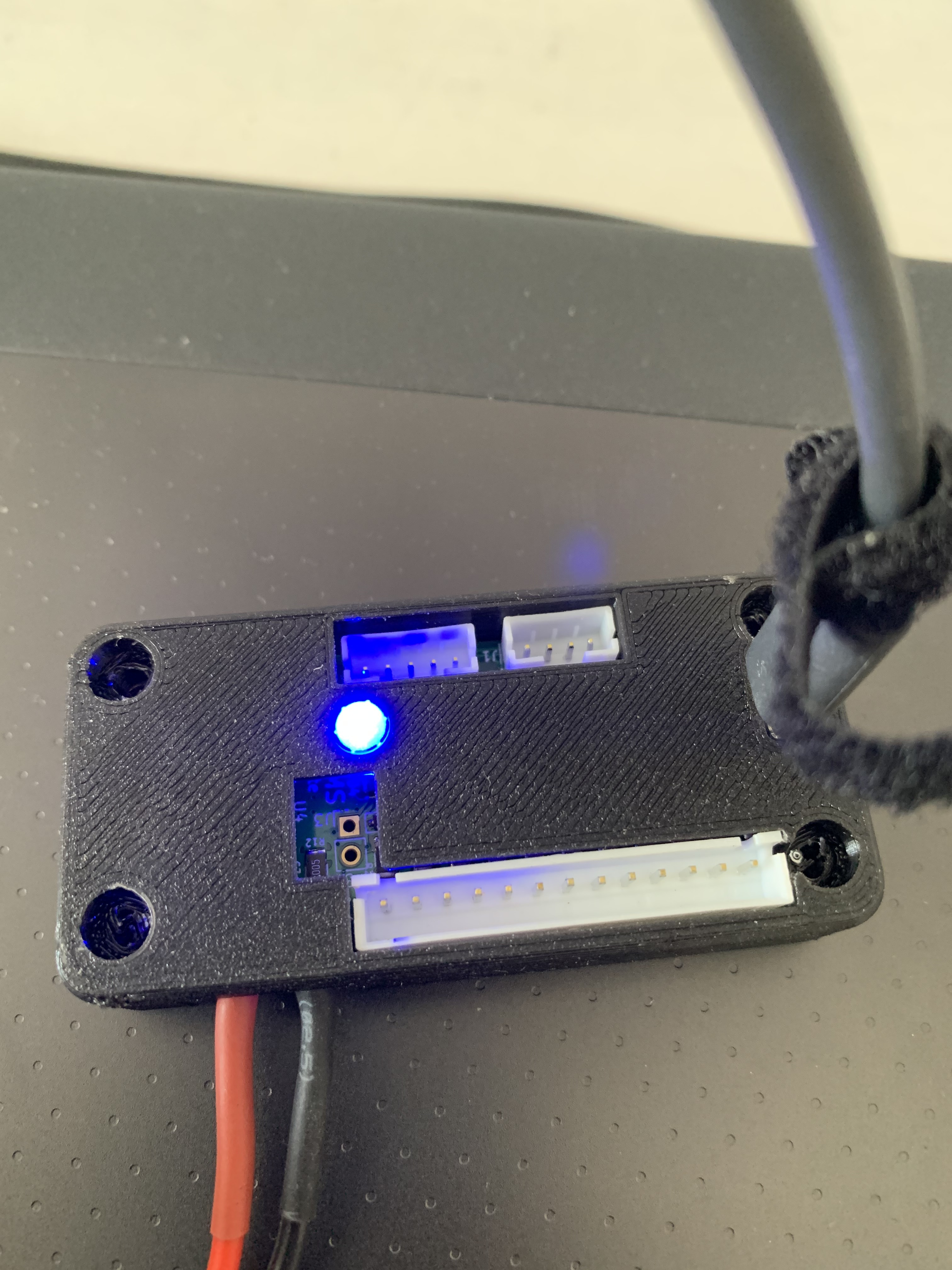

thx to @Darkie02 for the nice 3D Print file. FlexiBms fits perfect. Just added a smale led lightunnel :slight_smile:
IC shortage is very problematics for all of us, all STM32 are out of stock for upcoming months balancing IC as well. Components prices are going higher & higher :expressionless:

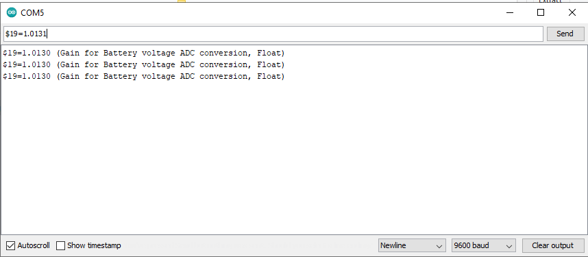

Hey @SimosMCmuffin any reason why when I try to set my $19 to the listed value of 1.0131, it reverts back to 1.0130?
Trying it a few times just jumps back to 1.0130. It will accept 1.0132 but not 1.0131 strangely.

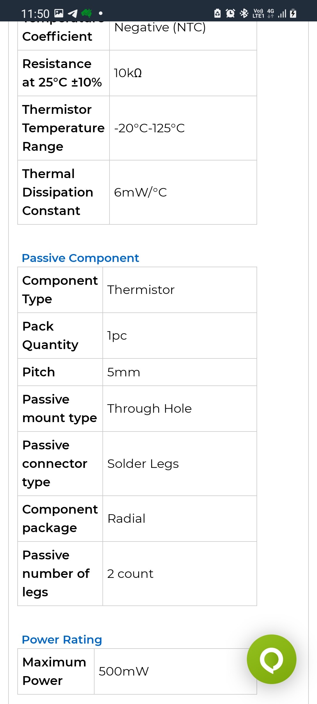

Also while I got you, any recommendation for a part to use for external ntc probe?
Cheers
@SimosMCmuffin do you know if I can use this?
https://www.jaycar.com.au/10k-epoxy-dip-ntc-thermistor/p/RN3440
Doesn’t have listed beta value?
I asked about this earlier, because I ran into the same issue. Apparently it has to do with the float conversion. When you send the value, it gets saved correctly so don’t worry about it.
Thanks man, sorry should have trawled but not sure what to search on that. I’ve done some testing and calculating on the ntc thermistor I boight and with my very inaccurate instruments it seems to have a calculated beta of approx 4000 so should be good.
