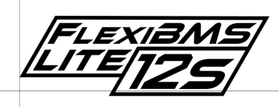

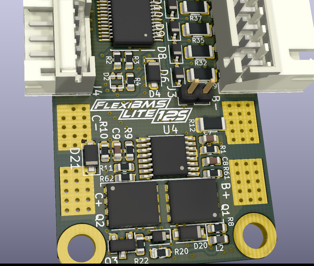

This logos are meant for the silkscreen on the pcb, as shown below
This is important context, I think the logo you picked in this layup is perfect, the stepdown of the text around the connector looks incredibly clean.
I like 3 to 5 the best.

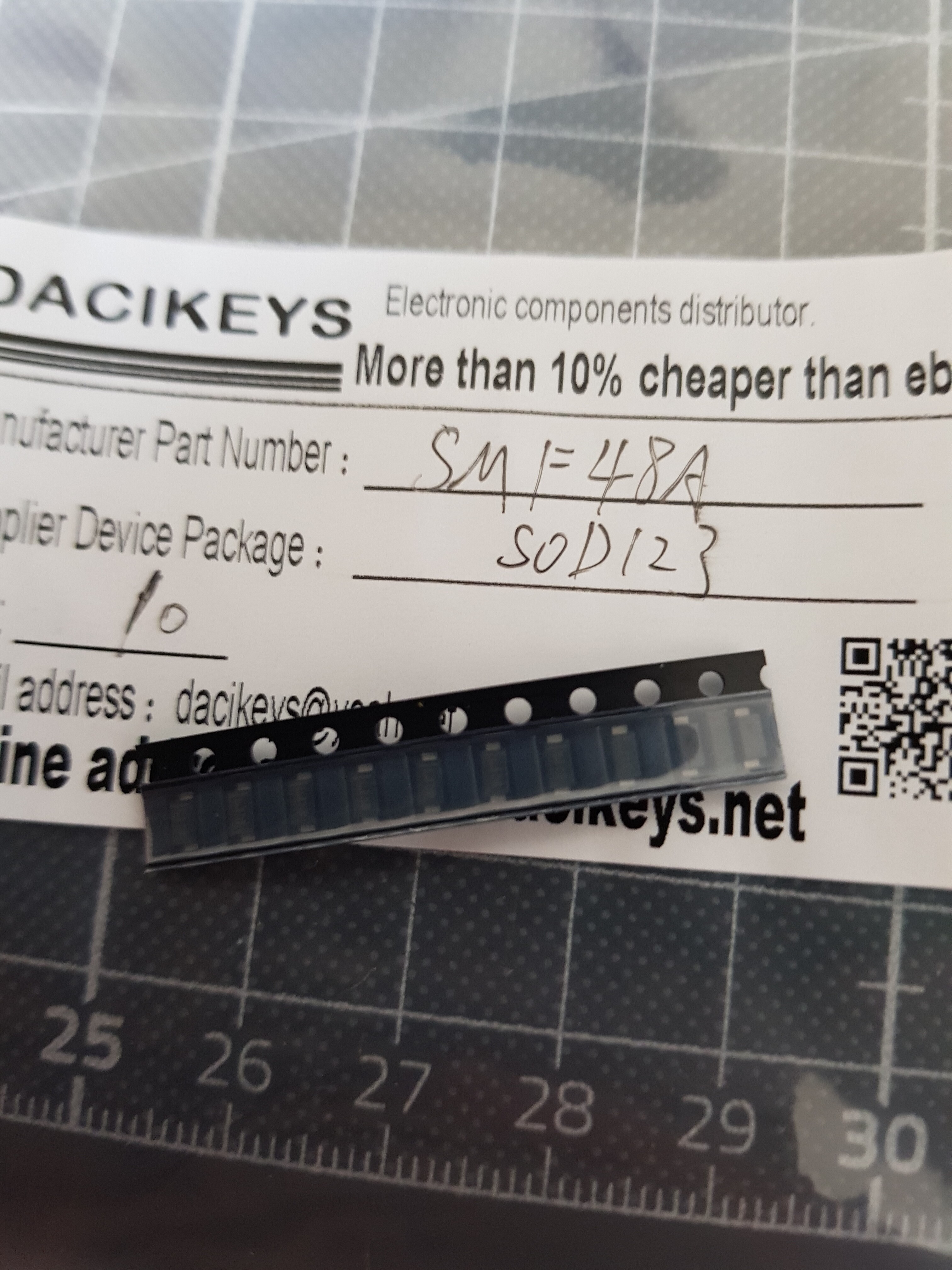

Hey @SimosMCmuffin, these are the correct ones, yes? :grinning_face_with_smiling_eyes:
Those are in your possesion or?
If so id like to get one off you :grin:

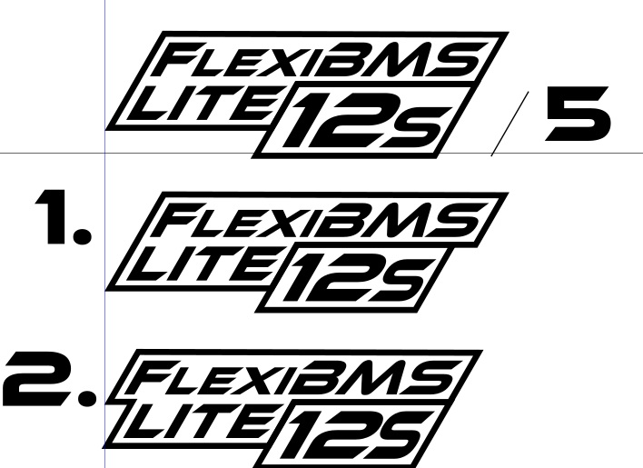

I like it!
The final “S” looks a lot like a “5” though.
This crowd knows it’s “12S” and not “125” but in my opinion a logo should be readable even at a quick glance…especially at a quick glance actually. :slightly_smiling_face:
Yes. :slight_smile: They should be the right ones, but I’m waiting for Simos confirmation. If they’re ok, I can send you one.

Turn 6 into a lightning bolt! You know, because electricity.

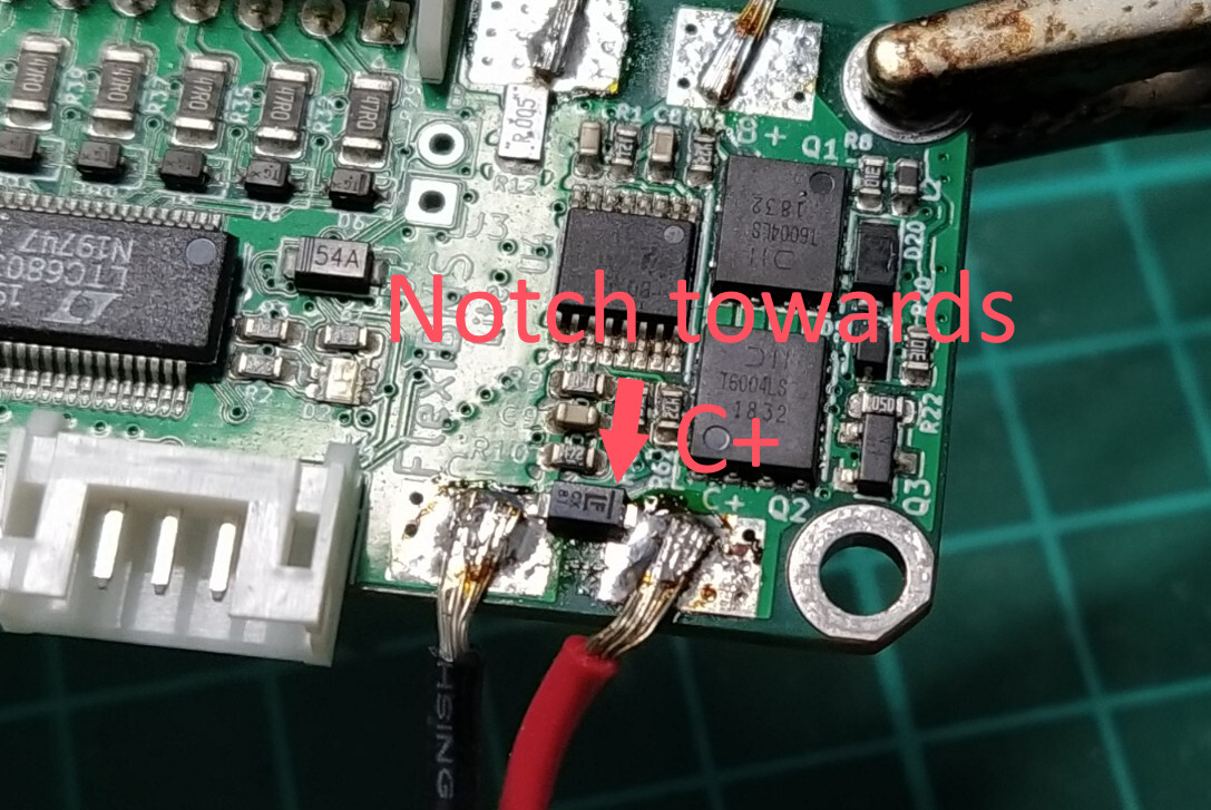

They are the correct ones for the charger port ESD-protection.
Remember, line towards the C+ pad
Thanks, I will remember. :slight_smile:
Unfortunately the S-letter in the particular font looks pretty rounded and like the number 5 except for the rounded corners.
Would it look more distinct if it was smaller? I suppose I could also use a whole different font for that S.
Use a different font for the entire number. That would also give off that there are multiple versions (in the future :stuck_out_tongue: )

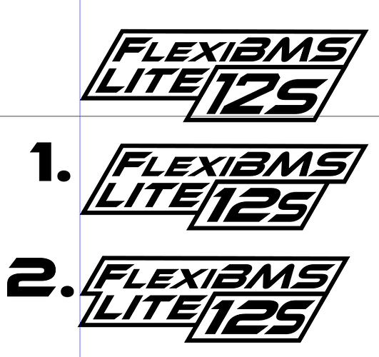

A variant of 3&4 where lite and 12s is pushed so that Lite gets centered under FlexiBMS

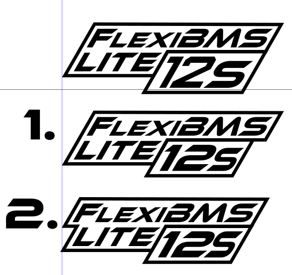

The smaller S definitely helps and the different font for 12 as well. This is pretty good:
So an in-between of 2 and 3, position wise?

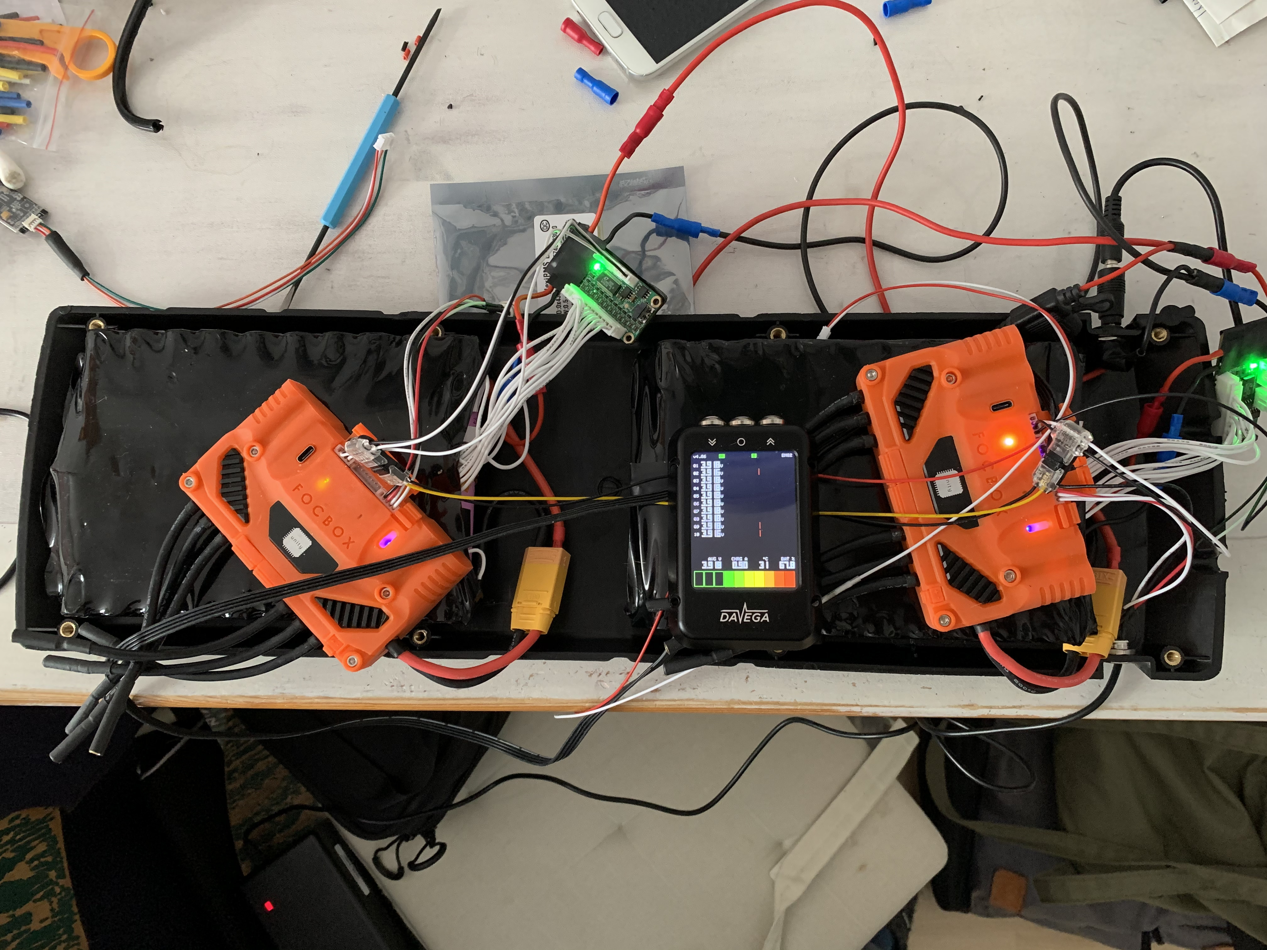

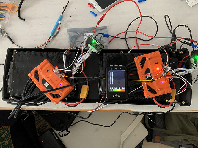

Little bit chaotic but working perfectly :grin:
Did also my first test ride. No issues beside loosing some screws i forgot to tighten :crazy_face:
I had some issues with charging both batteries together with my 2A/42V charger. The first BMS always stoped charging when the second BMS was also started. I solved it by setting parameter $2 ( Charging termination current limit, once current falls below this, the charging will be terminated …) on a very low current.
You could drop the lite now and call it
Flexi BMS 12s (S smaller and lower case or like the squared sign)
