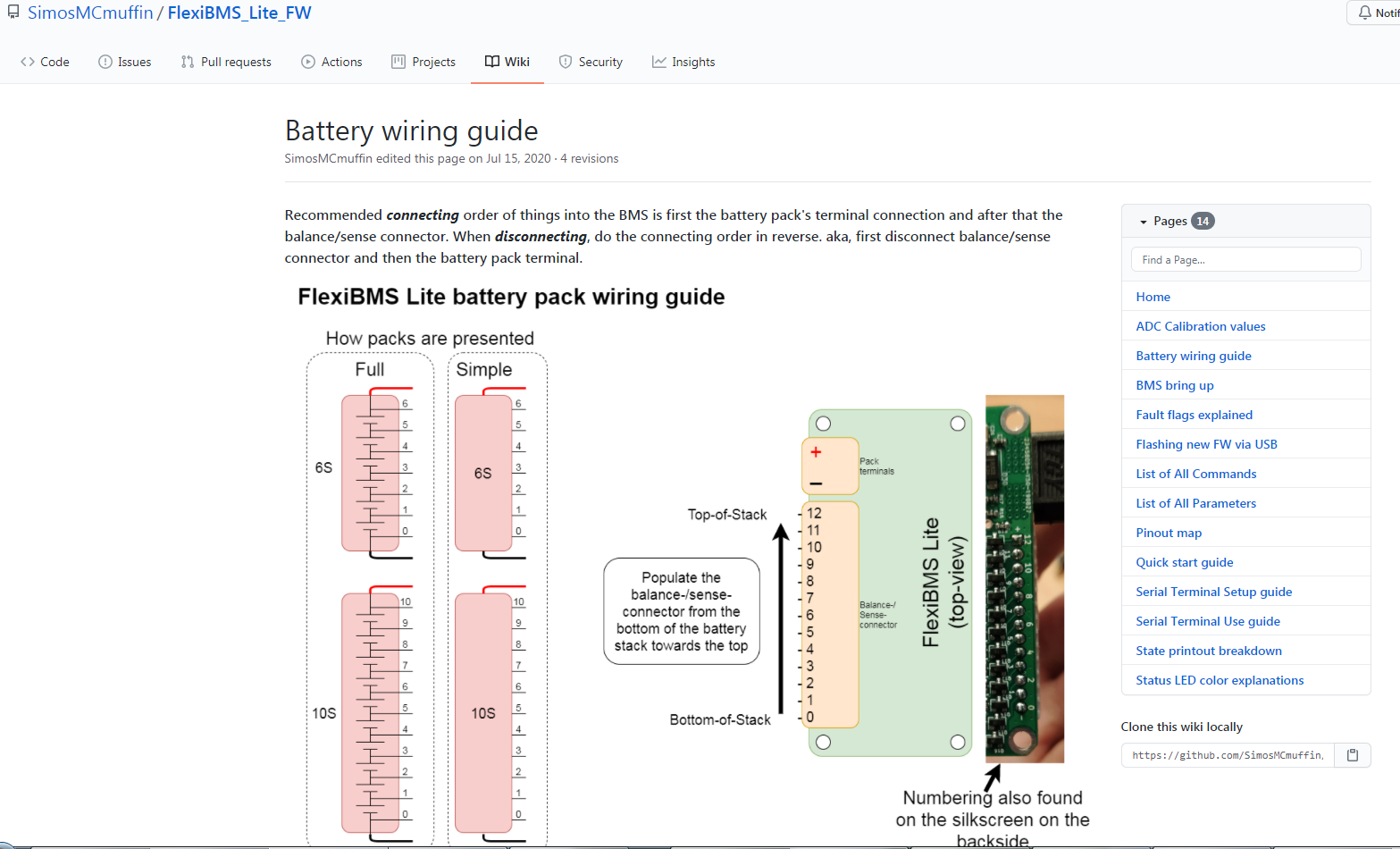

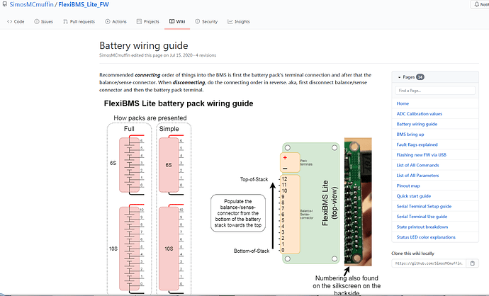

I have been in contact with a user that had problems with their new pack releasing the smoke from their BMS upon connecting the cell balance/sense connector. I asked about the steps in which they connected the battery terminal and balance connector and they did it in the correct order, first terminal connector and then balance connector → smoke. “Ok, can you measure the voltages on the battery pack terminals and balance/sense connector?”
“Sure.”
Couldn’t see anything wrong with the voltages, as they all increased in a linear order, indicating that there wasn’t a crossed/mixed balance wire in the loom, which I would have suspected first. Ok, maybe it was a bad unit, they can send the first one for free repairs… They luckily had another unit, so I said go ahead and connect that one and it also let out the smoke when the balance connector was connected again… What?.. This is not making sense, these units have been tested before shipping out, but we couldn’t find anything wrong with the voltage at the terminal or at the balance connector…
I mean I guess it’s possible that the two units were somehow faulty… I just can’t figure out how, at all. I’m completely flummoxed at this point. Luckily they had a friend they could get a loaner FlexiBMS from to try with. Ok, that should be a tested proven to work unit, likely.
Poof it went again upon the connection of the balance connector… So, they had said that they had built an earlier pack with a FlexiBMS in use, so I believed that they knew how to wire the pack and BMS correctly, but now all three units had blown on this new pack they were building. At this point, I was pretty convinced that it must be something to do with the new pack, but all the voltages looked alright… “Can you measure all the voltages against ground/B- from the battery pack and write them down?”
Next reply (paraphrasing):
“Oh S***, I realized that I had wired the balance connector the wrong way around”
Well that explains the smoke. So to clarify, they had accidentally populated the balance connector that instead of the bottom-of-stack cells being at the USB-connector end and “rising up” towards the other end, they were at the pack terminal end and the top-of-stack cells were connected to the USB-connector end. Funny thing was that they had wired their own first pack that was in their board and in use correctly, but made this mistake for the new pack.
Anyway, I currently have the 3 units on-hand and I’m repairing them and re-testing them before sending them pack. Unfortunately, as it was user error and the LTC6803 and the MCU seem to have popped from the units, which are the most expensive components. I’ll take the cost of the components, a little bit for the work (troubleshooting, reflow, repeating and retesting) and shipping them back to the user.
Check your wiring:

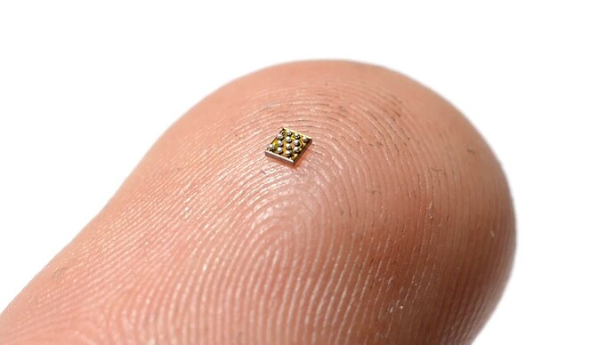

My goal at the moment is to wrap my hands around STM’s manufacturing chief’s neck and gently ask them “Where are the chips!?” (JK). I’m currently limited by the global chip shortage and can’t therefore manufacture as many BMS units as I would like.
As soon as you have them available again I’m ripping two of them flexis out of your hands. :grinning_face_with_smiling_eyes::100:
Wanna come march to the STM’s offices with me :smiley:?
Always suspect a lot of confusion if you count from neg to pos or the wrong other way around.
Testing to prongs on the connector is dangeras procida but a very important one.

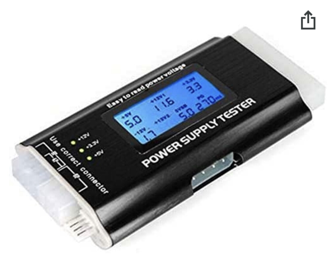

How exdpncive would it be to make a cheep pcb that could plug in and check for you? Some thing that could take any balance lead plunged in the wrong order with out showing the magi smoke. $10-15 I could see people buying if that hadf a couple of Battery’s to build
A red dot and a black dot on the PCB near the ends of the connector could help a whole lot.
So, you plug in the balance connector to this little device and it would show if the cell order is correct or wrong, or atleast if they are out of order?

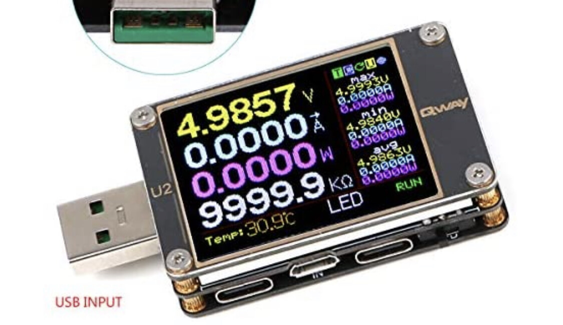

Yes just no idea if I could be made in a way that’s not to exspncive that people would buy it. Just a idea of a product you could expand your range with.
I have them for pc building to check PSU / amp draw on on cables and voltage stability.
If it show p group voltage it would help people who don’t have smart BMS as well. Unsure of how many different types of plugs are used in battery’s to how viable it would be

https://uk.farnell.com/stmicroelectronics/stm32l433ccy6tr/mcu-arm-cortex-m4-80mhz-wlcsp/dp/2855695?st=STM32L433C
Those STM32L433CCY6TR have different soldering technic but aren’t they basically the same ? - I imagine it would not be too hard to change pcb to take this instead ?
There are over 250pcs stock now and the price is a lot cheaper than 3.5 vs like 6 for cc6

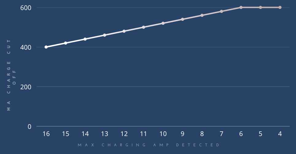

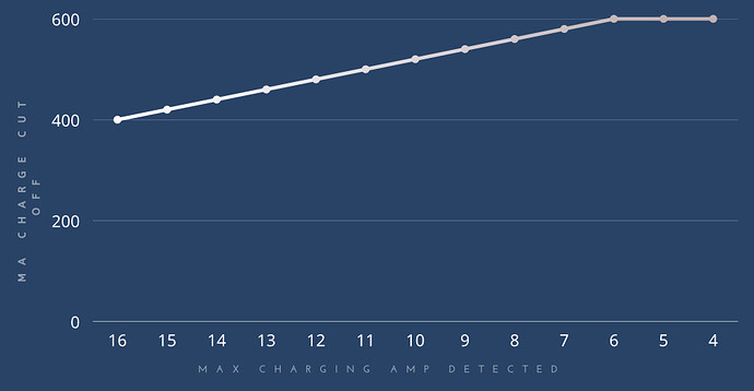

$2 alows me to set a static charge termination current witch is ok if you only ever use 1 charger. If I want to use a fast charge occasionally and still follow manufactures advice I would need to charge the settings on the fly that is possible through the metr pro but not ideal.
Is it possible for the flexi to calculate a table from 2 different charge amp and mA cut off and work out it’s cut off from the max charg ampage of that charge cycle?
Eg for a 4p q30 pack
Standard charge 1.5A X P group = 6A
Charge cut off 150mA X P group = 600mA
Fast charge 4A X P group = 16A
charge cut off 100mA X P group =400ma
So if you plugged in a 10a charger (max the flexi is rated for) it would set the cut off at 520mA automatically for that charge
