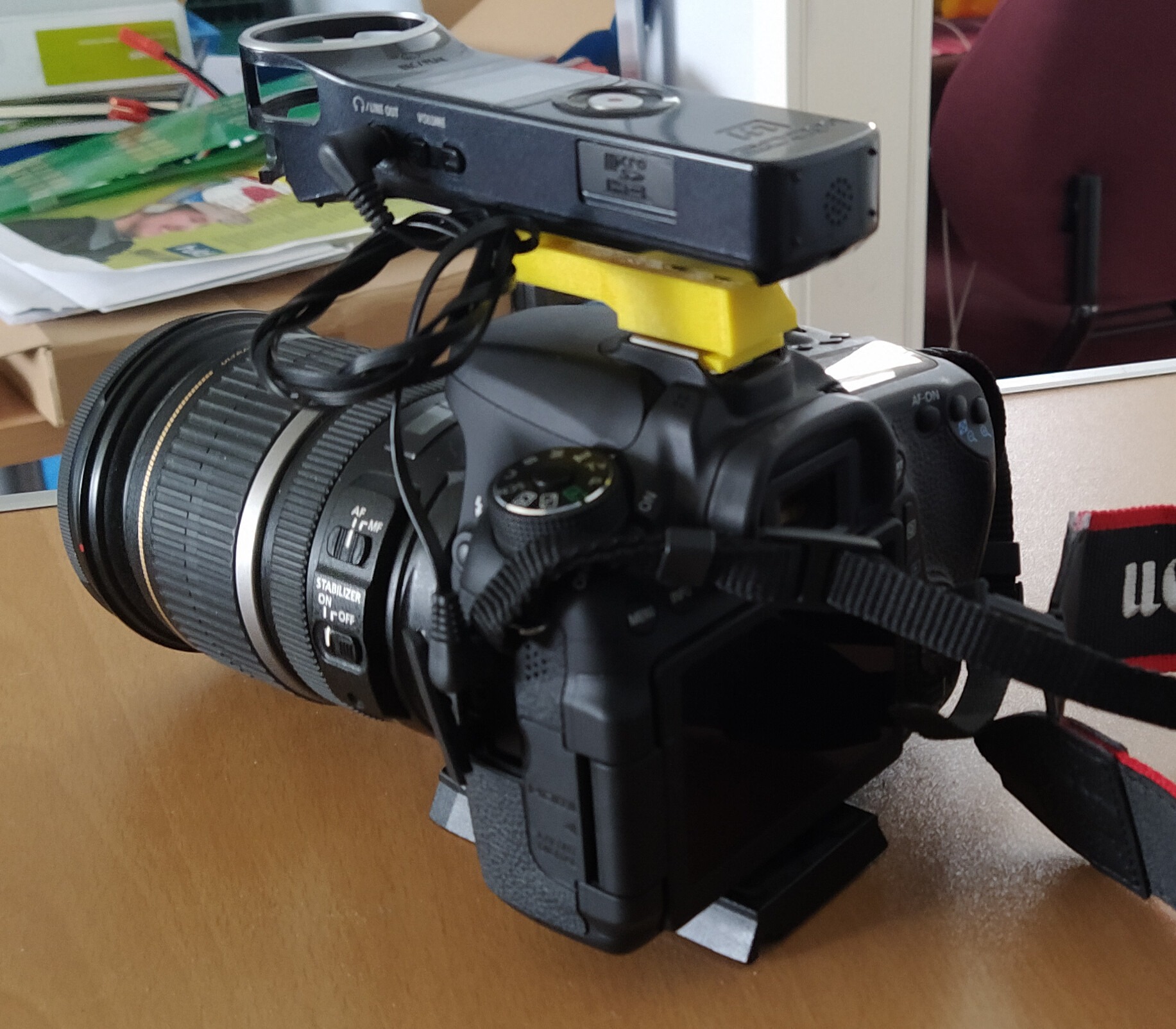

Got the external mic holder prototyped this morning. Will start shooting today.
