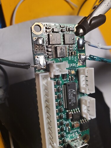

EDIT: Top tip of the day, don’t short circuit your B+ and B- pads when the battery is connected. Below image is from a user and we’re seeing if the unit is salvageable.
Just want to say thanks Simos for the help with trying to salvage this unit! And yeah I would definitely recommend avoiding this stupid careless mistake haha.

That’s rather odd,. mine seems to have survived a short at the charge pads! It evaporated the connecter which I believe acted as a fuse

Yeah I think you’re right the connector acted as a fuse and the board was salvageable. The slight sparking when trying to reconnect was unsettling at first (video below if anyone has seen the same thing when hooking up +BAT / -BAT), but I believe I successfully restored it with some help from @SimosMCmuffin. I was able to solder on a small jumper where a trace was blown and separate/hold everything in place with some super glue and silicone. After connecting the battery, there appeared to be no issues after the initial sparking. Current draw was normal. I checked via USB after hooking up the balance wires and readings all look normal. No faults reporting and my status readout is as follows:
State:3522:3523:3522:3522:3523:3523:3522:3522:3514:3522:3519:3520:42188-42208-42208:0-0-0:0-0-0:299:306:0:notCharging:
And here’s a pic of the fixed unit:
