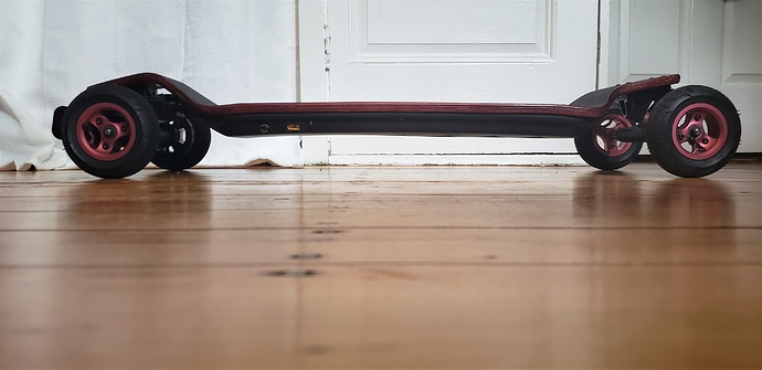

Been putting this off too long and finally told myself I had to just do it now. Also pushed along a bit faster after my first few rides started to scuff it up a bit! :stuck_out_tongue_winking_eye:
Anyways, here she is completed! I definitely had some inspiration from a few builds on this forum already.

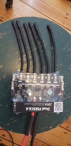

I soldered up and wrapped the bullets and an XT90 to the ESC. (The TS100 and how to solder threads were a huge help here as a newbie)

I still have to mess around more with the VESC settings and what not, and install a Metr Pro that is on order. I also have some shredlights SL100’s - but not sure how to mount them to this deck with this nose angle without blinding folks - so taking any ideas on lighting as well.
Please feel free to critique and offer any insight! It was an absolute blast building this board, even more fun zipping around the neighborhood! I am very impressed with how smooth, stable and torquey she is!

Glad to hear it! Was such a bummer when the Neobox scam blew up on me. I haven’t really done anything to the flipsky aside from the setup wizards - so if you have any unsolicited advice on other settings i should be looking at I am all ears.
That thing boasts some crazy current values, for flipksy i apply the general rule or running them at no more then half their rated specs. so if you keep to around 100 batt amps you should be good. it will definitely sustain burst of more, but dont push it too hard. the 12s4p 40t pack is perfect , at 100 amps it should stay fairly cool and 100amps is going to give you a lot of ooomph. Only other issue i had with that big fsesc, is when running motor detection, if you had anything plugged into the uart ports it would not detect. That may have been fixed tho, my flipskys were from over a year ago.

Alright thanks for the input, I also had issues with the uart connected so good to know I am not alone there… I’m not even sure where I landed after the wizard tbh - gotta get back in there to check
