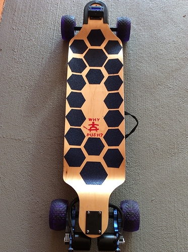

First build! | New to esk8 | Parts check

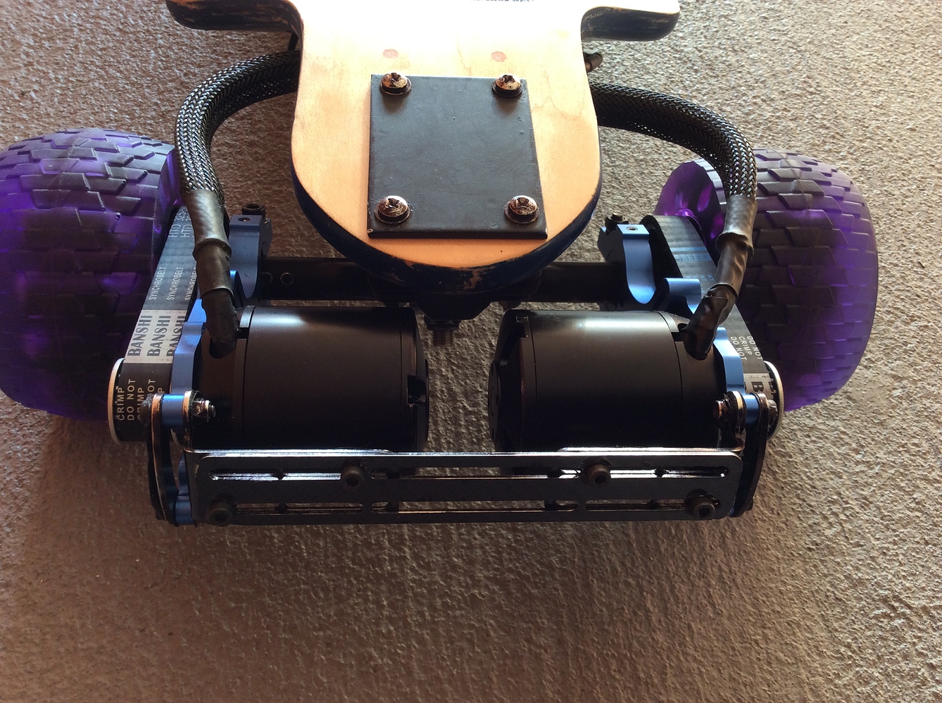

2-Flipsky vesc, 10s4p battery, dickiho motor mounts, yocaher deck, 2- 6374 motors, 14, 36 (15mm) pulleys and Slick Revolution 120mm Foamies wheels with Zealous bearings almost forgot, Torque Boards 218mm trucks.
Dude love the grip tape design you did. Very clean setup. Did you make your battery? What about your enclosure?
I bought this enclosure from amazon and the battery i got from a friend. my other boards including the one i built for my son have 10s3p batteries i bought from (http://www.skateboltsd.com/) .

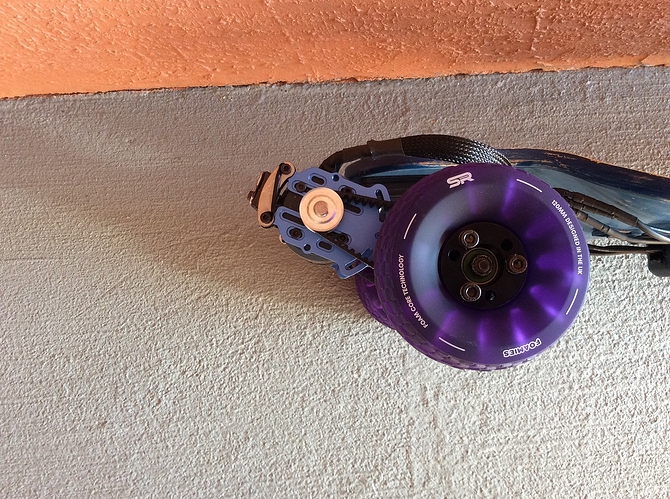

Question for all - Parts are trickling in and I started to assemble the wheels and pulleys. I noticed that when completely tightened, the wheel pulley is not perfectly aligned. In fact, some of the screws are deeper that others. I screwed them in following a star pattern. This is happening on both wheels. Is this normal?
Send some photos if you can. Could be over or under tightened.
I figured it out. Needed some finesse. Didn’t realize how careful I had to be. And precise.

@BillGordon - I know it’s been a while but I finally have all the parts. Connected everything up today and followed instructions for Ackmaniac tool. For some reason I can only get 1 motor to spin after completing all the steps. Yes, CAN BUS is connected. Motors spin fine individually but can’t get both to spin at the same time.
Identical lights on both vescs?
