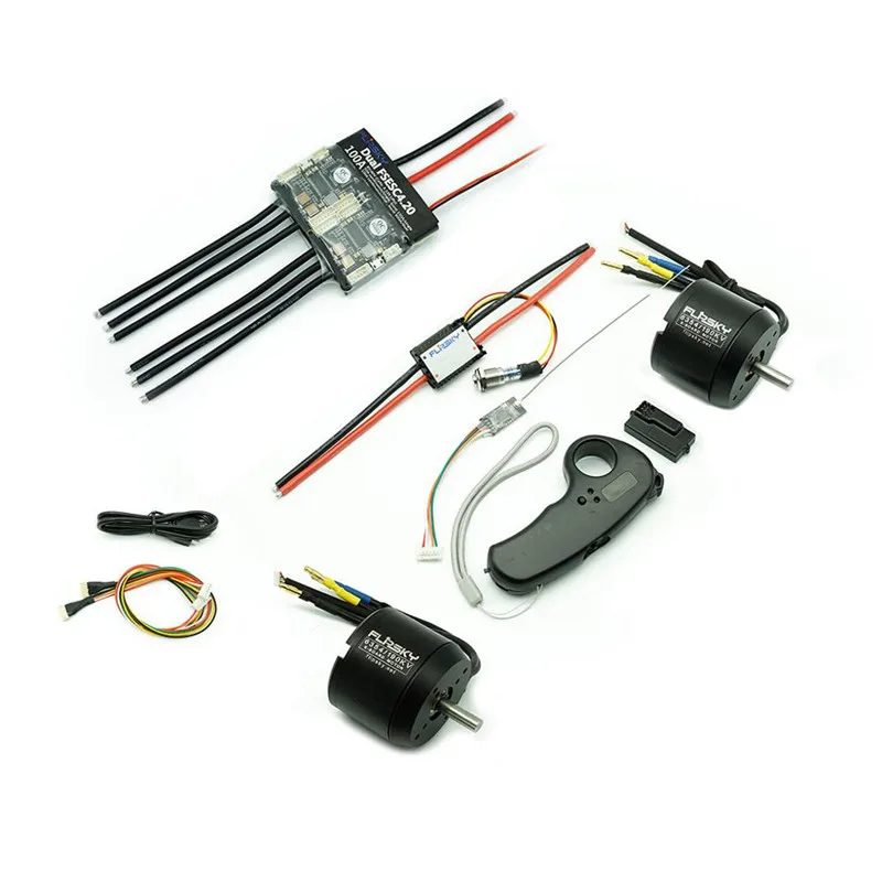

Is this worth it? Motors are not 6374, they are 6354 in this kit. Remote is included, probably not the greatest.
Note: they both mention “two style of motors, will send randomly”. I have no idea what they mean by this…
I went to ebay to see how much it would cost if I bought the components separately with 6374 motors and the total was about the same as this (I did not include the remote on ebay, so this would be even more).
I have one of those remotes. Nothing fancy, but it works well. Both kits are pretty decent, but I have one concern:
Both the double and single 4.20 Flipsky variants had a big flaw with the resistors originally, which has been fixed in the latest versions. So I would ask the seller if these are the upgraded version of the vescs before buying either set.
@gamer43 and @Schtekarsten helped to identify the flaw and advise Flipsky on the fix, and may know something I don’t in terms of identifyng the versions shown.
Gotcha! Maybe I will just go with the second option that I listed since the dual singles are 4.12 and not the 4.2.
My other thought on these kits is that - yea they are not the 6374s that I wanted, but I could at least start with this and sell later if I decide I want more juice.
Yup. Thought they were 4.20 singles. 4.12 are solid. You can also get a great performing cheap remote in that Mini off of Ali.
Solid. I’ll probably go with this set.

Remote and receiver $$$ cheap,
The ones I bought a while back are the fixed versions. I think they are all the fixed versions now. If the old forum dies though, we will lose a record of this change.
I’d have a lot of worries about buying a flipsky kit, but getting the old resistor layout wouldn’t be one of them :smiley:
Why you gotta do this to me man :joy:
Care to expand on the worries you have with the kit? I know it comes with the antispark, which I know you’re not a proponent for.
Flipsky’s primary design goal is “low price” which means you get cheap stuff.
I prefer stuff whose primary design goal is “high quality”.
Because any skate that works is better than any skate that doesn’t work, no matter how “good” the broken one is.
Fair enough. I appreciate your persistence in pushing the “buy nice or by twice” motto
The one for $325 is good, i can’t speak for the 4.20 esc, i got scared when they were having issues so i went with the 4.12 ones.
