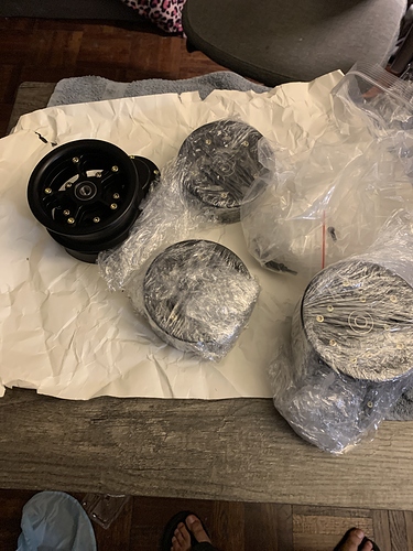

Need to get all the different versions of your gear drives. Workin towards it slowly but surely.
image image
