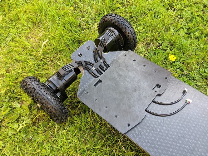

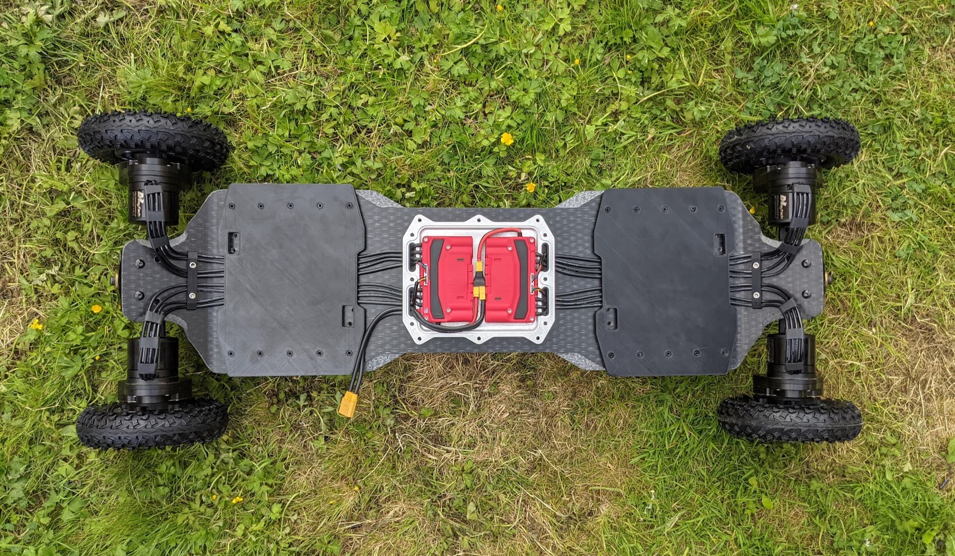

Footpad finished printing
Looks like it fits well too
Hopefully cables go in like this

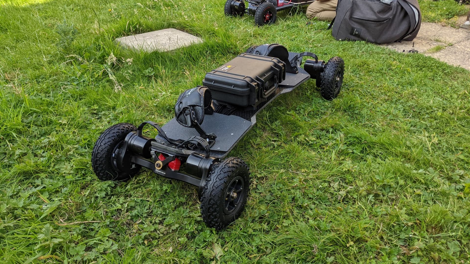

Also started thinking about Battery case orientation.

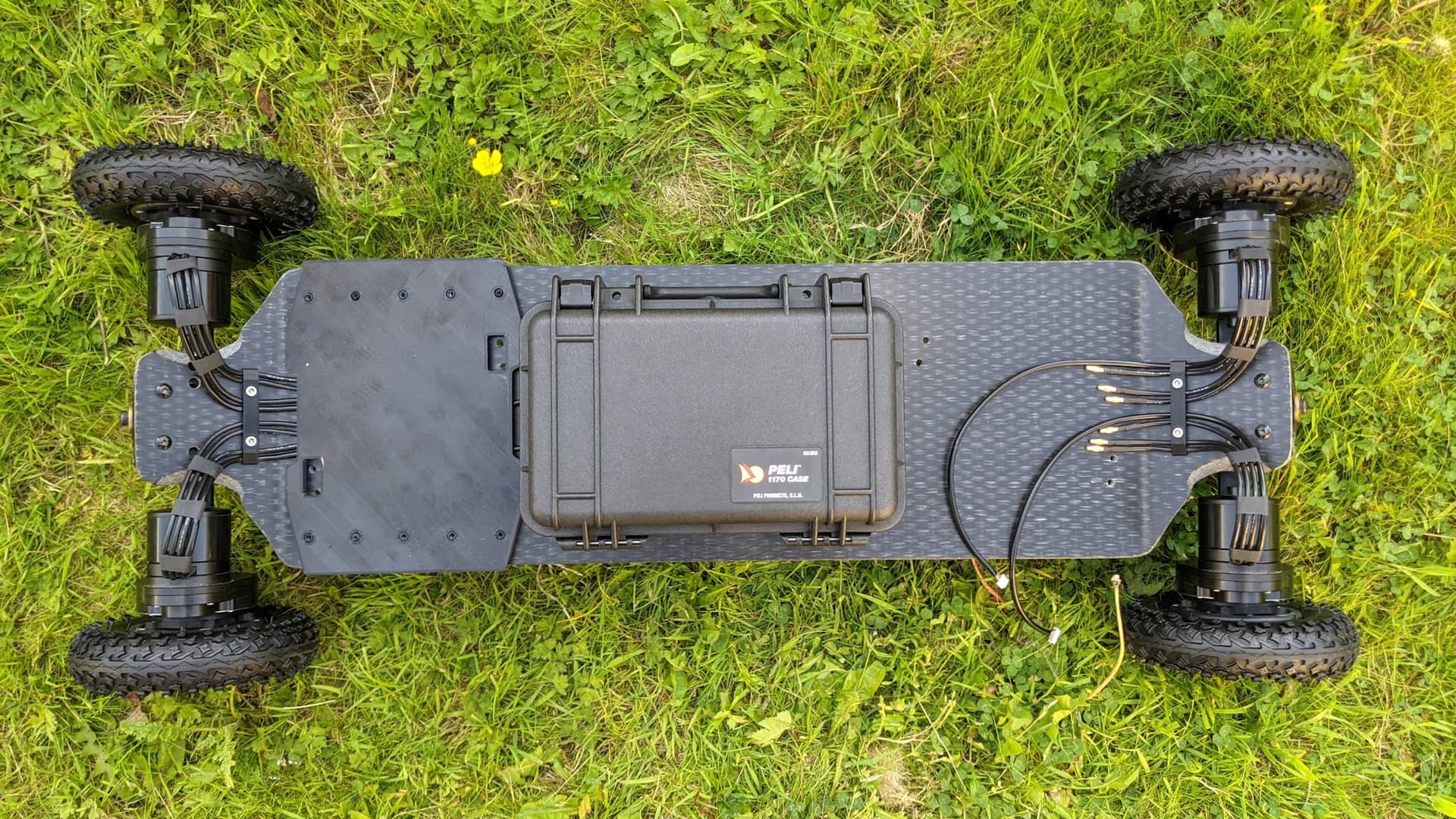

Had this Peli 1170 kicking around so i thought id try it on there
Most builds have the case mounted long ways.
but you catualy get much more ankle space mounting sideways
Longways . . . or sideways . . . looks . . . or practicality . . .
I just dont know.

How many batteries can you fit in the Peli 1170?

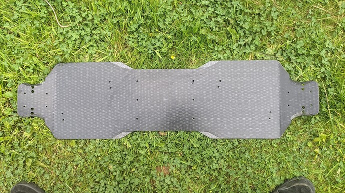

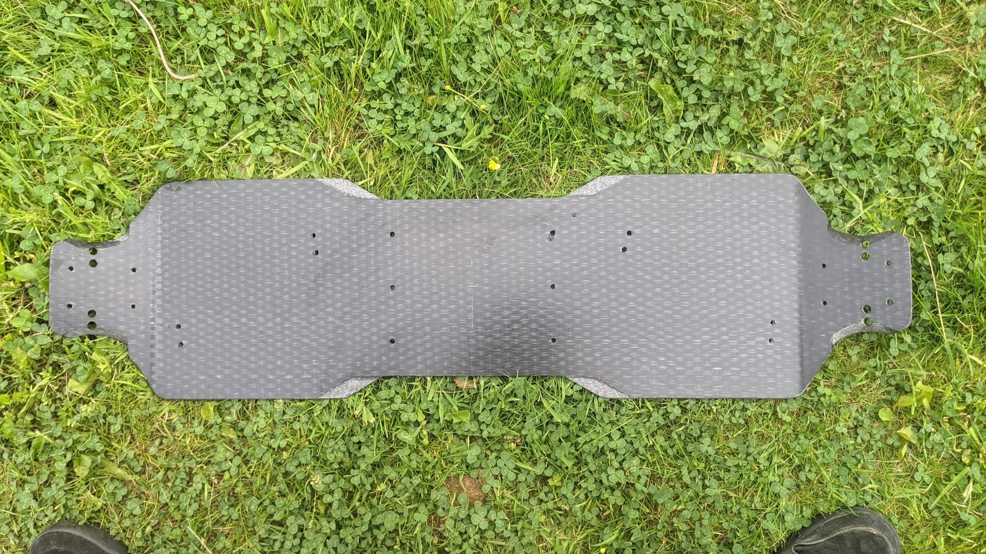

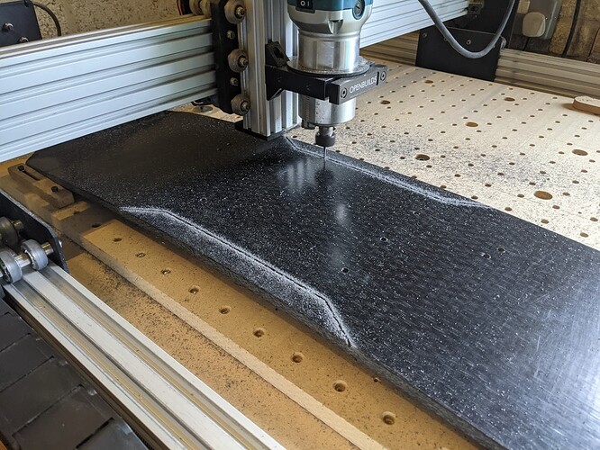

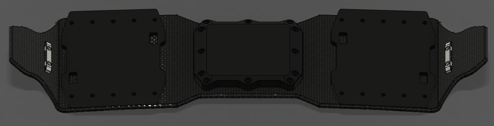

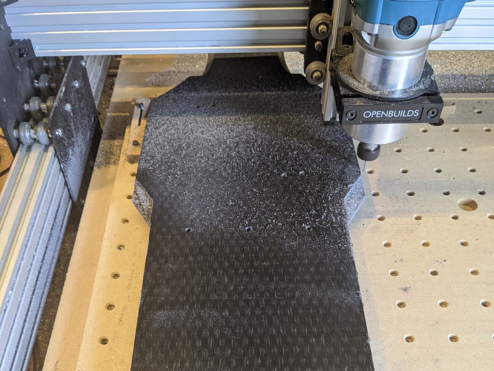

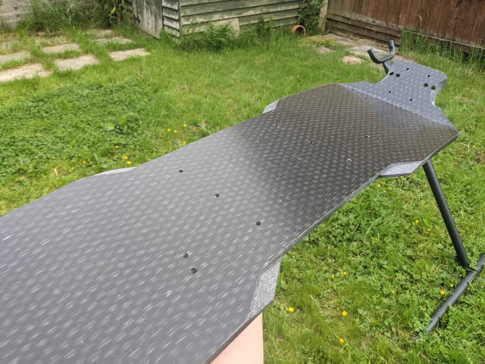

So till this point i had always been thinking about cutting the deck in to match the ESC case in the center.
But to do this cut along the curved surface on my CNC i would need a very accurate model of the deck curvature so i set about re-drawing it as i intended to cut it. Whilst working out the correct geometry i had a crazy idea / stroke of genius.
Like the cuts on the deck tips, there was no reason these needed to be a flat shape :astonished:
Came up with these little cut in shapes that make things a little more interesting.
So first the excess chunks got cut off.
Then the sloped sections get profiled in.
Finally a light hand sand to clean up any edges.
Deck looks way better than i could have hoped. There is probably a lot of scope for this kind of 3d cut to be further explored.
Now the deck contours match those found on the ESC case and its all starting to look a lot more coherent.

Sideways gets my vote. I think it looks better too honestly.

In theory, 12s6p. i’ve seen it done.
In reality is a really tight fit and needs careful planning to make it work.

12s6p of 21700?

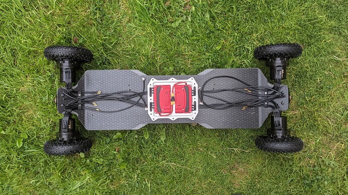

16 June 2021
Other footpad has finished printing after some printer issues (fuck 3d printers)
Time to trim all phase wires to length. get bullets on them. get them connected and heat shrunk.
Oh yes.
Still not sure on battery case orientation.
But im slowly coming round to @Venom121212’s way of thinking

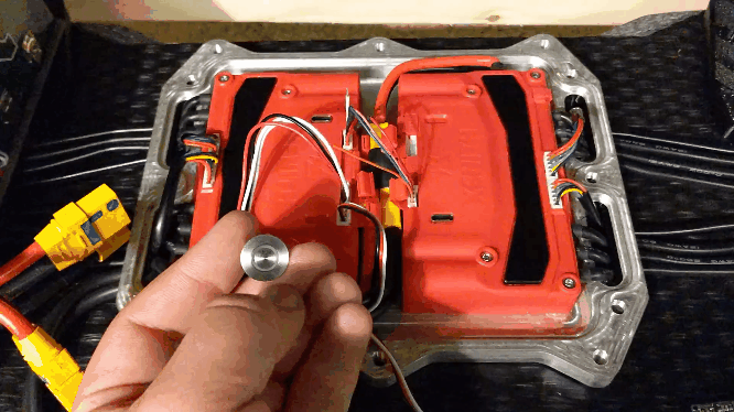

First signs of life

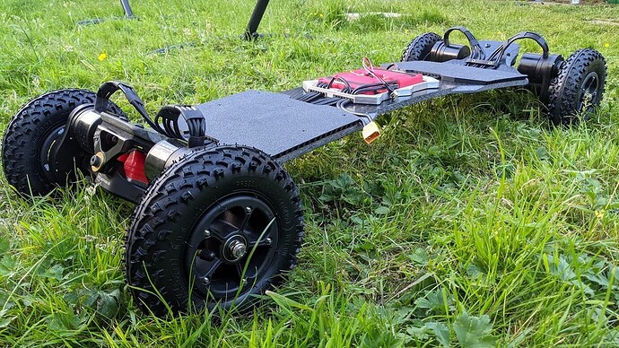

Grip arrived
This looks infinitely better imo

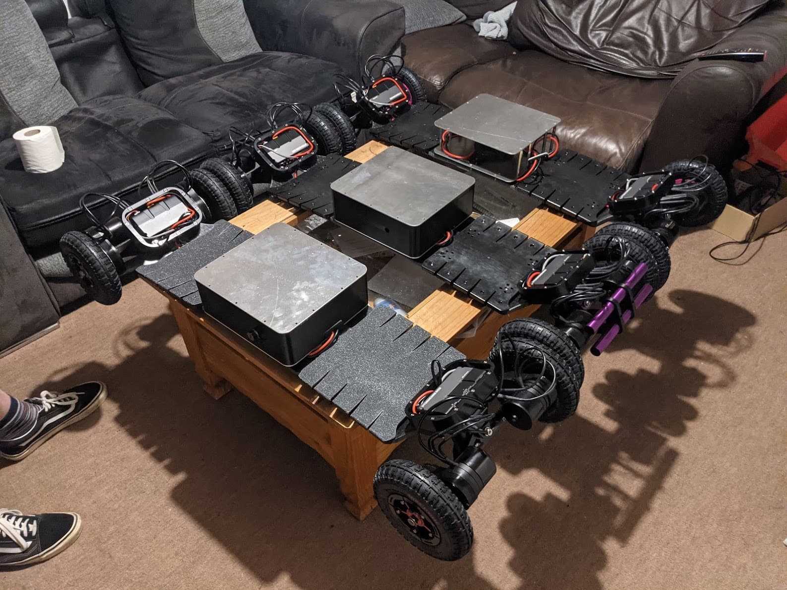

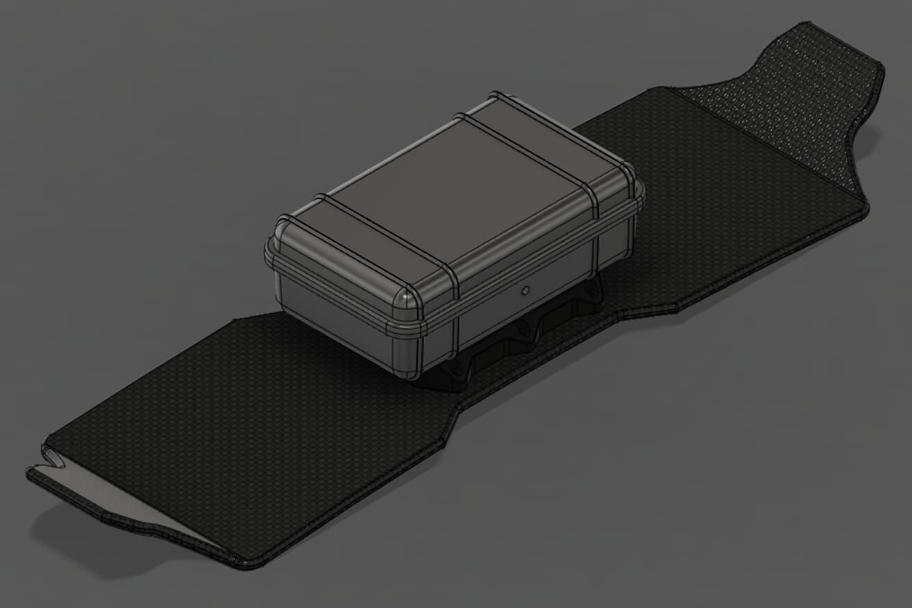

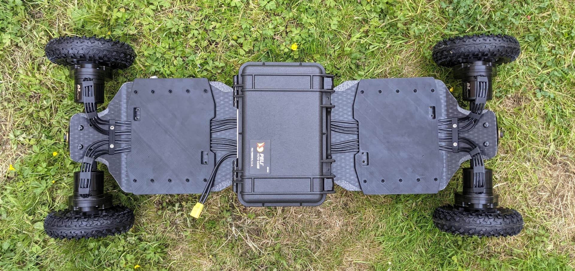

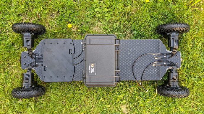

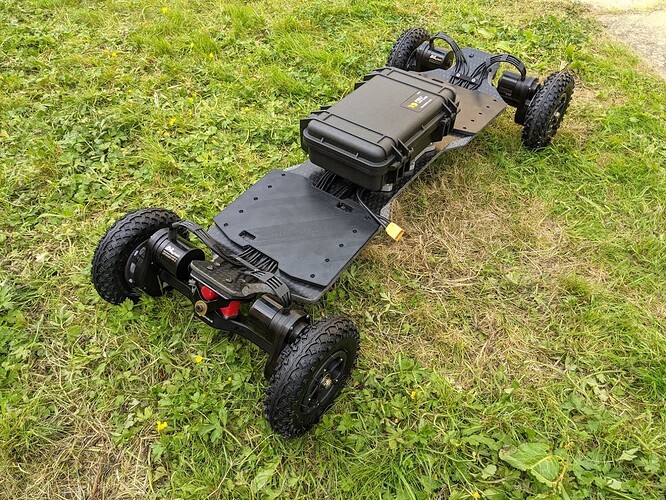

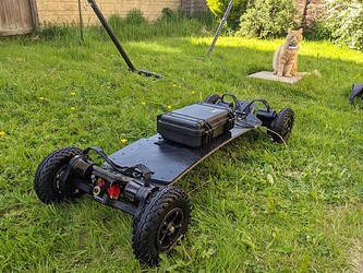

Coming back round to the idea of having the case inline with the deck.

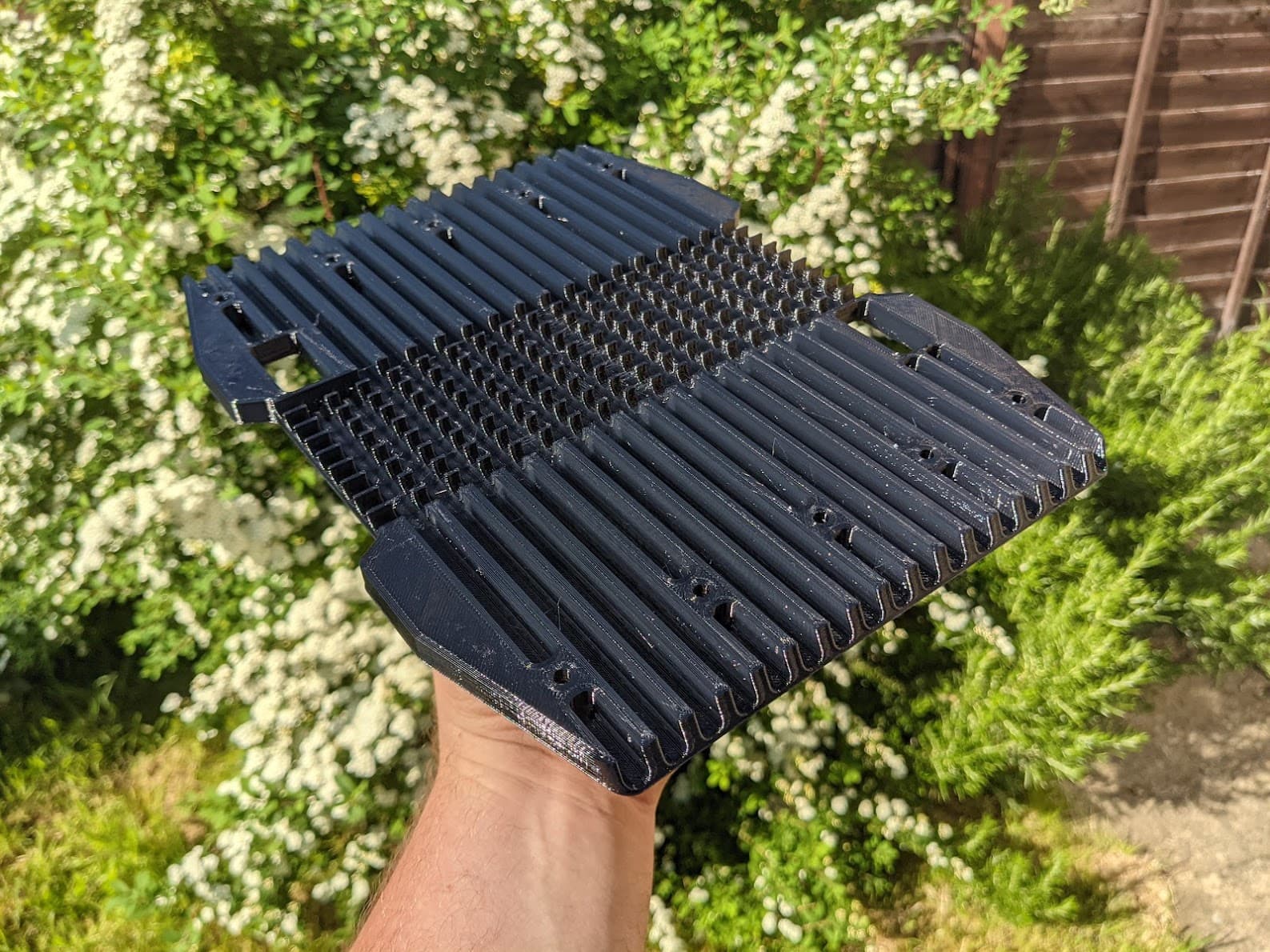

Got the case modeled and then modified the ESC case cover to Have locating features for the pelicase.
Printed this and fitted it to the deck along with the MBS F5 Bindings
Put the pelicase back on to see how it fit.
yeah thinking that’s the winner.
looks very sleek and fits nicely between the bindings.

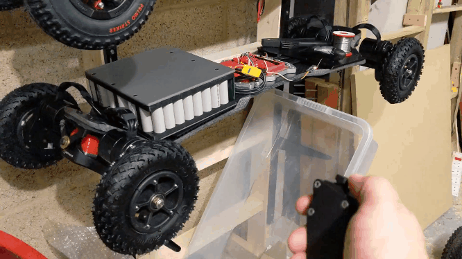

Then for fun i started trying other batteries i had in the garage.
The 2kWh lonestar pack is ridiculous. Might do for a test ride but not ideal.
Then i stumbled on some cell holders for another project.
This cant be unseen.
6x6 fits so nice on top.
A 12s3p P42A pack could be the perfect size pack racing.
