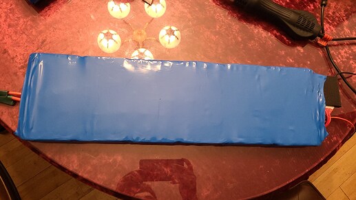

The completed pack looked just fine actually. Here’s what it looked like after I shrank it.
Unfortunately, the joy of a complete pack was short-lived.
I eventually realized how stupid it was of me to build a pack with no redundant series connections, sketchy solder joints, and a weird-ass form factor. I ended up dissasembling the pack completely. As of today (Feb 26 2022) those p groups are sitting on my shelf waiting to be further disassembled.
