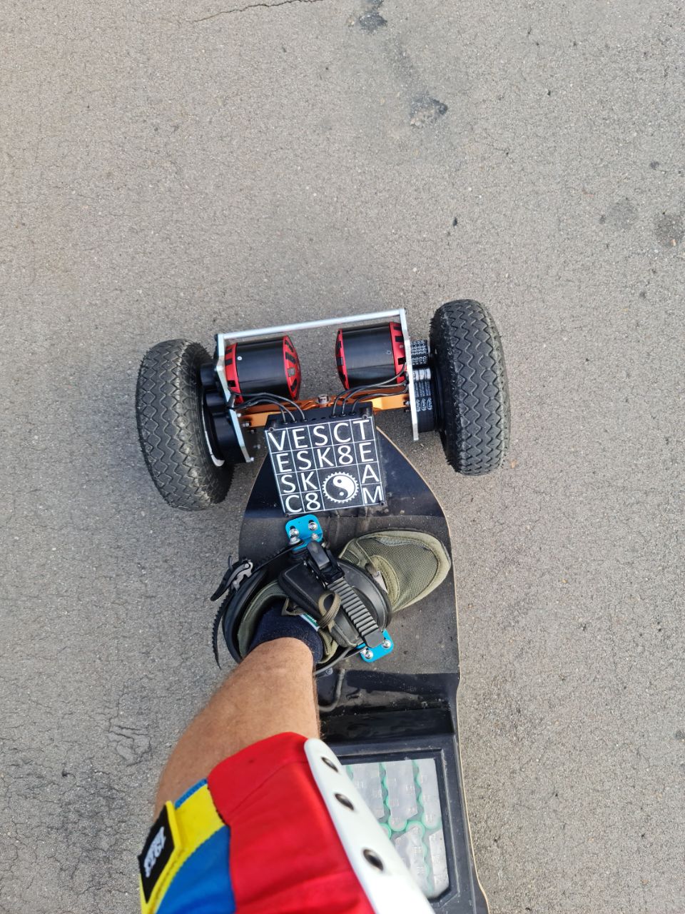

I’m building an esk8 with a friend who’s really skilled in mechanics and electronics. I want it to be very powerful, and the configuration I’ve chosen is 4WD with 6395 motors at 205 KV, all running on a 20s8p setup. I know it’s extremely powerful, but I’m the kind of person who loves having powerful vehicles, even if I end up riding calmly.
Has anyone built a similar setup? Do you think the belts will hold up, or would it be better to switch to chains or gears? I plan to use 25mm wide belts for each motor. I’ll be using Spintend controllers (85V, 250A).
Do you have any suggestions?

Sounds a lot like my raceboard build, which I recently swapped to 4x 6484 205kv.

I think 20S 205KV might be a bit too much. I am running 21S 175KV at 200A acceleration in the rear and 200A braking in the front per motor. And below 100A each in the front for acceleration and in the rear for braking. No heating issues with that. But, with this much torque you gotta gear for high speeds, otherwise the motors spinning so fast will generate a lot of heat during prolonged high speed runs and then you’d have heating issues.
That said, my board is a raceboard and is pretty much never used off track. For prolonged high speed use it might have heating issues.
