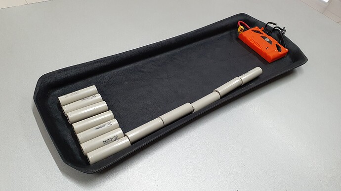

This is the latest enclosure I’ve designed, it’s a pretty nice upgrade for all Evolve Bamboo GT owner that, by this time, might have bad battery packs with loads of SAG, burnt BMSs wqhich you can’t get anywhere and need a remote upgrade because the Evolve one is not smooth enough.
The enclosure is perfect for a 12s4p battery made of Samsung 21700 30T cells, my favorite cells today:
Or you could also go 12s5p with 18650 cells and a full size BMS

Are you able to stick more cells in if you stack them on the height like shown in the pics, rather than doing it on the width like most people seem to do?
Also, how does this enclosure hold up considering the flex of the evolve boards?
What do you mean? The enclosure is only single stack only on double stack you can do that.
The enclosure is made with flexible resine so it’s flexible enough for the bamboo deck
Really like this idea. Now I’m torn between getting a sidekick or a shadow. All I know is, I need a kick tail in my life!
In the pictures you stacked the batteries like this:
Does that make it possible to fit more batteries in the enclosure rather than doing it like this:
Since he can fit 10 18mm wide batteries across. That means you have 180mm wide of space. If you were to run the batteries perpendicular it would not utilize the space as effectively because even if using 20700 cells it would be leaving 40mm of usable space. The short answer is yes, the way he stacks the batteries best utilizes the space in the enclosure.
You could, but you will waste a lot of space and will only fit a 12s4p or 10s4p, instead of a 13s5p
I see, thank you for explaining!
