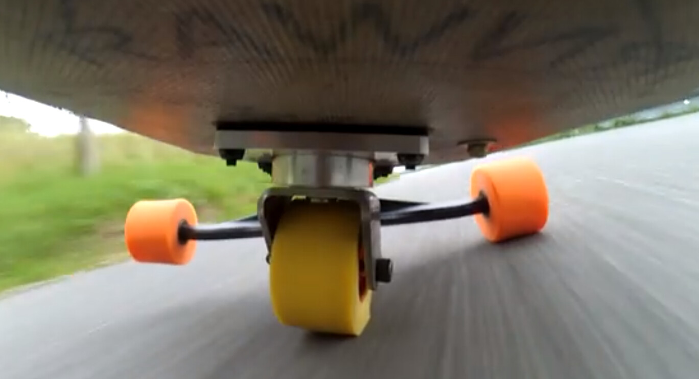

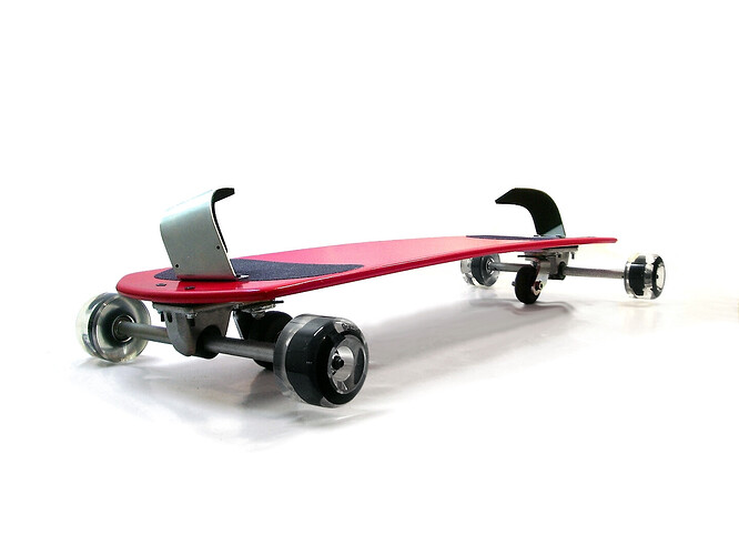

I have some special ideas for a center powered caster for a hovercraft board, 4 wheels on a rocker suspension, with battery and all built into the massive space available.
Not sure how I missed that 5th wheel before, guess from the videos pushing in a skatepark that it was not motor propelled.

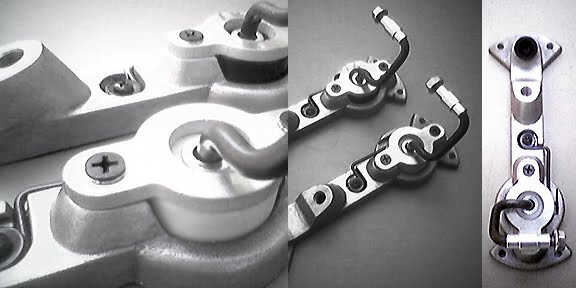

not sure I posted these pics here
what a funky caster design.

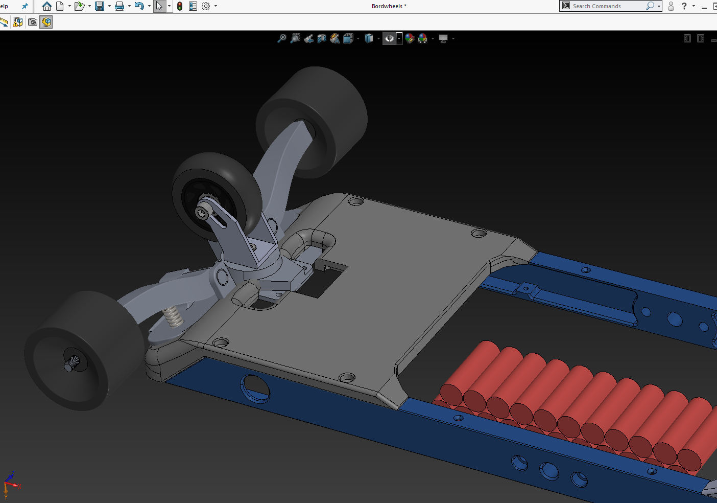

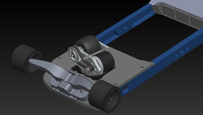

I just had a dumb idea, you could design a powered caster with wires coming up into a special universal joint hidden in the board. Then you have a hall sensor on your caster’s rotation and also a motor on your battery/ESC assembly. So any movement by the caster is matched by the motor rotating the battery/ESC assembly to match so the wires stay straight. Would need two independent ones for each caster.

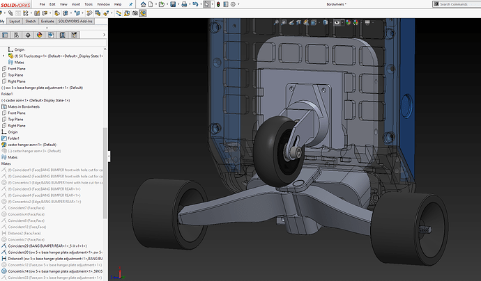

I put the V2, SBX bearing block and the new school and old school baseplate hole patterns all on there. Because I can.
To make that part work in a SBX you would need to either cut the outside to some special shape I don’t have the dimensions for yet to fit the stock plastic housing, or print a housing with this square shape. You would be able to put it on a V1/2 and Freebord deck without mods tho.

push fit caster mounting with o ring, no cutting of the bearing only friction there.
He agreed that a design with a ball locking pin would be ideal although far more complex.

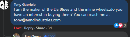

@hummieee how would you rate buying your wheels from Aend Industries?
Insanely slow and more. But if they have them already poured maybe not a problem.
