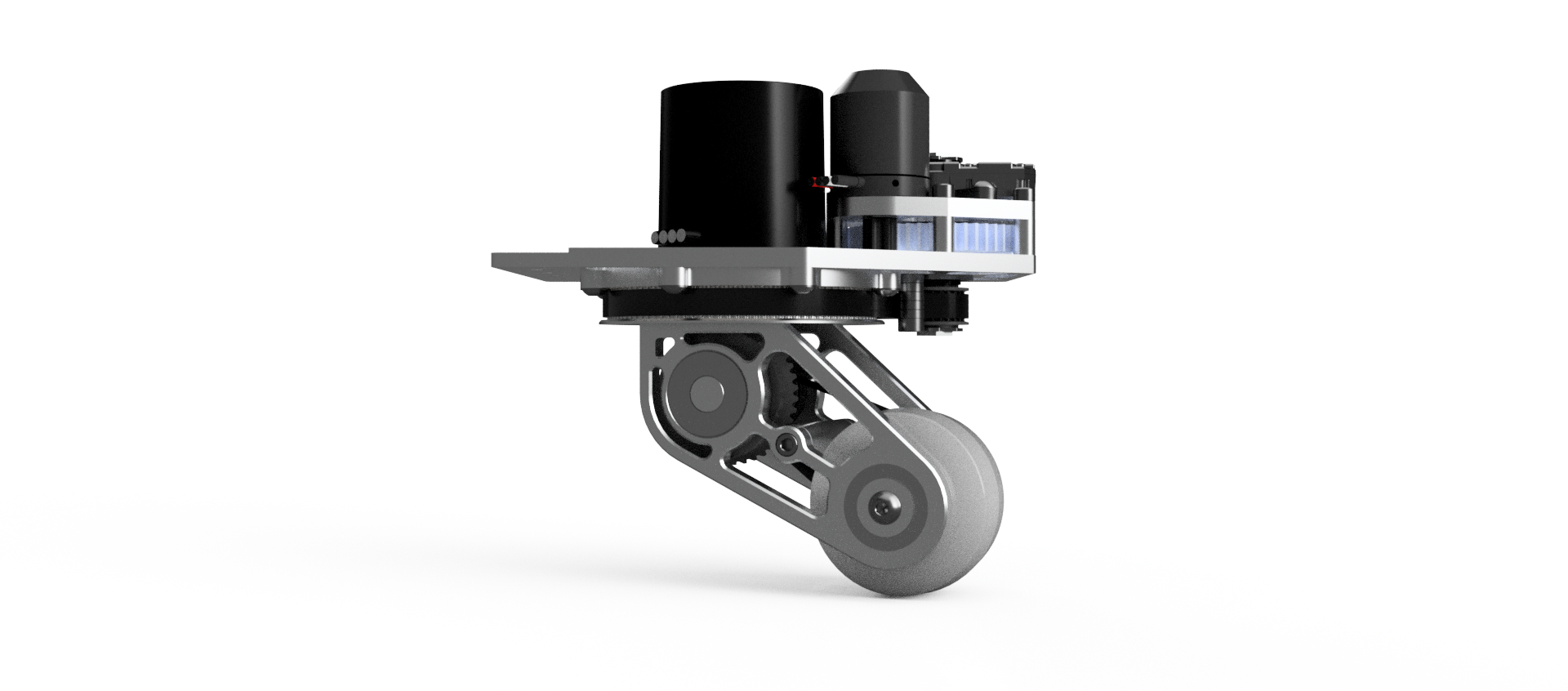

This design I have come up with is similar to something used in FRC robots called a “Swerve Drive” this would be a “Caster Swerve” due to the wheel offset from the rotational axis
I present: The E-Caster
older models:
Mechanics: Most of these parts are from Dickyho!
The whole design is built around a cheap 200mm lazy susan bearing. It isn’t very strong but I think it might be just good enough, and avoids either something really expensive or manufacturing my own. Hey if it’s able to support a whole table it could probably survive the weight put on it from some springs.
I’m still deciding what kind of motor set up I want to use. Having two motors obviously drives up cost significantly, requiring more ESCs belts pulleys and crap. It would allow me to use smaller diameter motors to achieve a lower profile and hopefully fit below the Freebord 5 and well as the 5-X as they have slightly different ride heights. The construction on the drive is very simple, using a 8mm shaft and a kegel wheel. Two bolts on kegel pulleys, one drilled out so the bolts slide through and into the other pulley. This could also easily be done with press fit pulleys, I’m not sure if you can put one in either side of a wheel but the pins could be shortened if not.
For the suspension aspect I need to put springs on it somewhere, for the moment I am thinking torsion springs because that would fit cleanly into the design but compression springs could be used instead and would match the look of the springs on the 5-X hanger arms.
I also really like this design:
single motor design with double sided motor axles inside the suspension arms as it looks sick but it has a couple issues as well, one being that the optimal choice of the APS 80100 50KV costs more than two of the small motors. It would require the belt drives to be outside the suspension arms, and also use a live axle with bearing press fit into the suspension arms (hard to manufacture and flanged bearings are expensive) instead of the dead axle. It could be possible to have a spacer that allows the motor to be center mounted and have the belt drives on the inside but it would be weak to 3D print and expensive to machine out of aluminum. Lastly it has the issue that if a rock or something gets kicked up it could jam between the motor and wheel. Still possible to pursue this design avenue, it looks much more clean and the motor would be protected. For now I’m going with the dual motors because it’s a balanced design and a great use for the Cheap Focer’s that I’m hoping to be having quite a few of.

It’s pretty darn simple due to not needing a slip ring, basically just esk8 electronics packed into a round shape. One thing I was thinking is that you have a reasonable but not too large battery like a 12S2P 21700, then stacked on top of that a swappable high capacity charge and ride module. Then riding could go on quite long! I think the battery consumption while sliding around would be quite extreme, even with a 350Wh pack I could see it going empty in like 5-7 miles. So the charge and ride packs would be fairly necessary, therefore making them easy to swap would be important. Given the footprint of the battery, 3D printing a battery + VESC enclosure would definity be possible so that is a plus for sure.

What I’m interested in from you all in input on the general idea, good and bad. I’m hoping some of the great ESK8 parts manufacturers we have on here could help me find COTS parts that would make it more robust and still cheap and easy to make without a real shop.
