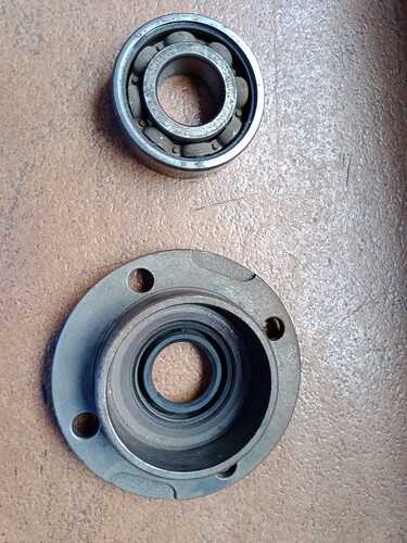

I’m trying to make one of these cool boards I’ve had my eye on it for a while and have all the stuff I need except for the wheel in in the middle. I need to know if it is just a regular caster wheel or a specific 360 mechanizm like a lazy susan. so I just need to know where you got the caster from or if you guys made it in which case what would be the best caster for me to get.
Thank you
I went with what I had, and what I could make.
The wheel is a cheap china skateboard hub wheel, I then printed a pu sleave that fits over it to give it a bit of shape and traction, I only done this because the cheap wheel really was wearing down badly.
The caster fork I drew up in sketchup and printed it out.
the bearing flange is from a Diesel pump end plate :rofl:
My electrics are all mounted very badly around the wheel and held in with a velcro strap.
Please consider, this was my first board and a real proto, so very ugly and crude :scream:
But it works and it is still going.and if somthing brakes …I just make a new one without having to spend big money.
But I would go with what the guys are doing here on this forum, those are proper designs that will definatly work.

I almost forgot my steam punk caster damper :rofl: :rofl: :rofl: :rofl:
Again modified a worn out Yanmar diesel pump, it just helps me go in a strait line. :joy: :joy: :joy:
