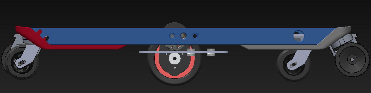

yeah so cheap Freebored center wheel modules
ignore the funky setup on the end, imagine that more like a normal 5-X.

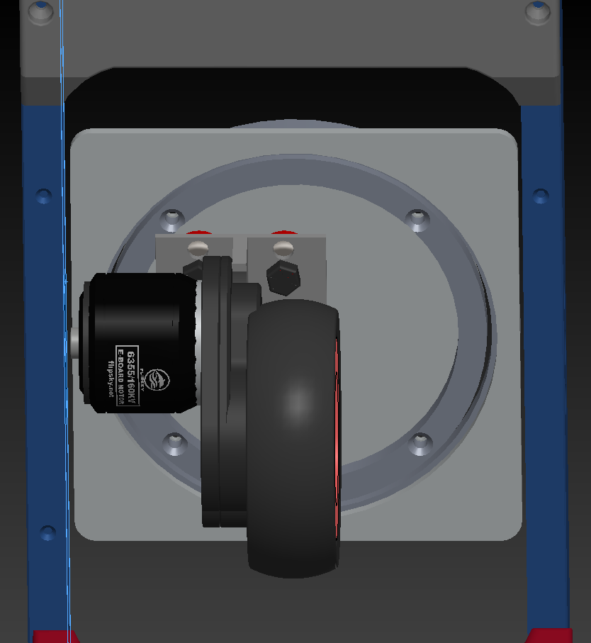

fitting bearings for a diy ring bearing with the motor sticking out that side of the gearbox is a pain but if the motor is flipped you need a huge motor gear to fit a wheel larger than the M1 gearbox wheel bearing.
speaking of that exact issue Freebord boro 72mm sized wheels would not work with a M1 gearbox, but the model you see could fit a 100mm+ sized wheel to remedy the ground clearance somewhat.
As stated above a small gearbox meant for 50xx motors would be ideal.

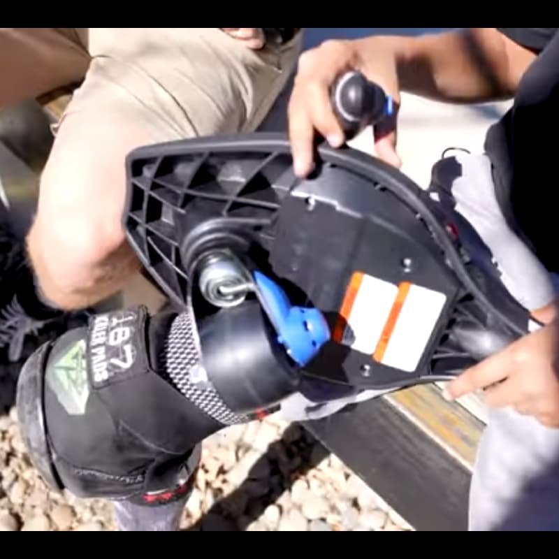

Somebody asked if a Razor Electric Ripstik board could not be used to make an E freebord, not sure why, but I can’t see that post anymore.
I had a look at the new video for the Razor Rush/Deux Ripstik …is there any reason why the electric caster wheel on that board will not work on a E-Freeboard?
if you combined it with the idea I had for putting gears or a rotation sensor and linking that to a cylindrical battery and esc module in the center of the board, making some sort of overcomplicated slip ring delete.
yes

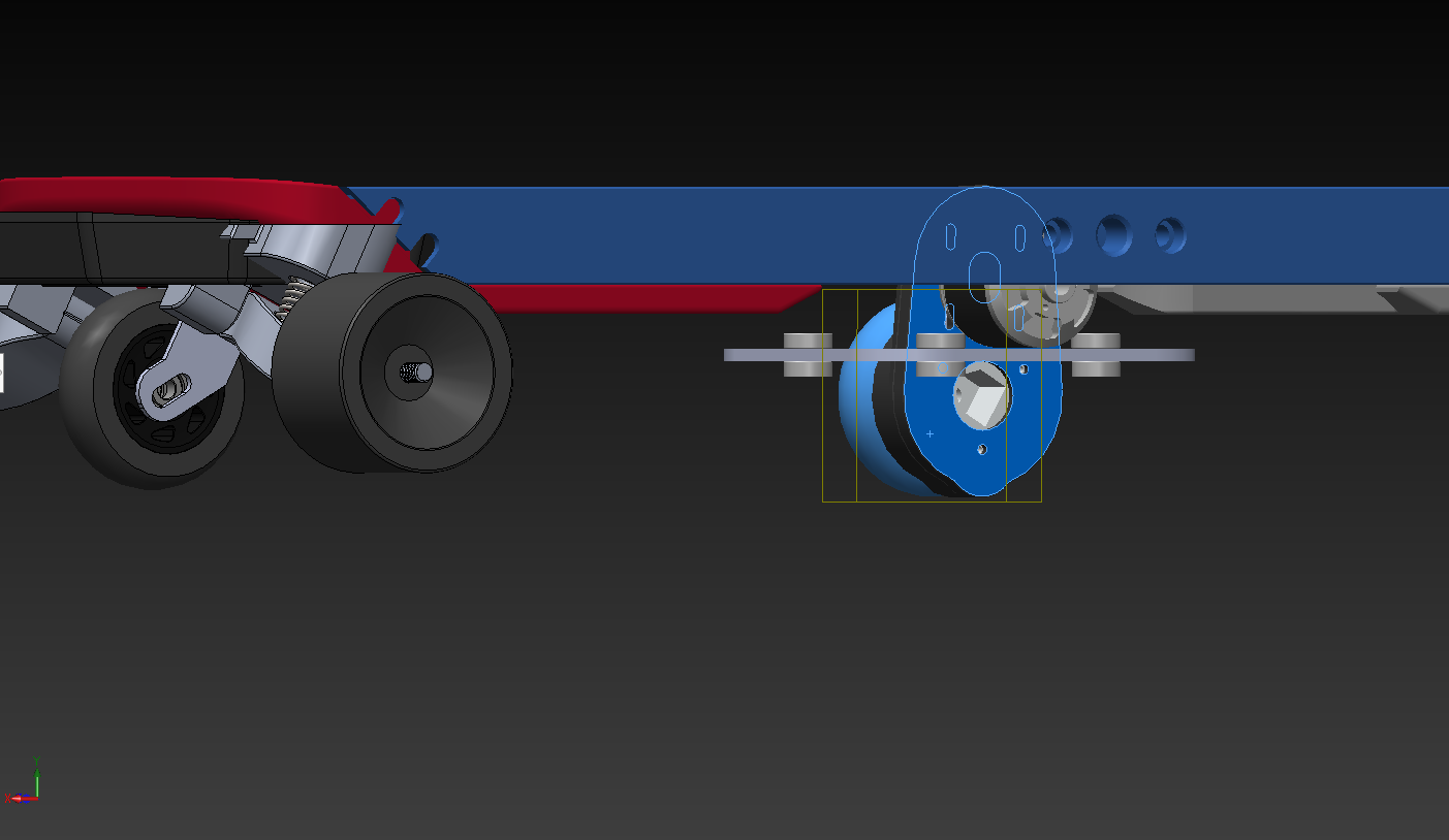

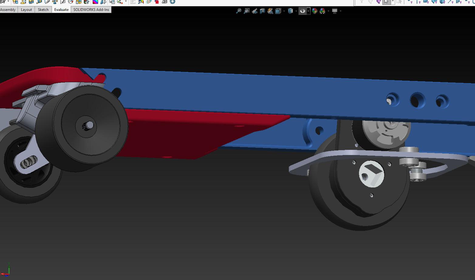

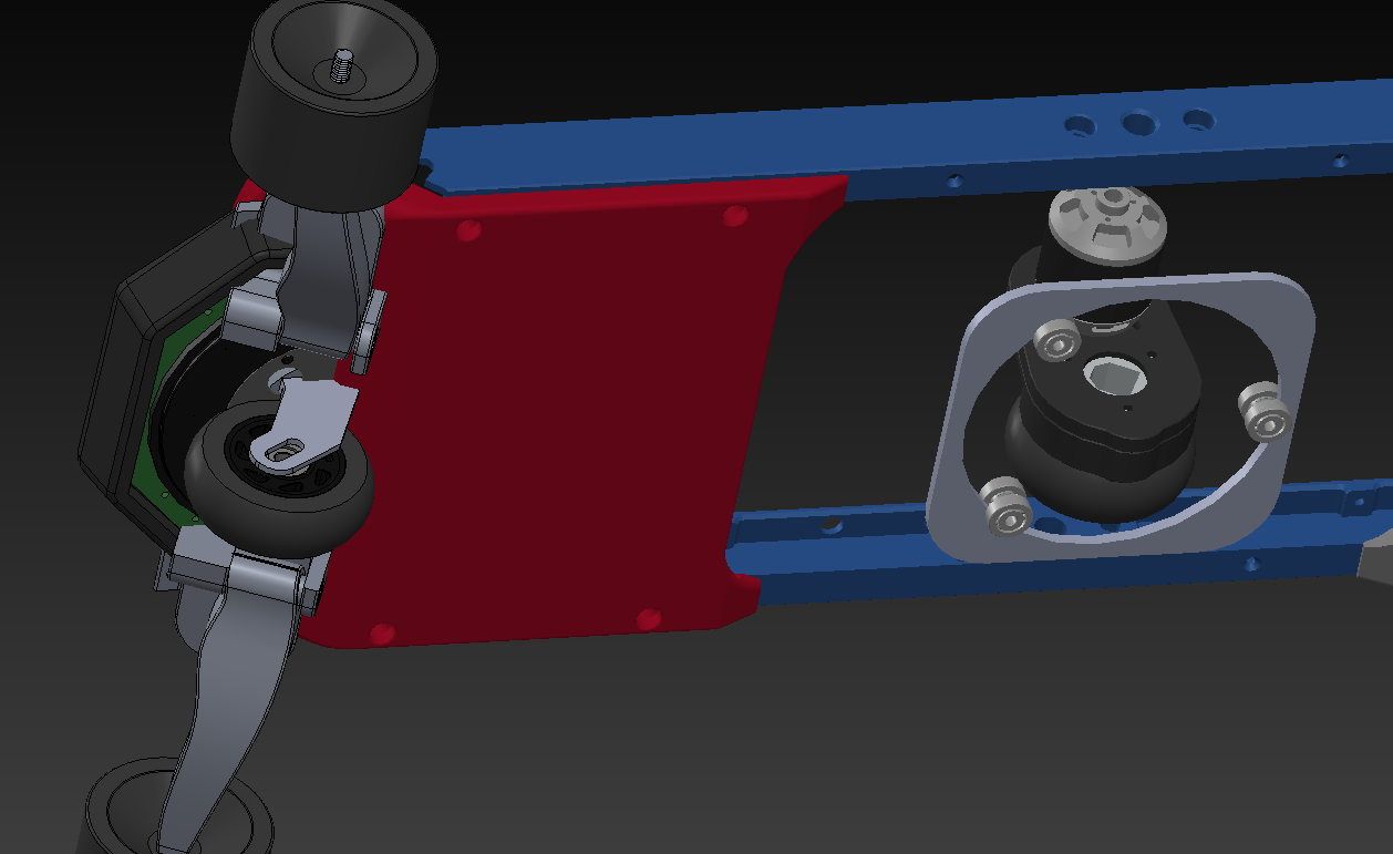

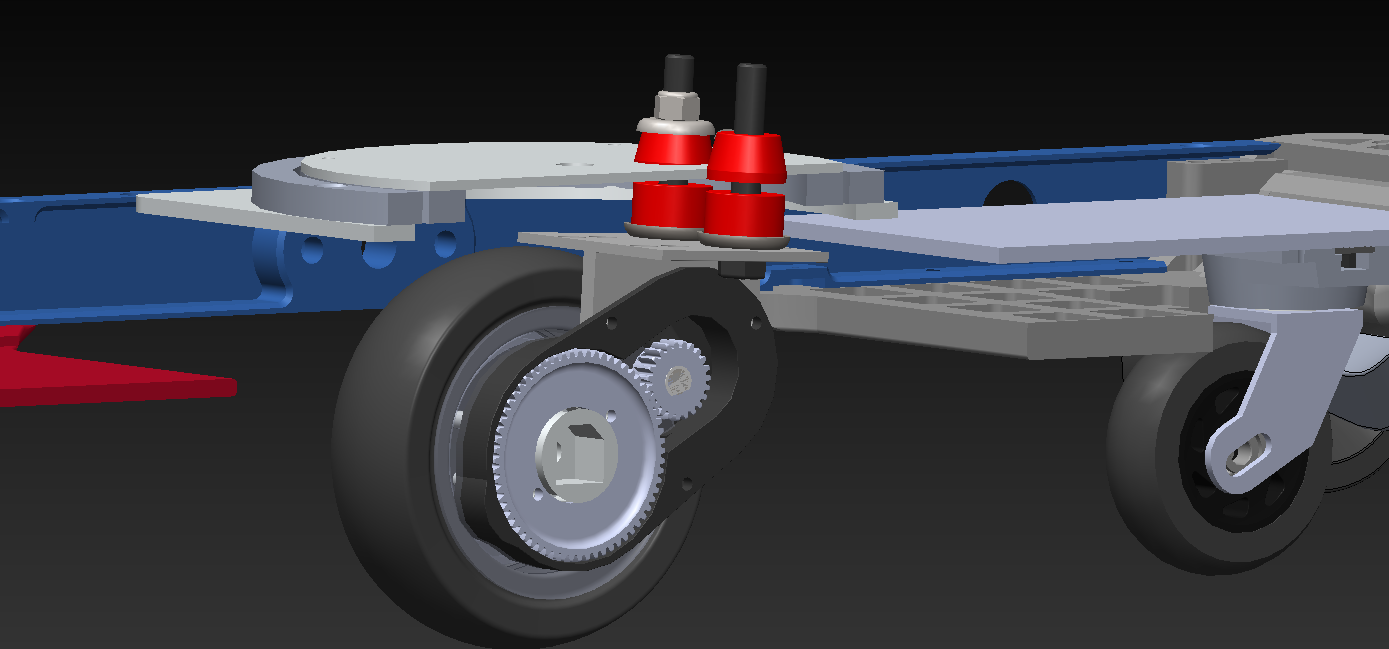

Trying to get enough suspension travel with a 5in wheel to make it so the bearing can be moved up within the rails, not quite there yet. I guess I could move the edge wheels and castors up but carving out more of the bumpers unless some tiny castor wheels used.

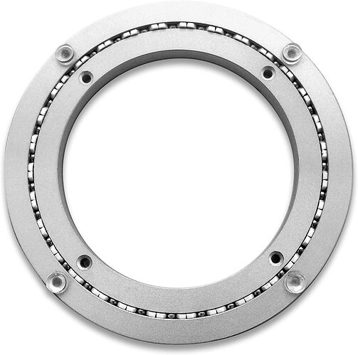

Throwback to these bearings
that could be used instead of a diy lazy susan bearing.

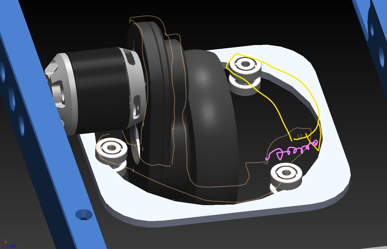

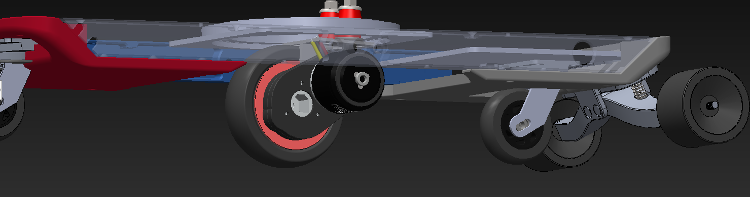

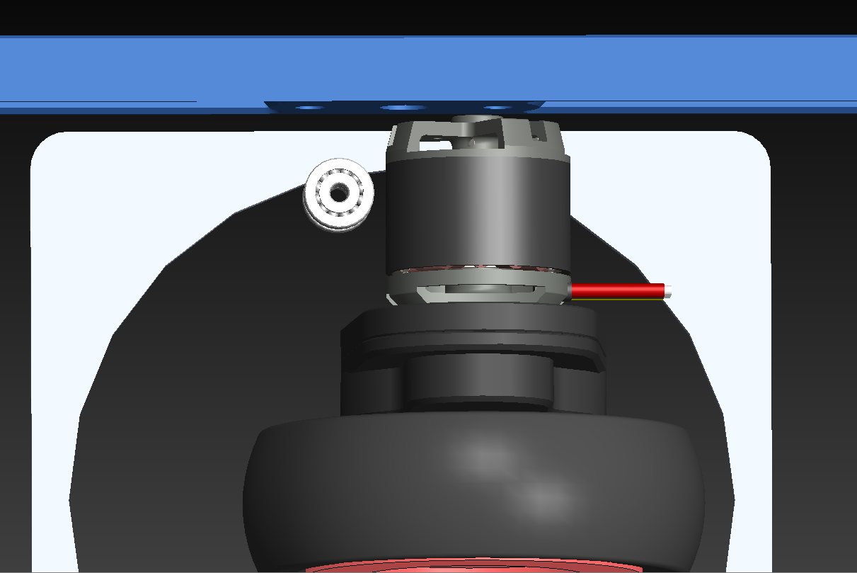

you can see here where the motor sticking out makes it need to be above the bearing. I suppose the gearbox could be angled and tucked below therefore a much smaller diameter bearing used, also lowering COG.
I want to figure out the bearing and gearbox mounting on this version then adapt those parts to the belt drive version using a sbx or diy maybe jmk wheel.

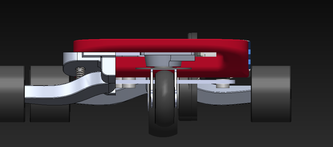

Interesting if two suspension castors in the center could ride fine without the outer castors.
For the idea I mentioned long ago about having a pull to drop center caster it would be cool to put the remote into that part you pull on. Could have a slip ring in that handle or it could have the slip ring on the caster.

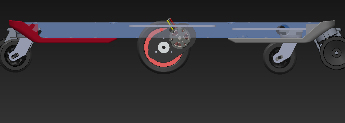

clearance issues pt2, with the wheel moved farther away from the bearing the suspension could pivot around the motor side of the gearbox. Much simpler to do that than the linear suspension needed with how I showed before.
Prob an undue compromise but to get a shorter motor it could maybe be reduced to a 4240 sized motor.

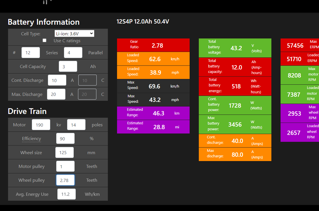

here would be the speeds and stuff with a 2.78:1 gearbox and 5in wheel.
approaching an easy to make and tough center suspension module.
several clearances to refine.

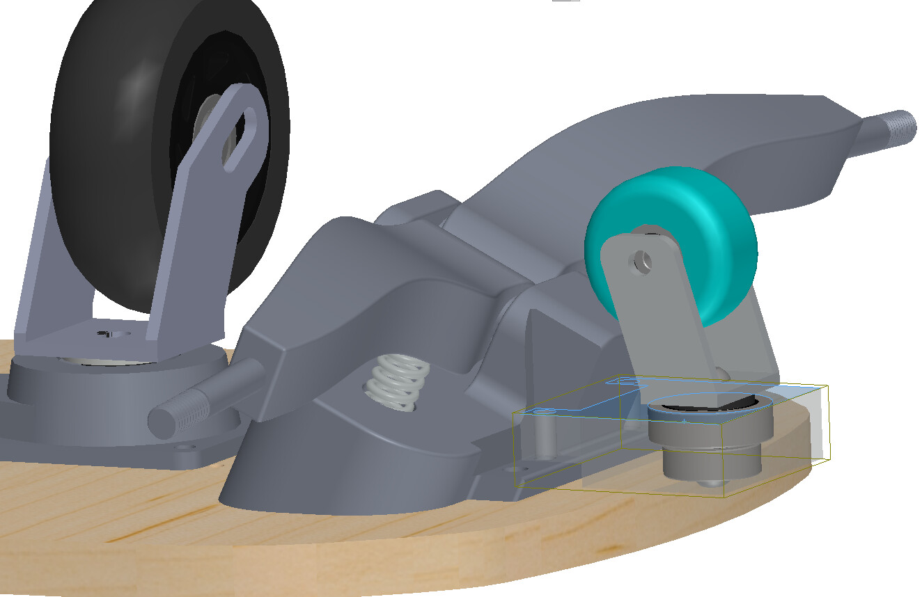

Might have never posted this, I wanted to see the smallest and maybe cheapest caster I could design.
It uses old rusted bearings from esk8 boards. 12x28 and 10x22. It has special geometry seen here to perfectly fit on the ends of the 5-X.

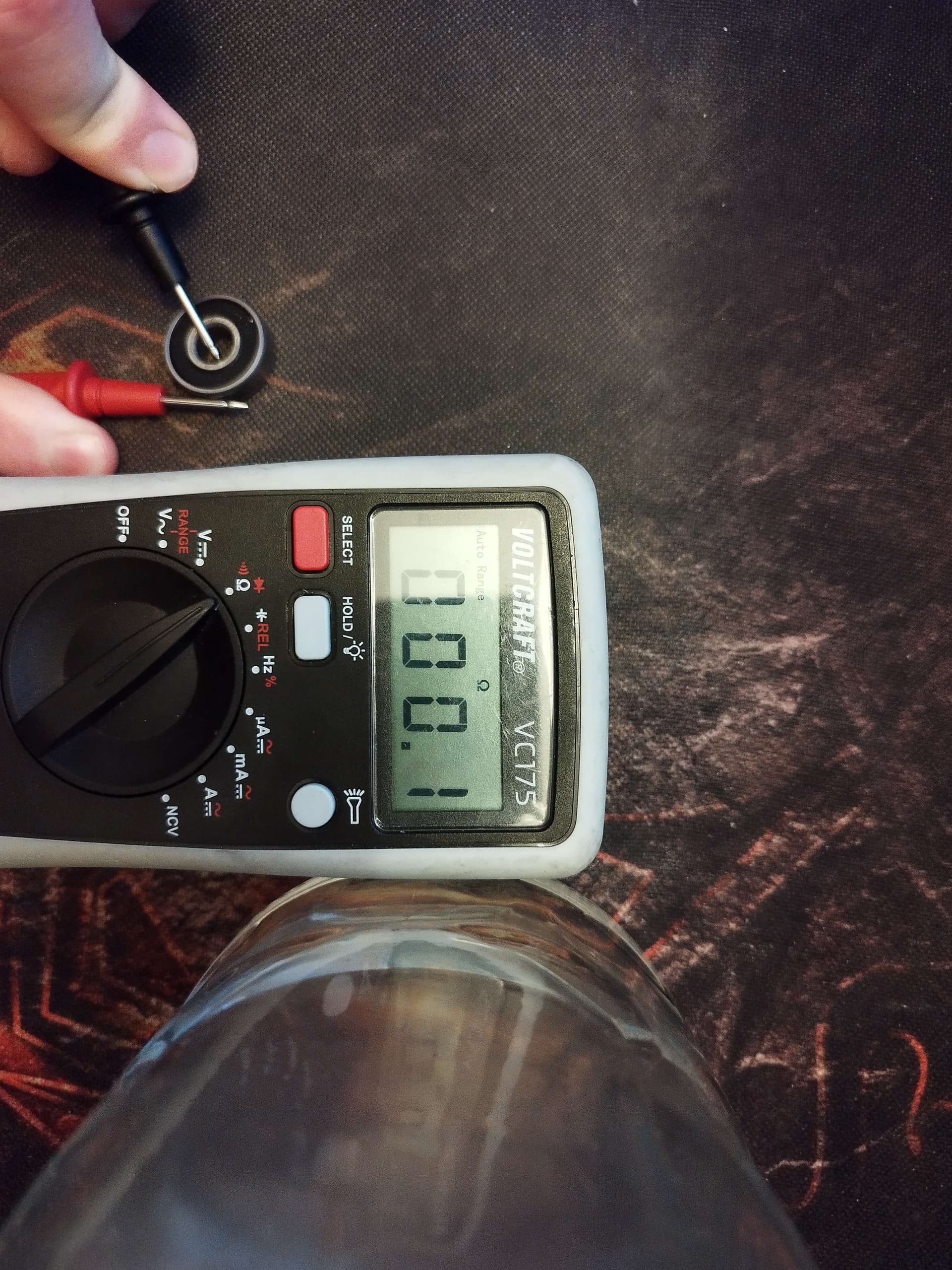

Today I was thinking about possible substitutes for the standard slipring system… and I came up with this idea:
Why not use bearings filled with conductive grease for the contacts?
In the picture you can see a standard 608 with some factory grease in it measuring a 0.1 Ohm resistance between the inner and the outer race. With some electrically conductive grease this resistance can further be decreased. Or maybe even just by using larger bearings with more contacts and better tolerances.

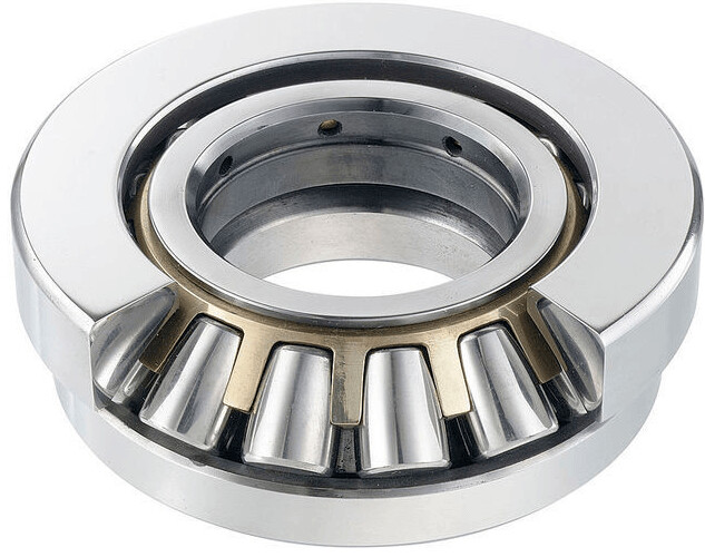

Because of the load on such a bearing design would be almost entirely axial the way I imagine it, thrust bearings would need to be used. Maybe some heavy duty spherical roller thrust bearings would be ideal because there are some shock loads, but I am not a mechanical engineer so idk. The bearing’s axial load rating would need to bear the riders weight though. And idk if these kind of bearings exist in a sealed design. Or maybe with the pressure once a rider stands on the board, the connection would be good enough without special electrically conductive grease?
The way I imagine the system working, is by having multiple concentric bearings of different sizes, and the same amount of aluminium bearing holders for both boardside and roadside that matches the number of bearings. These would need to be electrically insulated from each other by maybe some some plastic piece thats pressed inbetween them.

I’ve seen this discussed when researching DIY slip rings. The problem is they will spark and get worn down by the electricity. While it might work for a time it would be much harder to service then the Summerboard style slip rings.
Would be awesome to combine the caster bearing with the slip ring itself if it did work well!
