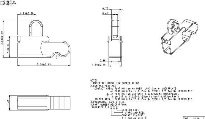

@Battery_Mooch premade spring contacts aren’t such a bad idea although I have ordered the BeCu sheet to mess around I went back and found these:
https://www.digikey.com/en/products/detail/itt-cannon-llc/120220-0161/2403785
Have it here now actually
Is about 1.1mm of movement enough?
I think so, the travel of the spring in a pancake slip ring just accounts for the compression to get good contact and allow for any slop in the construction.
I really like how these will bottom out to prevent deformation.
One issue I see with the way the leiftech and SBX slip rings are assembled is you can easily press on the ring outside and therefore on the brushes underneath it
There is definitely some travel going on with the leiftech brushes. When I spin them in my hand while cleaning the grease I can feel it being slightly elliptical. This could offer some advantages for reliability I think. Right now I use about 1.2mm of compression, set at 4.2mm and the space is about 3mm.
https://www.digikey.com/en/products/detail/amphenol-icc-fci/10104321-009RLF/4238783
This one would fit for trying to recreate a V2 brush setup with these premade spring contacts.
