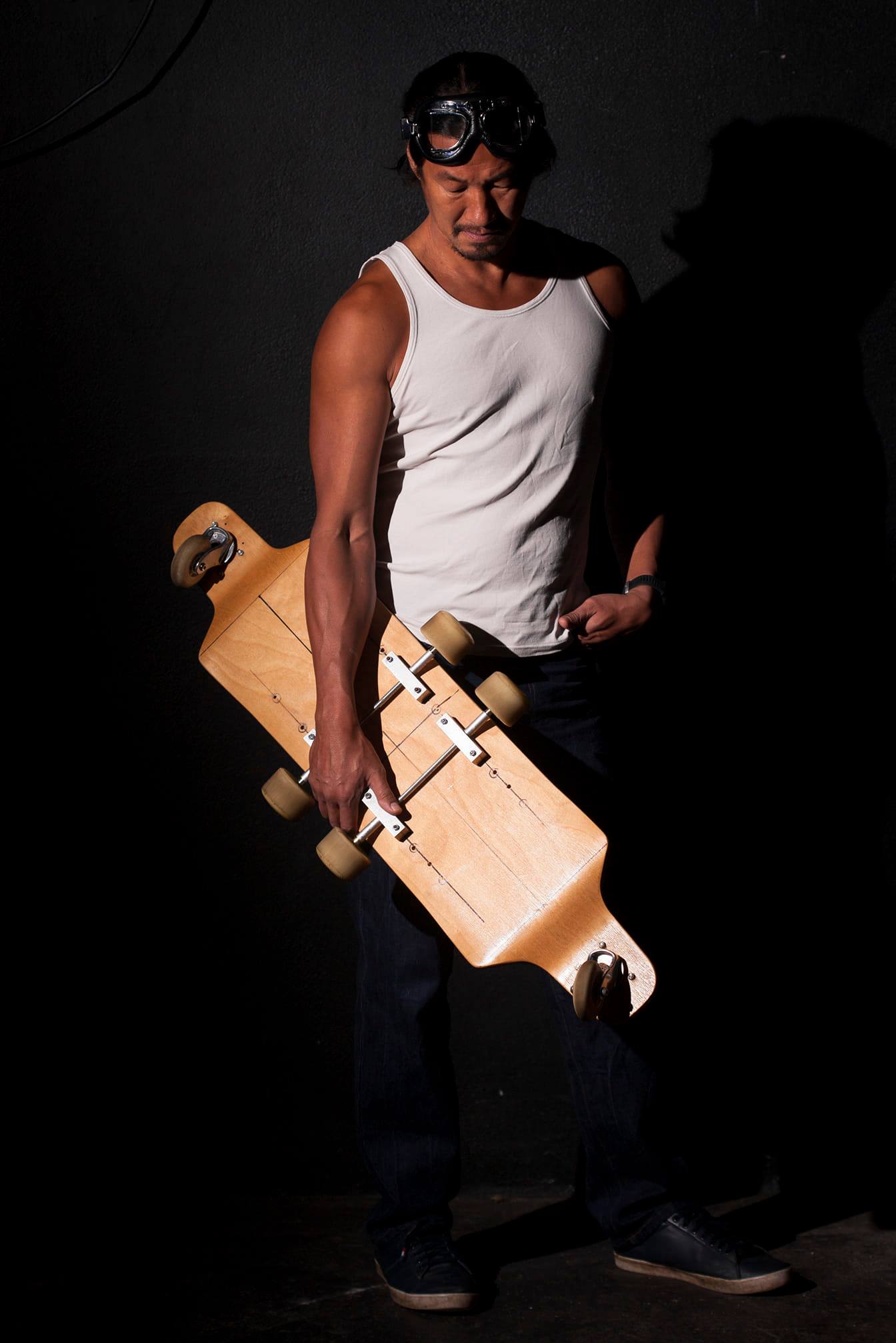

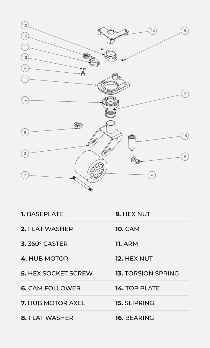

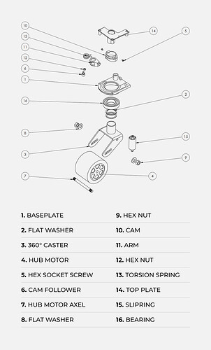

E-Freeboard Freebord Open source Electric Caster

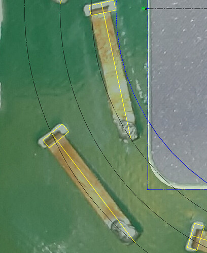

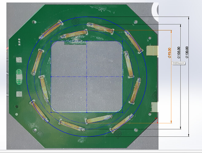

I wonder how wheel wear/coning is reduced or different on these.
perfect for a more direct freebord/leiftech hub motor conversion.
twas hiding right there all along
uugghghh so fucking hard to understand before you try

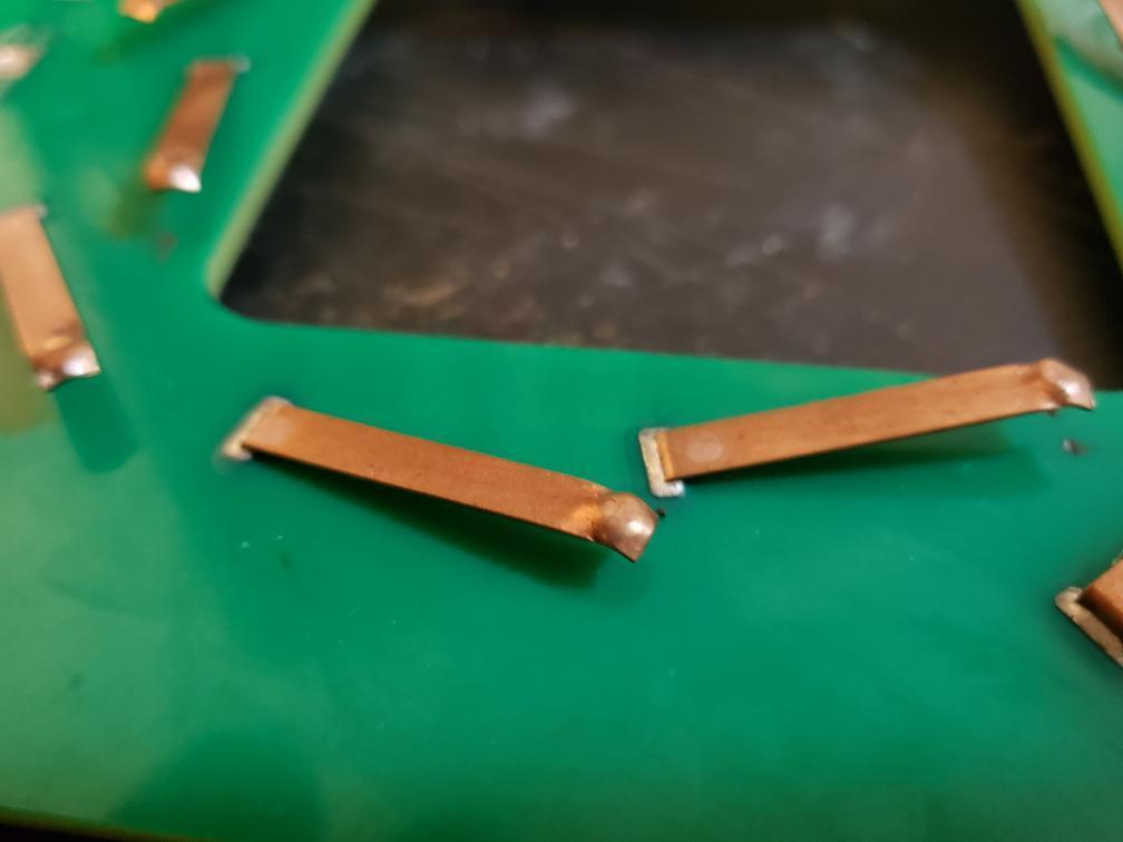

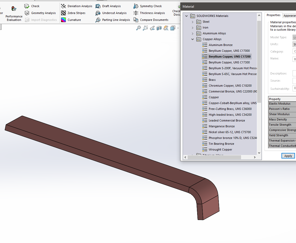

as you can see here the top surface is flat and the corners are bent down
not sure why I have not done this already. :man_shrugging:
fairly close, hard to tell what is from the picture misassignment.

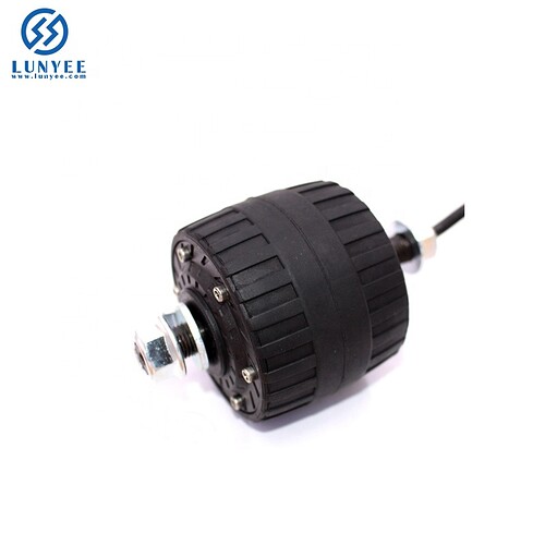

For international sourcing these look like an identical wheel profile to the JMK ride version. I know someone found theirs like this on Taobao also.
oh while searching I see these
without the nice rounded profile but it could be ground to have it. It is the correct diameter at least.

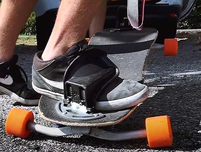

Electric freeboarding on the Driftboard drive kit prototype with Joshua Jackson AKA SlideJumpSlide

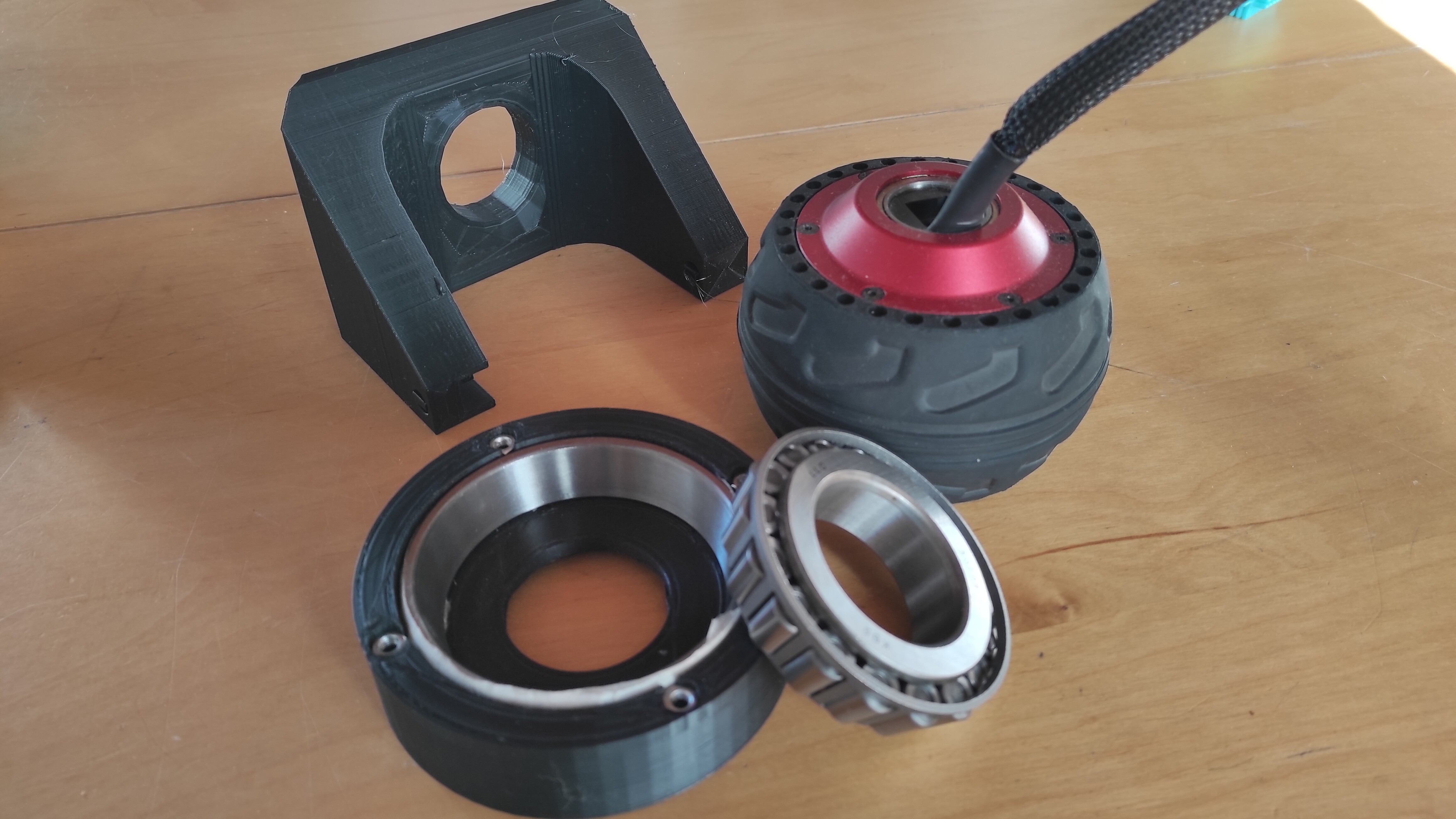

Hey guys. I have been away from tinkering for a long time. I have a lot to catch up to. Yall have been busy !
I wasnt happy with the belt system, its hard to have it well tensioned. So i bit the bullet and ordered direct drive motors.
This is where i am so far.
I hope you are all well
Cheers
Alex

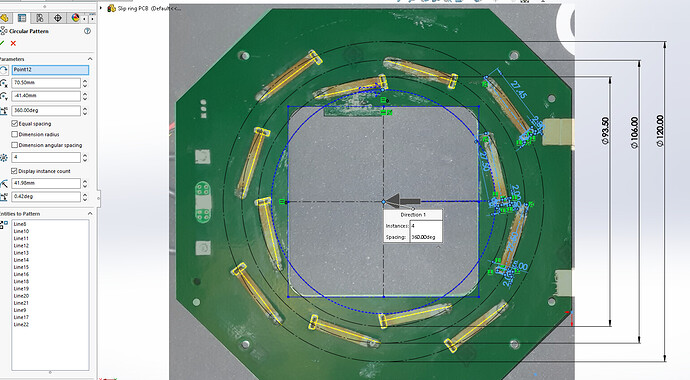

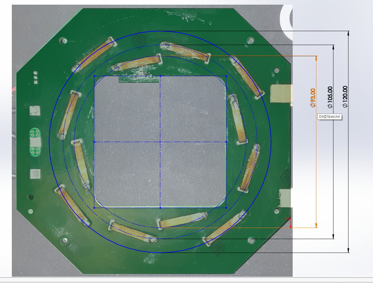

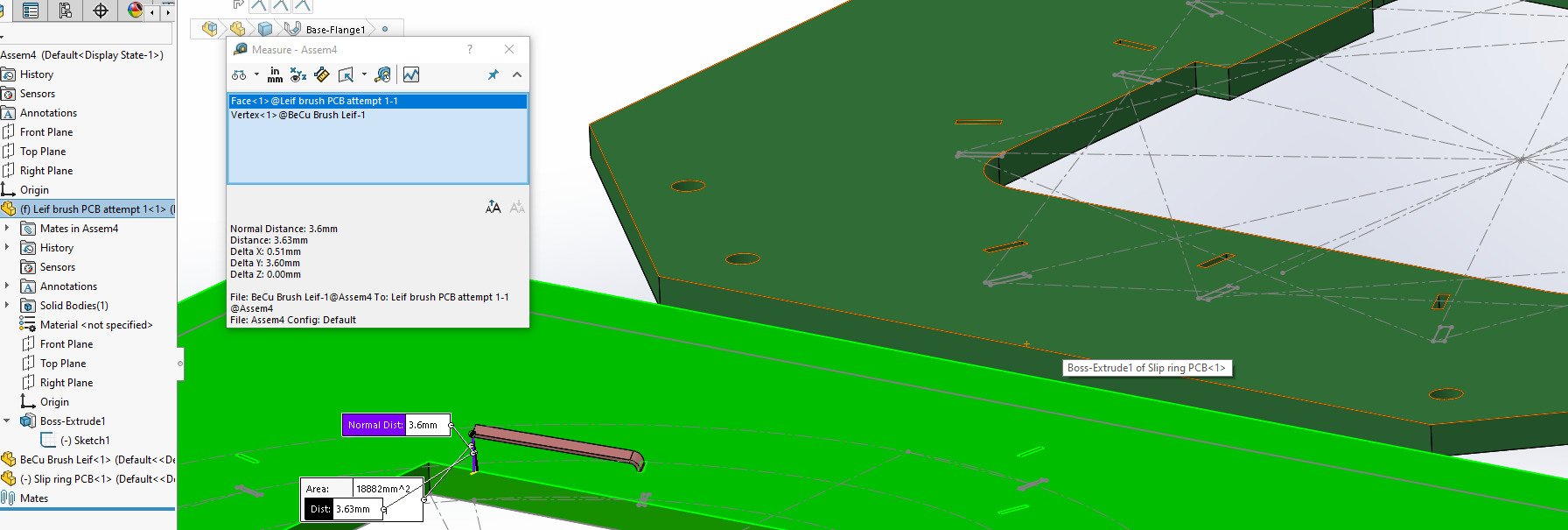

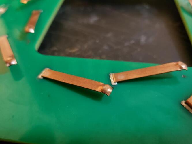

I panicked because i realised suddenly that those new motors have a hall sensor connection. And my sliprings only have 3 wires.
I tried running them only with the 3 central wires, and it seems to work.
But anyway a 3d printed flat slipring with gold plated metal rings might still be the best, and flattest, way to go.
If the whole wheel system is tightened with a common bolt like on a freeboard it is probably the least ratlling system.
