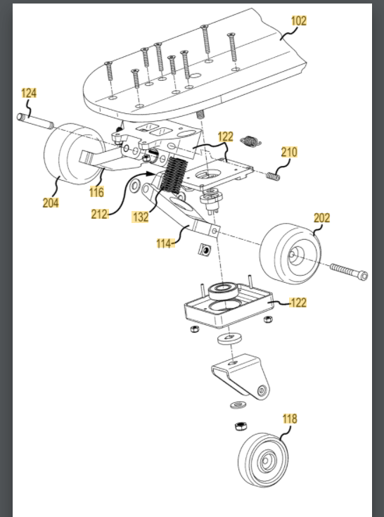

I’m working on a large ball drive version that should have a really interesting feeling. I’m not sure if I should make a ball shaped wheel on a caster or omnidirectional drive with no module rotation/caster but if able to be driven sideways with a drive system like this.
I think casting my own inflatable polyurethane wheel would be very interesting
so I want to design a planetary gear hub motor that fits in here.
prob can ditch the suspension aspect with this
I have definitely thought about it once or twice but these wheels are damn near perfect and I never posted them.
2.64X more per wheel compared to the JMK ride at 9.5
pulley would not be tough to design though.
I want to try fitting those to the regular freebord also actually.
might as well get the whole board for $200 more so I can design a custom motor mount/extended axle end bit.
Some of the rounded hub motors I looked at before would be good too.
