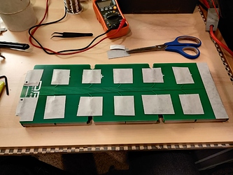

Fish paper the sides (or more) of each welded p-pack to protect from shorts.
Splooge a bunch of neutral cure silicone onto the PCB and stick each p-pack down.
You will have to insert the tabs through the slots at this point, so it may help to have the PCB propped up with something (I used the empty boxes my cells came in). Make sure you are lining the p-packs up with the positive and negative markings printed on the PCB.
Once this is all done and you flip the pack over for step 4, you should probably cover all your exposed terminals with painters tape or whatever to avoid shorts.

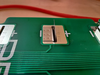

Step 4: Spot welding pt.2 💥💨
Your spot welder power should be much lower when welding nickel to PCB than when welding nickel to cells
At this point it is also probably good to bring up that the copper pours on this PCB should never be carrying the full series current of your pack on their own. Therefore the spot welds we are doing here is just to stick everything together before we beef up the connections in the next step.
The footprint of the bush terminal encroaches a bit on the nickel, so trim that away.

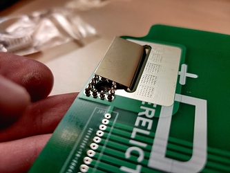

For the single-slit connections, fold the first nickel tab down, spot weld it in place. (You are going to smell the PCB, thats normal and probably fine. As with any welding or soldering, do this in a well ventilated space.) Then fold down the second tab right on top of it and weld it down.
For the double-slit connections, you have two options. The first option is to fold each tab away from each other, and then bridge the gap between them with other nickel or soldered wires or something. Thats dumb though, so dont do it.
The better option is to fold them in towards each other and weld them together just like the single-slit connections. Whichever tab you fold down first is going to be a little too long, so trim 2 or 3 millimeters off it and then weld. Then fold the next down and weld.
When you get to the packs on the end, there is no slit. The tab just folds over the end of the board.
