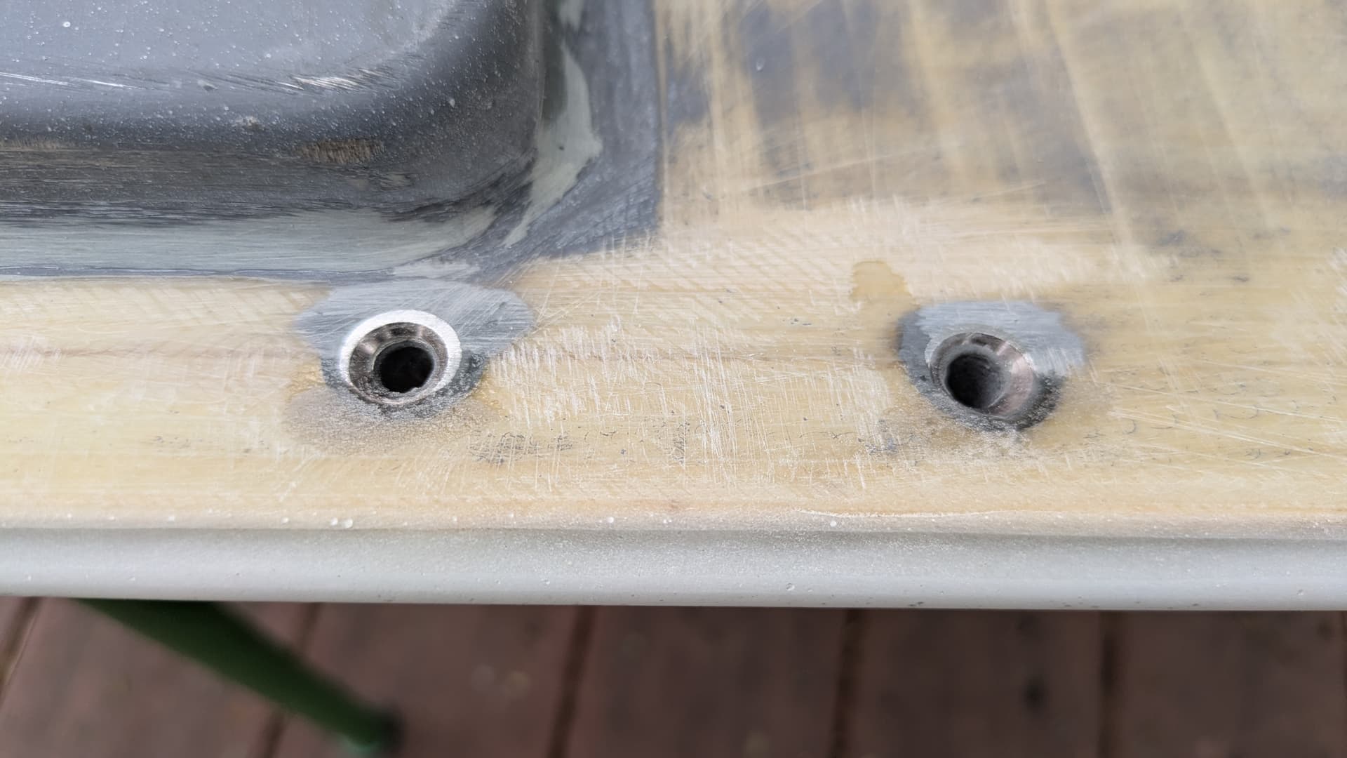

Female sex bolts will be epoxied in prior to the final fibreglass layers so will be invisible fixings at the finished board from the top. The final layers will have to wrap the edge LED lighting and go round to form a 2mm upstand for the seal to seat on.
This will provide ample clearances around the bms which sits under the deck ‘hump’

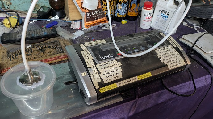

Q-Beads and west systems is shitty stuff to mix so I gave 2 minutes to improvising a vac chamber out of some old home brewing equipment…
Wasn’t fantastic but I only expected help and it worked in helping bring bubbles up, you could see it lift… haha very silly…
Anyway, mixing the beads in and the epoxy goes mental with heat and I realised at just the right spot to pour
Won’t know till Monday when I get time to strip it and sand it but was fun. It looks opaque enough for what I want.

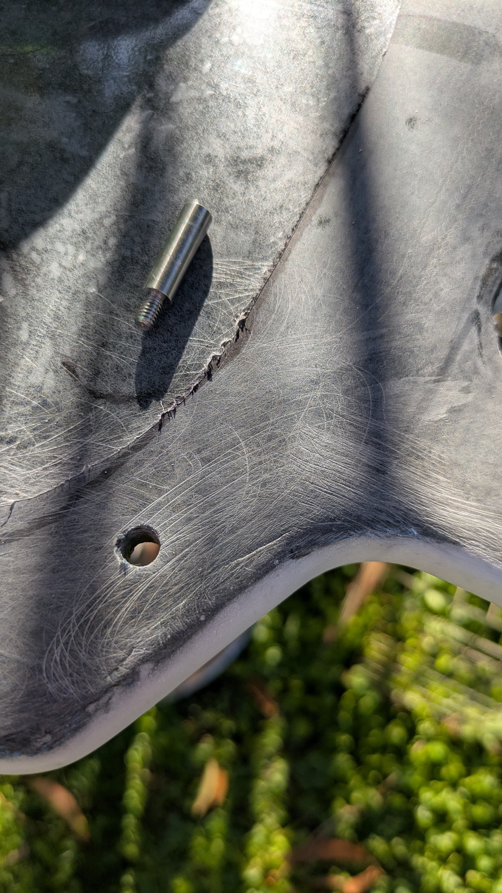

Couldn’t wait… got up early and got the sander out quickly
For the wiggly bits I decided to go back to UV glue, it’s much better for the tricky bendy bits, I can sort of apply it like welding a bit, you apply a fab on the edge of a icy pole stick and ‘weld’ it with the UV light. Going to be finishing off the ends tonight hopefully. I seem to have some momentum I don’t want to lose.
I won’t bore with more of the same but this photo here shows the layers quite well. Finishing with the UV Resin was definitely the right call. One more fill session, one more sand.
Next is the final glass layer for the bottom which will wrap the edge then the final top layer of glass to wrap the edge n the other direction.

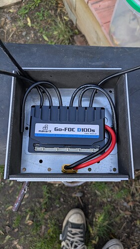

Shitty humidity and time constraints today but my enclosure was ready to collect. My favourite part of this is the added heat sink so the controller will be on 4mm of heatsink directly.
Elegant solutions are the best solutions
