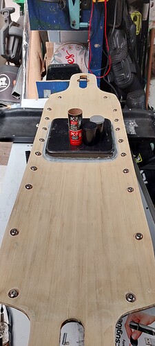

I am also firmly in the “fuck that flangeless bit” camp
decided that fuck it, I really did want cup washers for the enclosure bolts inserted in the deck… and bigger… so drilled the deck bolt hole out to handle the sex bolt diameter. I’d previously had the deck drilled for the cup washers but as a push fit kinda setup, decided I hated that easy approach and I should make it more complex.
Bored the cup washer seat out even larger to accommodate the seating compound around the washer.
Completely unnecessary, overly messy and tedious will be a bastard to clean up… it’s perfect.
I have a “one Day, One Job” policy going on at the moment, finding it difficult to get ANY piece to completion so I’m bringing my focus back into single tasks.
After this bit is finished it will be onto the 3DS gear drives, I understand I have a set of Radium 6374 awaiting putting onto these so pretty happy about pushing that ahead too.

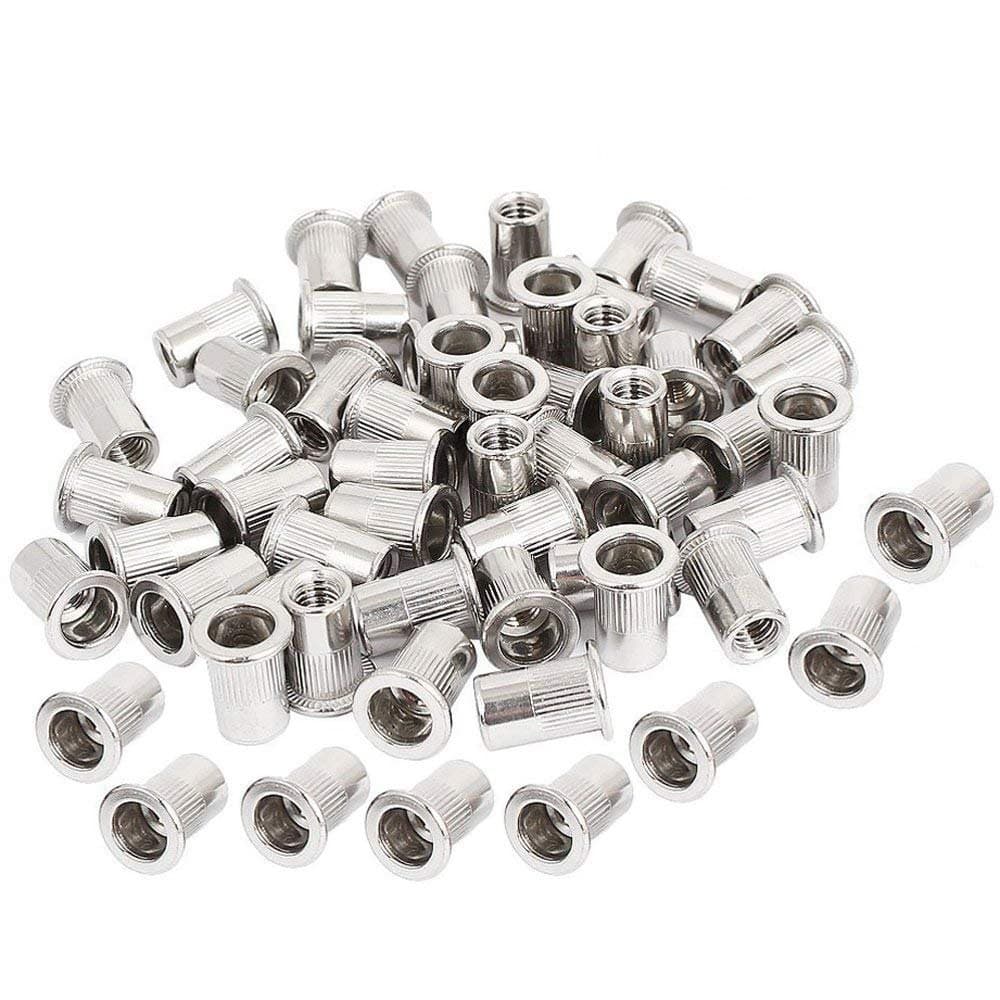

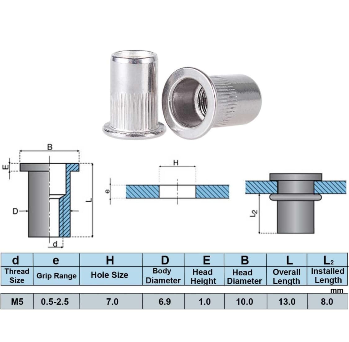

Rivnuts work well for this too, and are even lower profile.
How large is the shoulder on rivnuts like those? Doesn’t look like they’d slip through easily, but just curious.
There isn’t really a shoulder. They are basically 7mm from bottom to top until you get to the lip. (On m5 rivnuts). I secured them with jb weld in the deck.

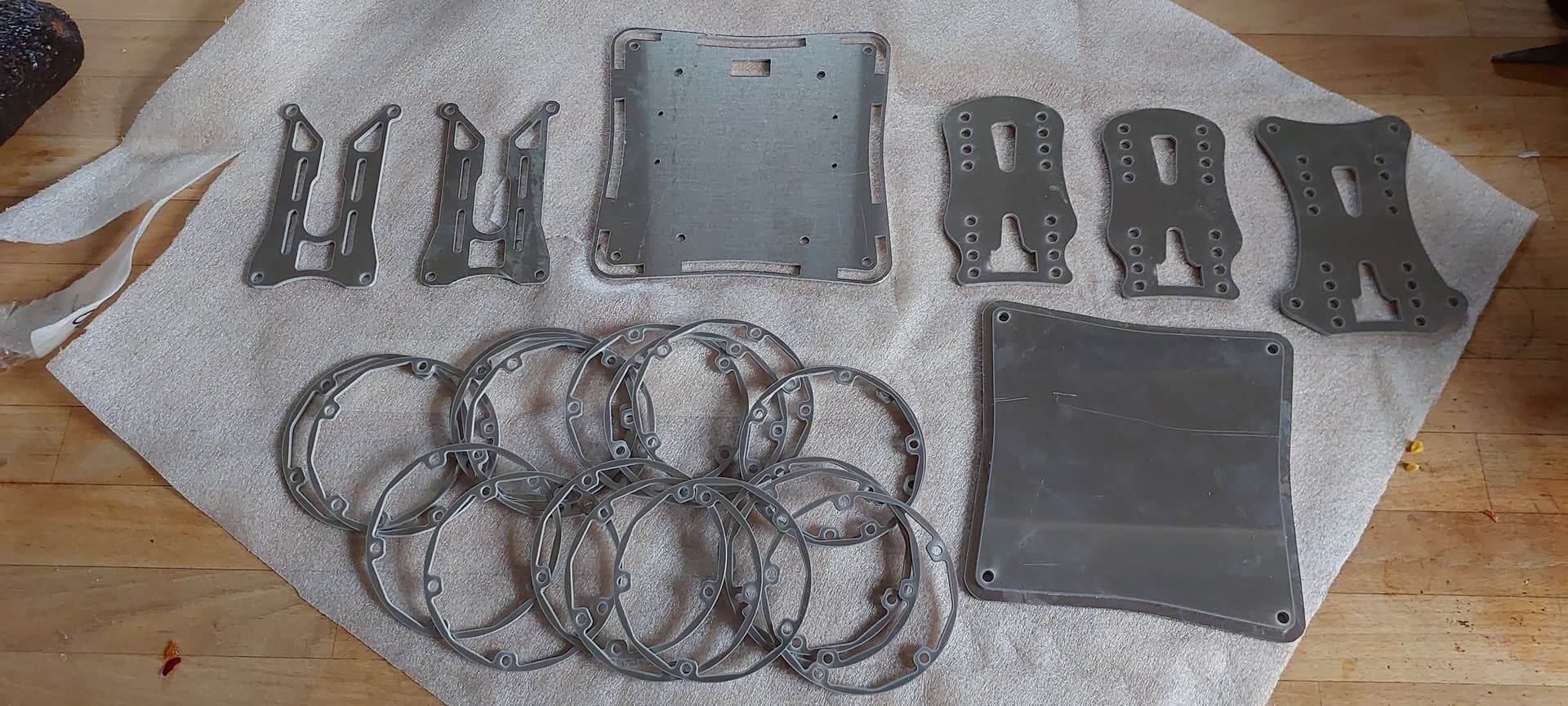

Things are tightening up with getting the plates in. I feel some assembly coming

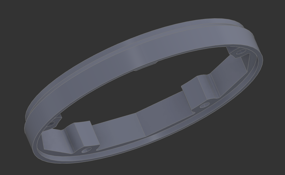

Nice! I see you are widening mbs rockstar ii pro xls. How wide are you making them? I am interested how the metal spacers hold up! As far as I can see that design doesn’t use the “locking ring” feature on the hub.
I am actually also widening a set too, but I’m gonna use a 3d printed spacer from nylon (if I can sort out the issues on my printer with printing nylon).
The picture is the 10mm version of the file, but I am gonna use a 20mm version
Can go 6mm all round or beef up the rear to 10 (+a spare wheel/hub)
Currently thinking 6 front, 10 rear, i have these to fit (different board to this build)
They gunna be chonky

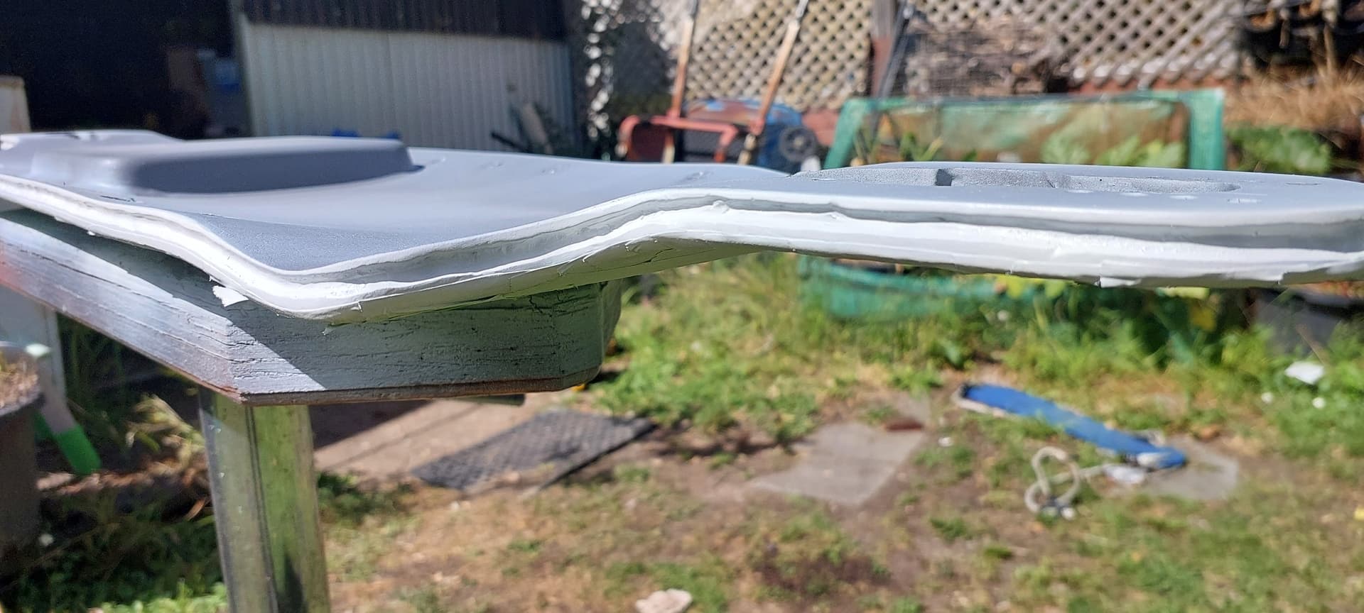

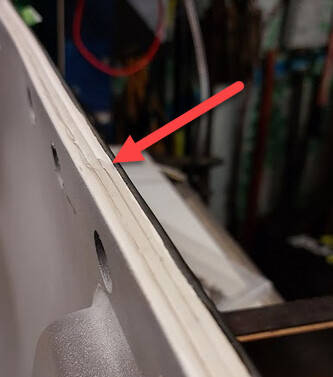

Getting close to installing the edge lights so thought id give it a white strip in the groove to hopefully add some reflective diffusion… dunno but shouldnt hurt and it feels better to have sealed the wound.
Sat with some sandpaper the other day and smoothed out the edges aroynd the hump. Roughly… another hour would have been great but im not trying for a production quality board… I’ll be happy if it just doesnt snap (instantly) haha…

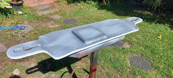

I thought I’d better find some motivation and crack on with the LED under the UV Glue edge.
There is a few uglier sections but a nice even flow up and back gets pretty good results, Im going to over pour so it’s rounded and then possibly sand flat and level with the CF

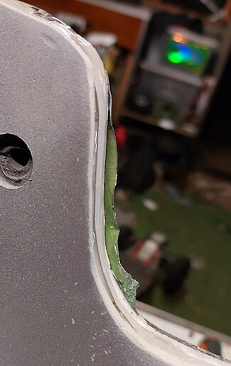

I can say with some certainty that its shit to remove once set in and somehow, despite multiple checks, when I got to the end of the board ‘tacking’ the LED in place I was confronted by this.
sharp dremel pieces fix/hide everything… got most of one side complete and now Im happy with process I’ll get on with the other side in the sun tmoz
