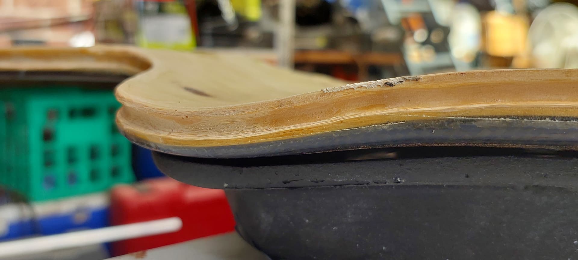

Kept wondering if the paddle is made of carbon :face_with_monocle:
Naa, was timber but needed reinforcing due to repeated… abuse

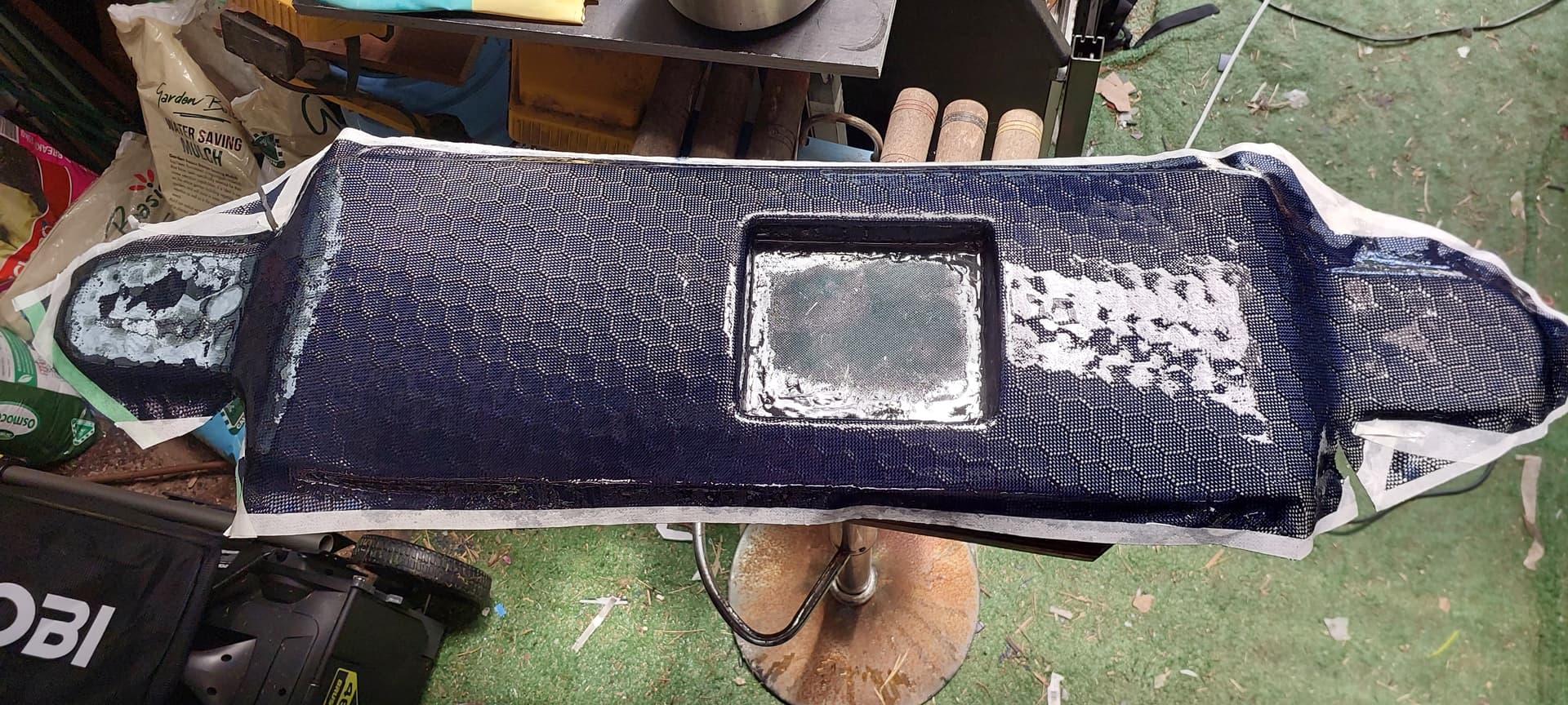

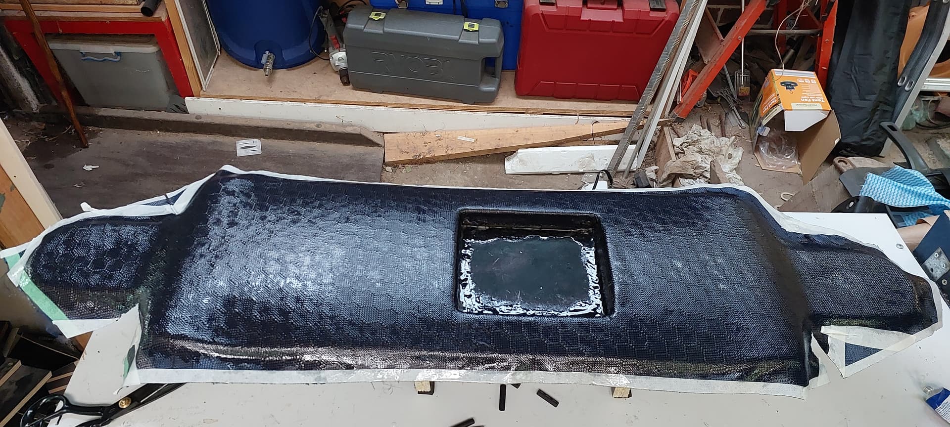

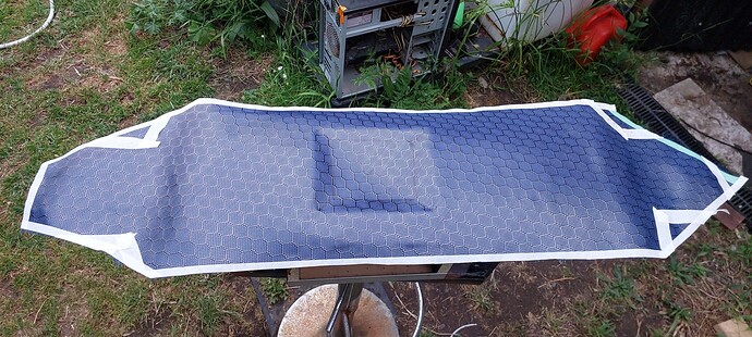

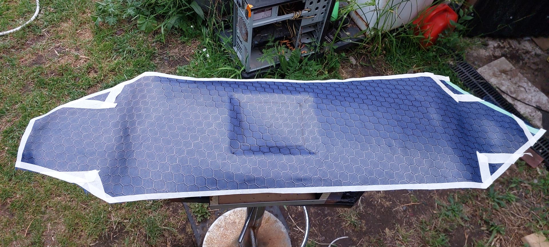

Awake stupid early this morning so when i got back from a per-coffee ride, i set to the final layer of CF.
Wetting it in went well, i spent extra time on the edges and im prerty nervous but confident

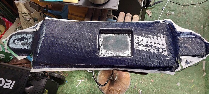

I had to piss off for another ride so id have to leave it alone, every time i took the gloves off i got sticky again within seconds… so a few hours later i got back and gave it the first finishing coat.
Let the epoxy > Sanding > epoxy cycle begin
Can you thin epoxy easily or does it bot do well? I dont really want another full layer of epoxy. Just touch ups on rough areas.
There are thinner ones. But I’d use what you started with.
Heat will make it thinner, but kick faster.
I’d sand it all and then go w a full thin layer.

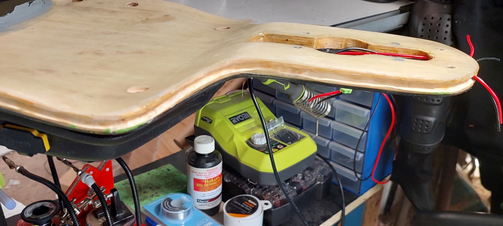

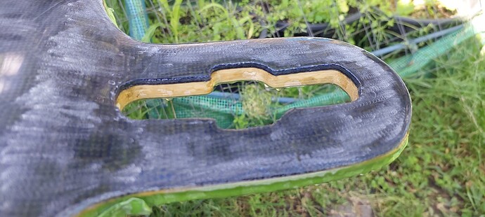

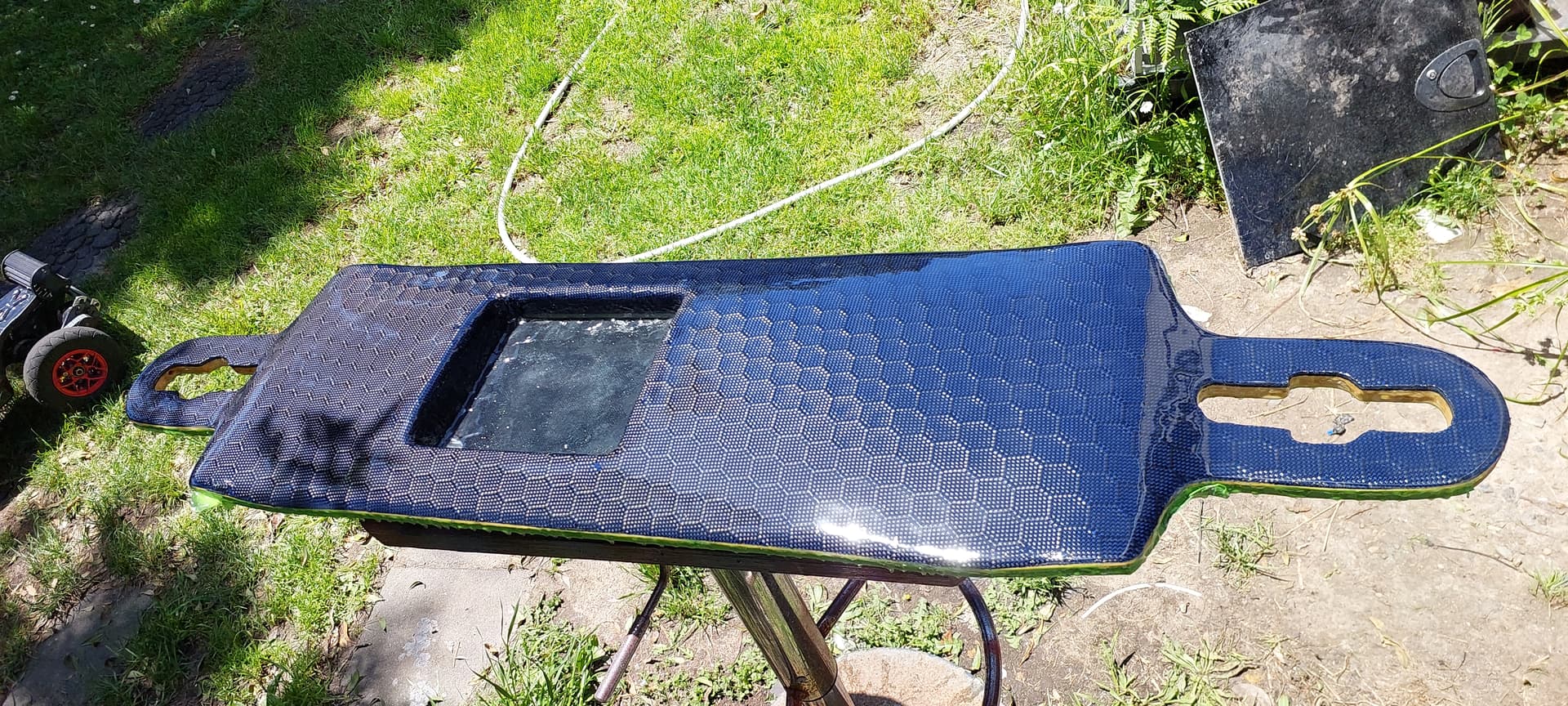

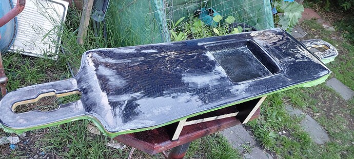

Sorted. Its not perfect or even close but its mine and my first go with CF/FG and epoxy (not counting the paddle)

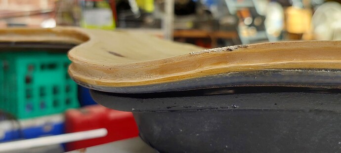

Around 4mm, it’s a little more than i was initially going for but id rather that than a snap. @glyphiks 's weight comments have been noted
Perfectly imperfect. Theres still some work to do around the side and on the top which shouldnt pose too many issues now. Overall, i quite liked learning all the bits i needed for this part of it, i was quite concerned that itd fail at that point and id have to get another deck and start again. Patience is something this hobby demands.
Looks pretty good dude :ok_hand:
It looks great but I can’t help but wonder about the strength gains of splitting the layups you’ve done over both the bottom AND the top of the board.
Another concern would be carbon as the final layer and it’s potential to rub/short any electrical goodness inside.
Pretty good looking job tho, the patience has paid off!
The GTR never shorted on me :laughing: one of the only things it didnt do… lol… i did give that a isolation layer too.
There will be a full layer of EVA or other material between the deck and the enclosure. There’ll be no possibility of shorting.

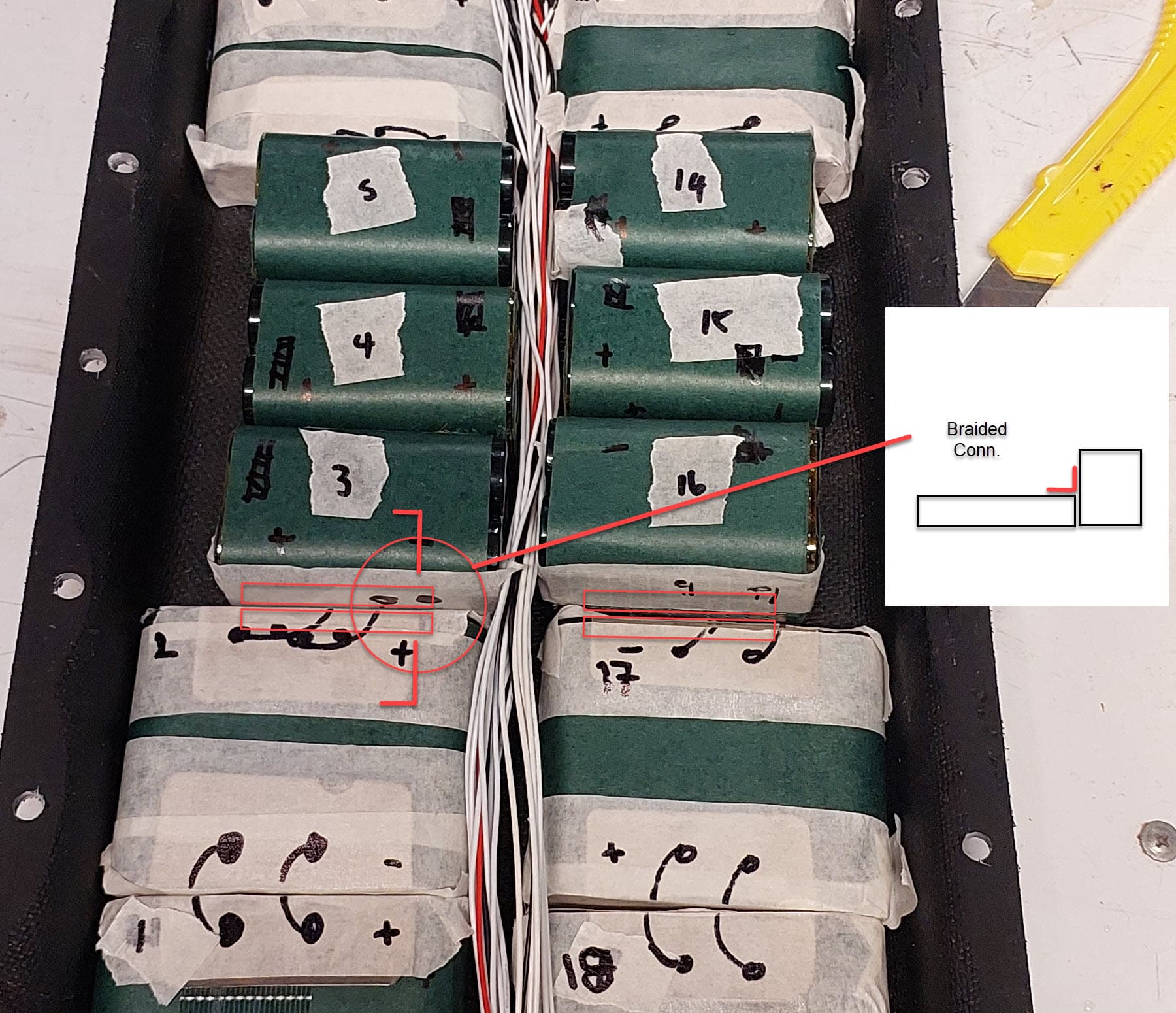

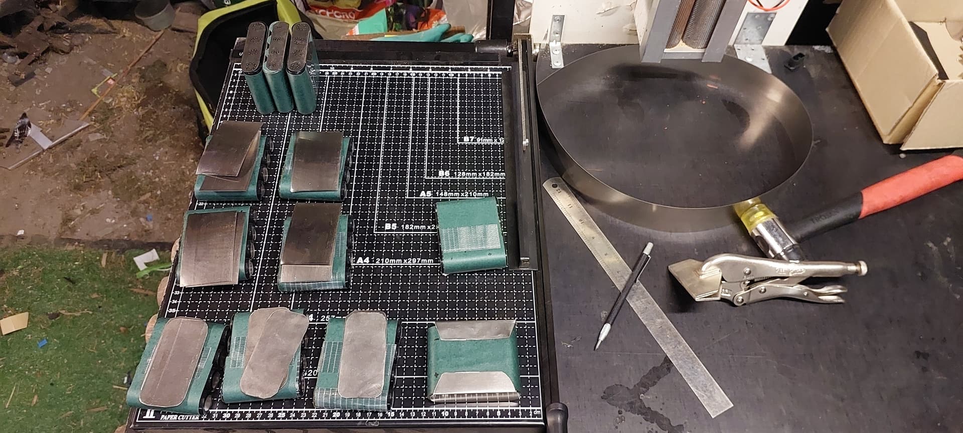

Welded up the single stack P groups last night and started to give some more serious thought to the tricky areas around the hump.
the critical area I’m trying to avoid is the top left of the double stack P group, its the closest to the hump, it’s not an issue for the pack itself, there will be roughly 7-10mm gap minimum at the tightest part once the gasket is fitted… speaking of gasket…

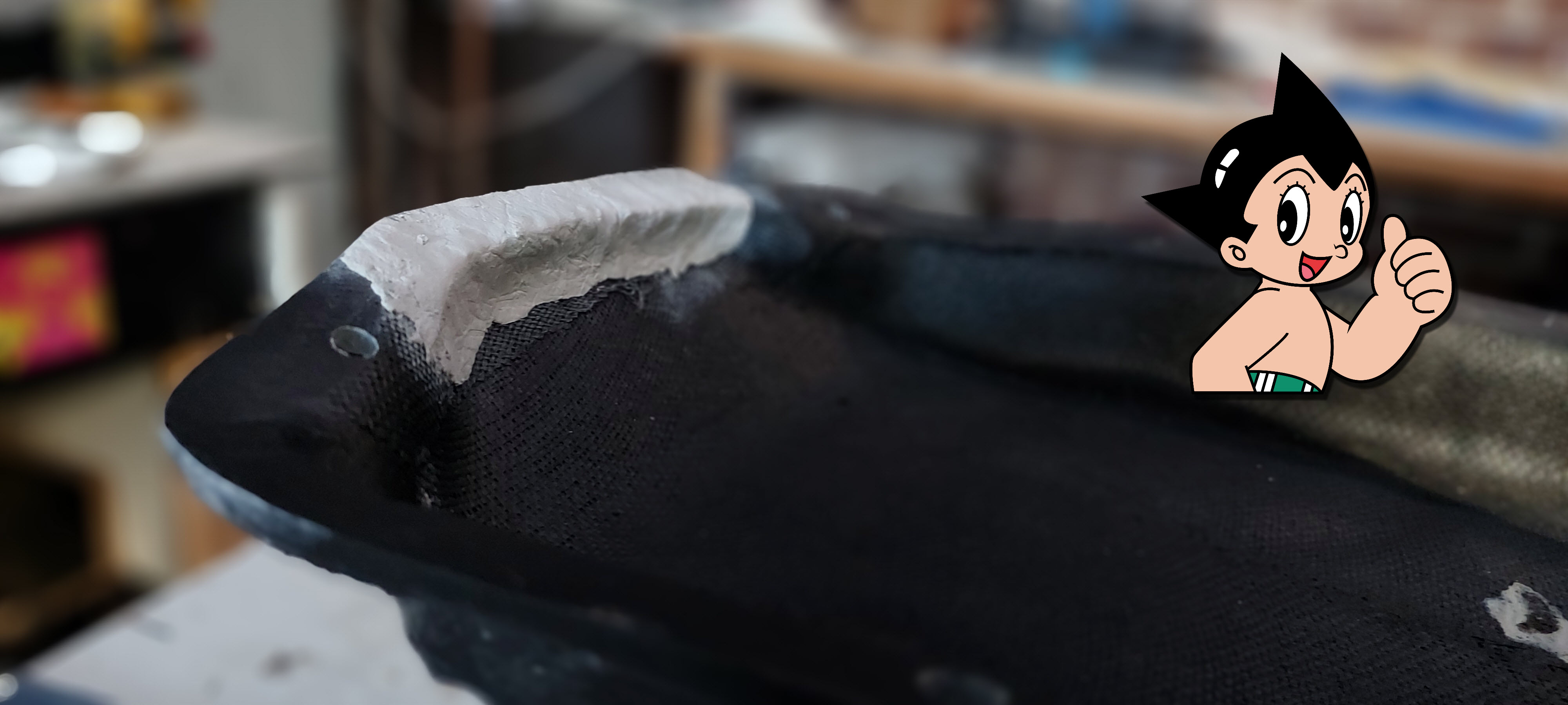

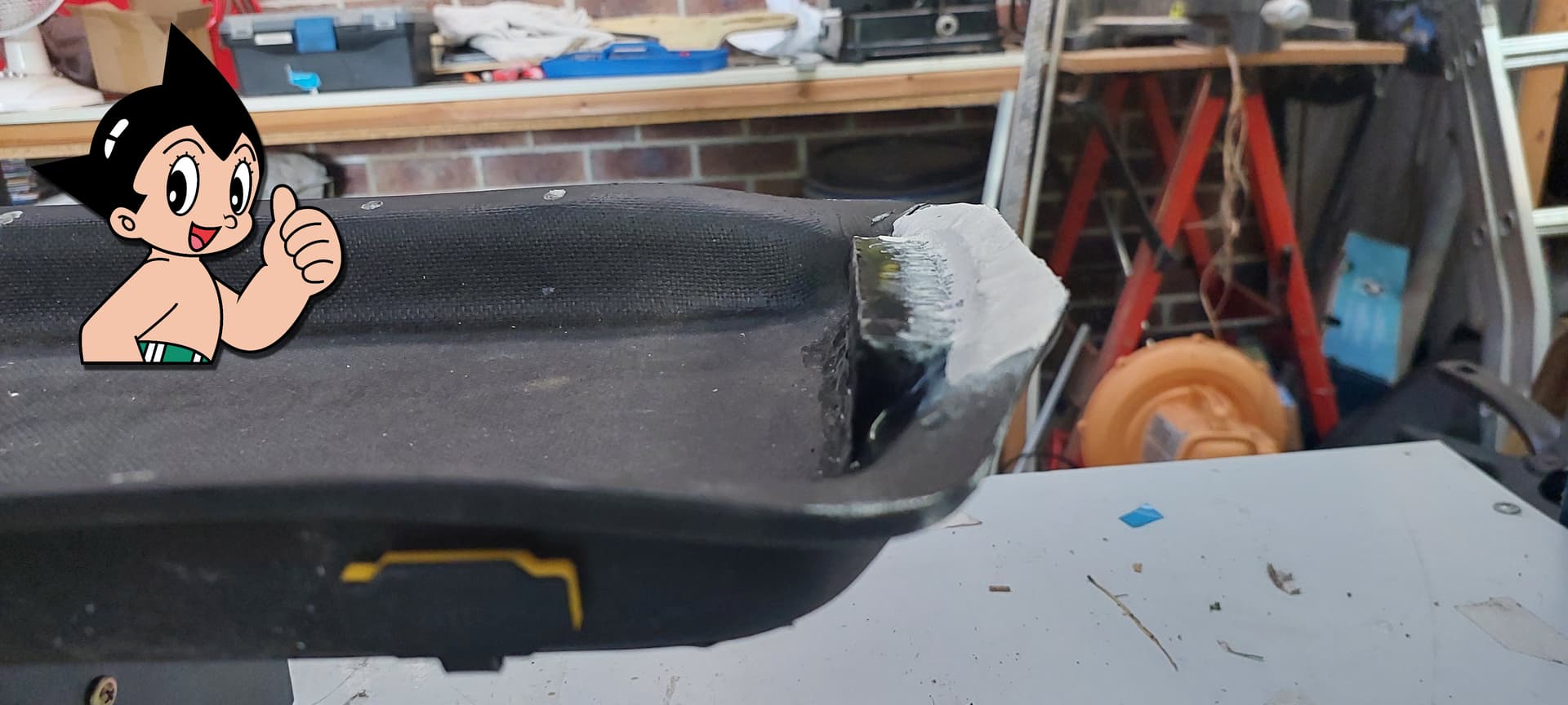

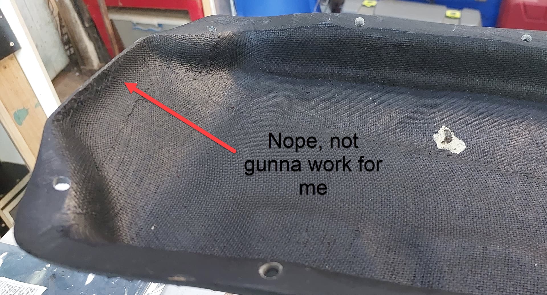

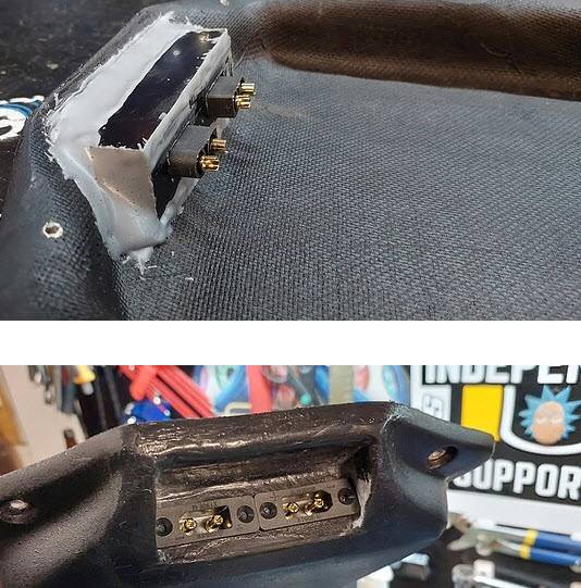

Cannot fathom why there is no lip at the front to seat the gasket, Ima gunna have to fix that and bog it up to add a seat. I kinda did that on the other end already adding the cutout for the XT90’s which also needs a touch of fine tuning for the seat angle but is basically there.

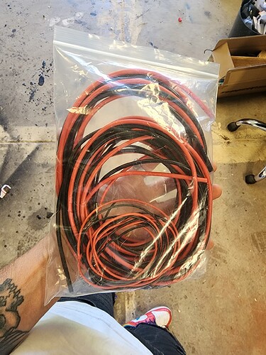

Feeling motivated this week so pushed ahead with much soldering practice and feel confident enough in it to go ahead and get on with the battery which is just waiting on some … cough… better wire to arrive so will get back to that.

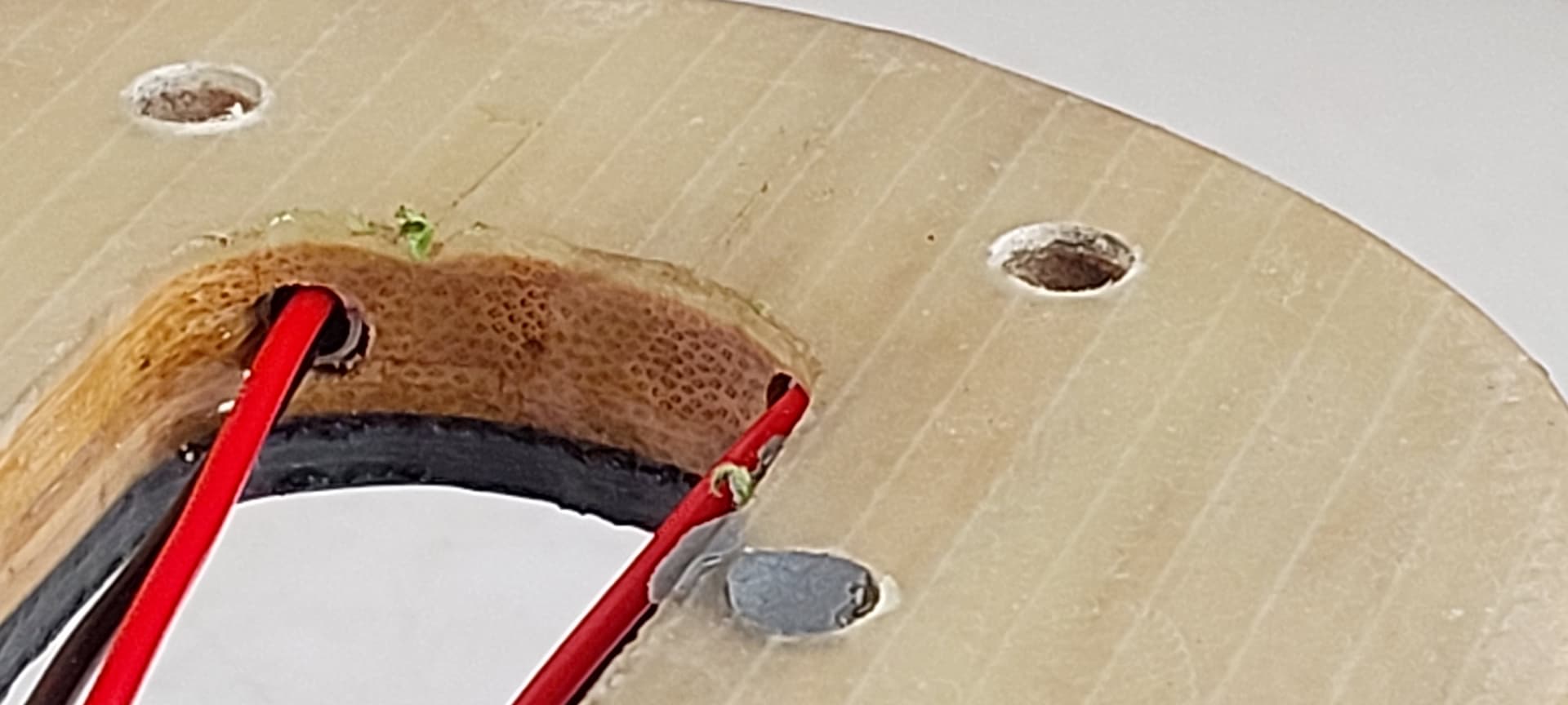

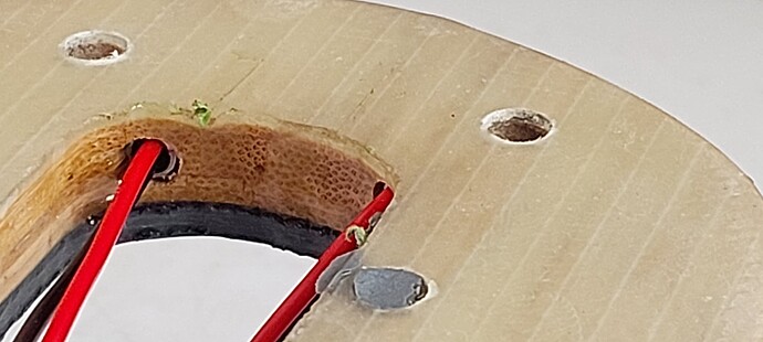

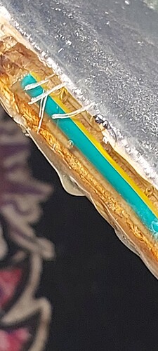

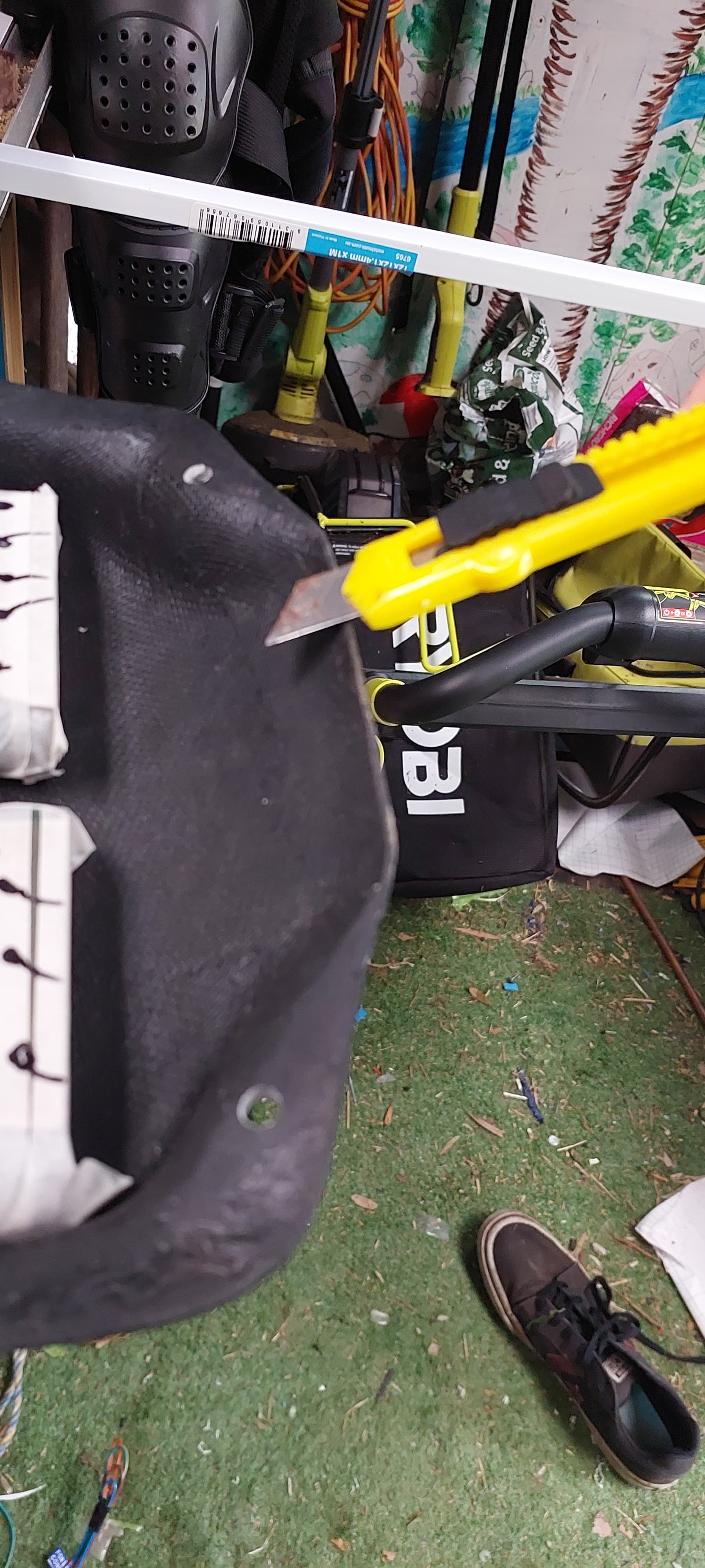

One of the things that’s been a bit of a thorn was the decks edge lighting that I wanted, once the CF and FG was complete on the base I could get into it with the hand tool and finish the groove in the side which had obviously filled up during epoxy because I rushed into it and didnt plug what I had already done… of course…
During this I wanted to sort out how the thing would be powered and I still haven’t decided on one of two ideas for it. I think I will end up running the buck converter in the enclosure and split it off to a jack in the enclosure, whichever it is, it still had to route the same way.
Testing some UV glue currently and is the main contender to seal the edge of the deck… you can see some scratches I did with the knife on it…
it’s sooo crystal clear it should be a crazy good diffuser for the led.
Oooh like the stuff that cures pretty much instantly under UV? That seems like a great option for that.

I need the enclosure finished so back to the mods for that bit today… half the time for these things is the pain of indecision in picking a direction… at least for a noob like me anyway haha… note the obligatory bird shit from a brief jaunt outside to look at it in the light…

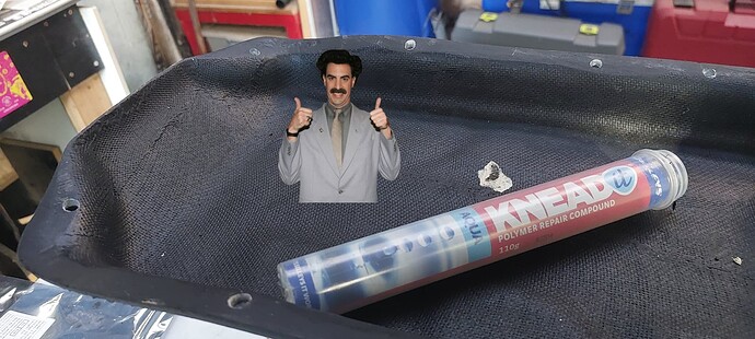

I could never work out why there was no lip here, I see other builds and folks just pass cables and such through but fore me… en usko niin… need solutions…
I’m listening Borat, I’m listening…
Astro seems ok with it so I’ll probably get a bit of sandpaper onto it and make it all naice like in a few days.
