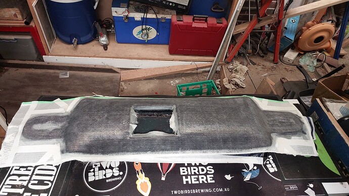

Jeebuz the glass mat is thick…

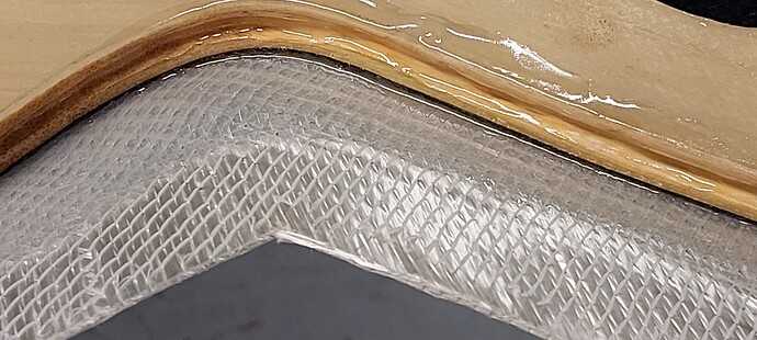

I put the 1st layer of CF down
Then put the glass mat down
I kinda need to pause i think to trim, and sand so that the final layer of CF can be neat to the edge, its bot of a critical thing to finish at the same time as embedding the neon led into the edge.
This is my first time with fabrics and epoxy so hopefully i dont cock it up too badly, i do have lots of sandpaper but id prefer not to have to use it if it could be at all avoided.
The second batch of epoxy i mixed up for the glass layer went off in the cup… not sure how i got it wrong, the epoxy in the cup cracked after it had finished steaming… id already got enough onto the glass by then tho. Does it help if you keep stirring it?

Using WS105 and 206 hardner
Having practiced… cough… on this piece

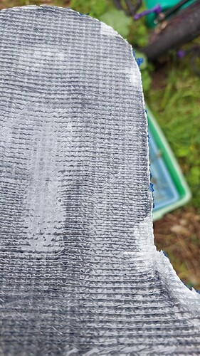

Im feeling confident enough to push on, the way the carbon has to finish on a knife edge is a killer. Nothing more sanding wont fix im sure. I got some dimond tipped jigsaw bits and started trimming the deck, pretty happy with the first 2 layers, no bubbles as such and im hoping that these little areas will be ok. It got too windy this afternoon and as im cutting outside, i didnt want let the dust blow everywhere. (Kids etc)

The light sections you’ve shown on the close up look like they may have delaminated a bit while you were cutting, or may not have been fully wet out to start with… hopefully not an issue with such heavy glass tho.

Ive still got to sand right back to apply the last carbon layer so ill be sure to give those areas a good look.

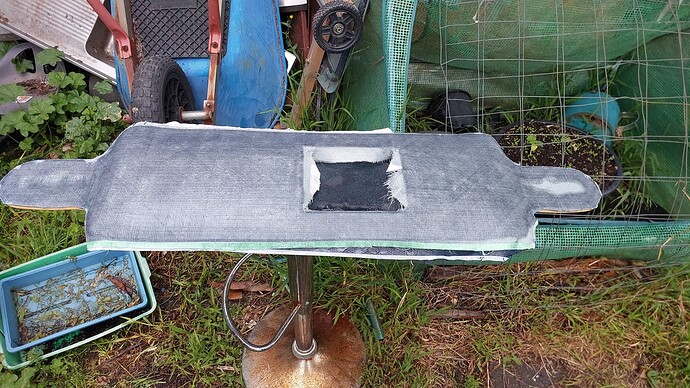

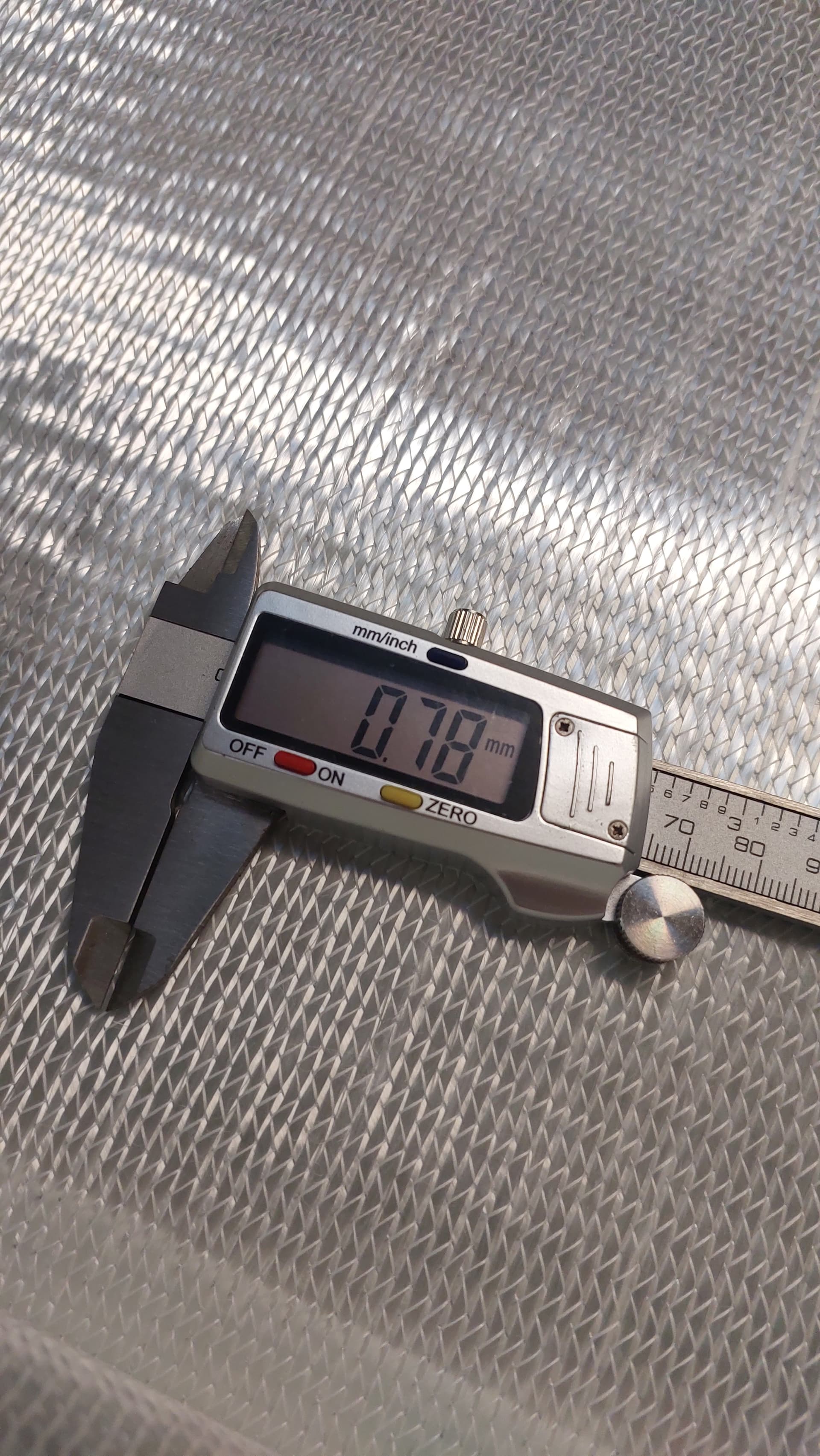

Laid a second layer of the FG Mat yesterday amd im pretty happy with it, no bubbles and it wet nicely all the way to the edge.
Its just about perfect. Today ill trim it amd do another layer. So far it has.

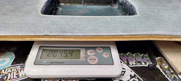

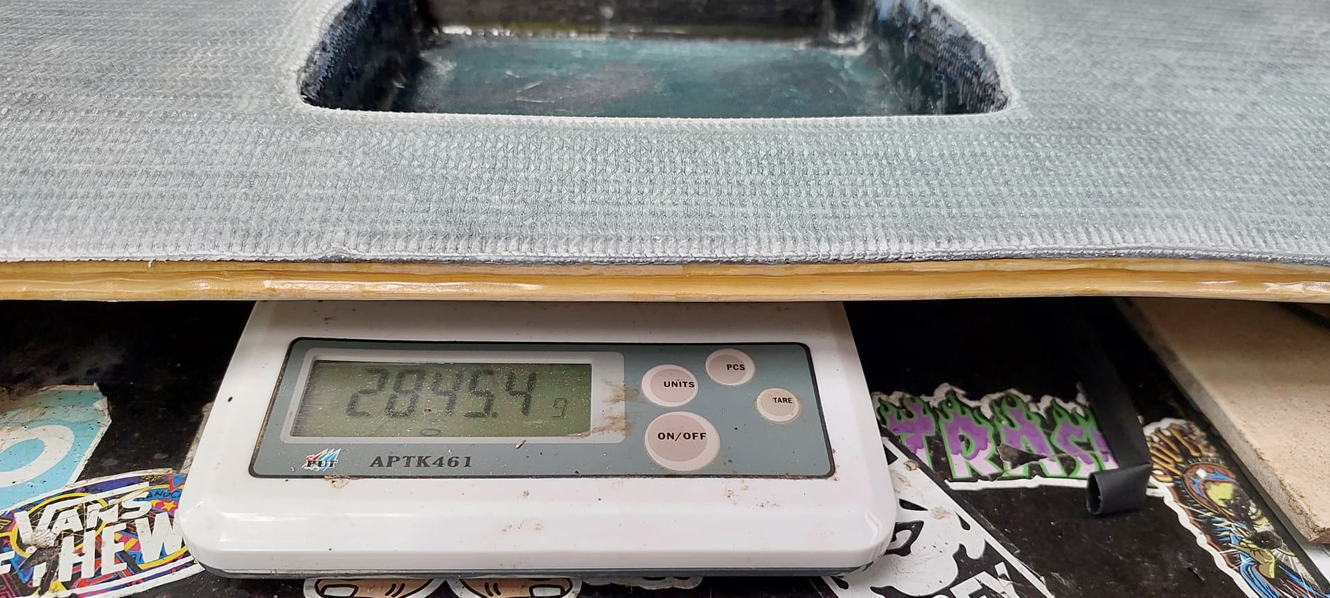

1xCF layer (300gsm)
2xlayers FG (960gsm)
Is that all on one side? That’s fuckin heaps.
I would probably be pretty happy with one carbon and glass underneath and one glass on top with that weight glass
Yeah… normally sure but theres a fukn great hole in the deck :laughing:
Yeah but you don’t need to add the weight all over. You could have done an extra layer or two of carbon around the hole if you were worried.
