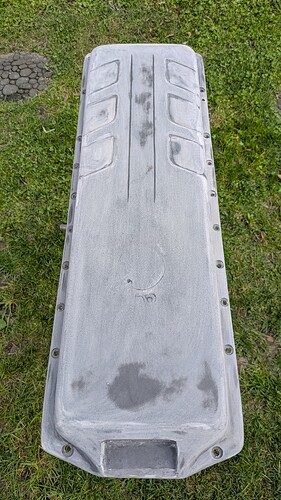

Just wasn’t happy with some of the finish peeling and well… It needed to be properly customised anyway, I was halfway with adding the cable recess and adding flanges all the way round the front and rear for a good seal so to the bottom of the hole I went.

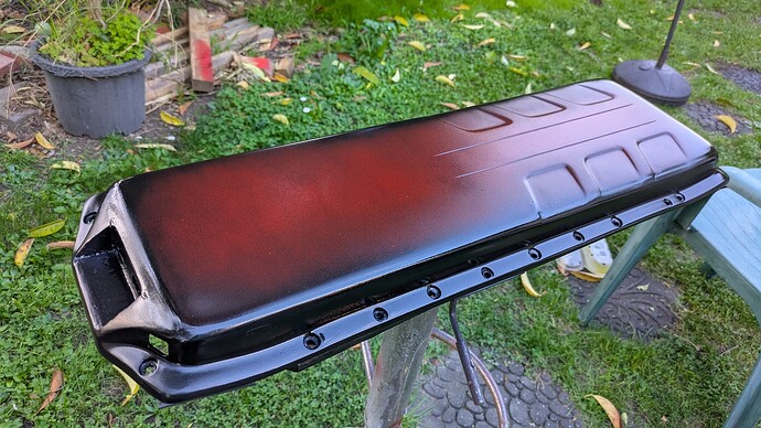

Paint it man… paint it.
I’m going to give this a little trim detail then probably a thin epoxy coat to finish it off.
Be kind, I’ve never really spray painted before.
That looks sweet!
Love the red touch. It hides blood.

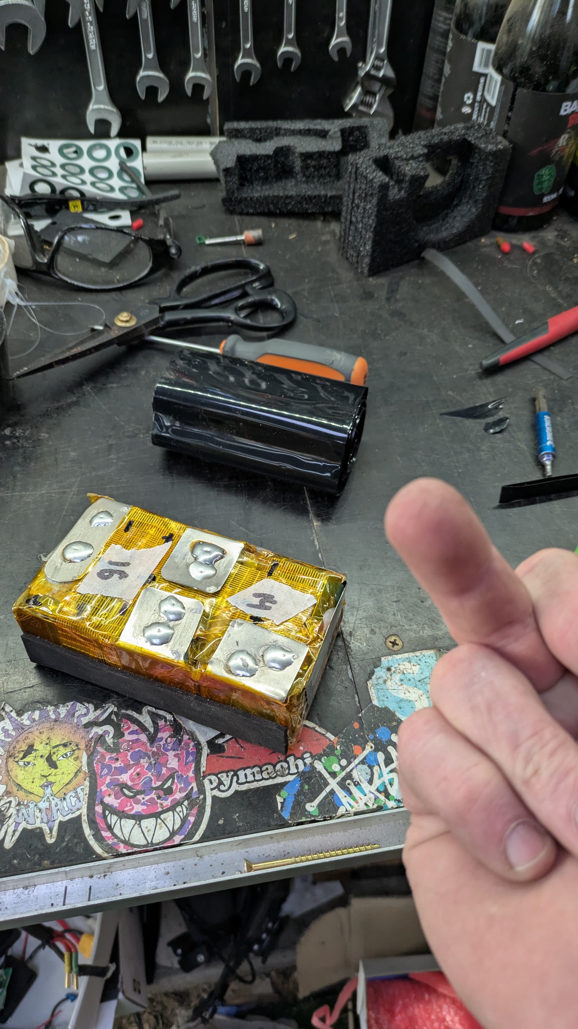

Heat shrink is somehow the wrong size… Part of me wants to order the correct size and part of me will Gaffa tape the shit out of the 2 middle packs instead.

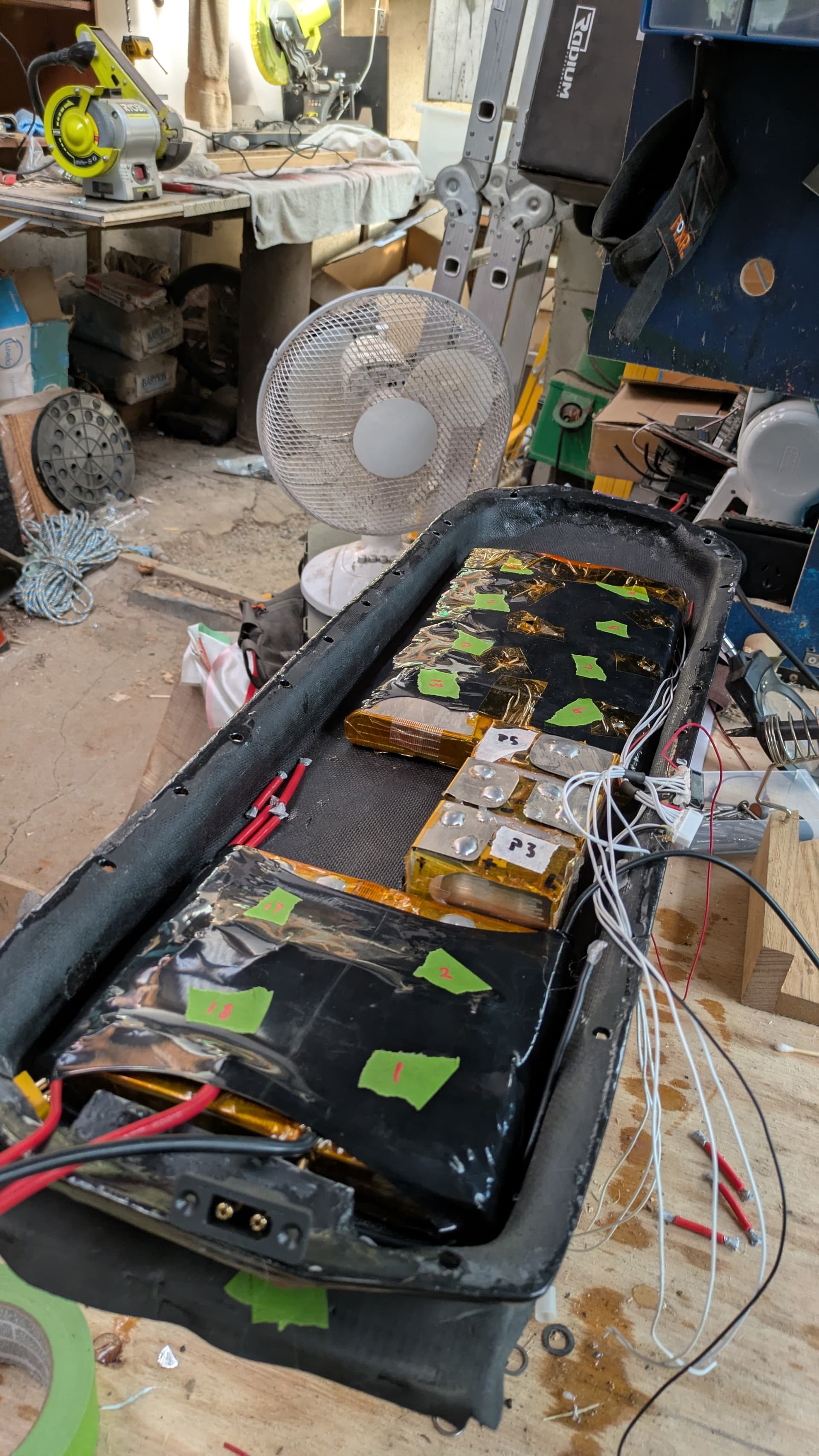

Enclosure is done awaiting terminals to be fitted. The deck also a job or 2 away.

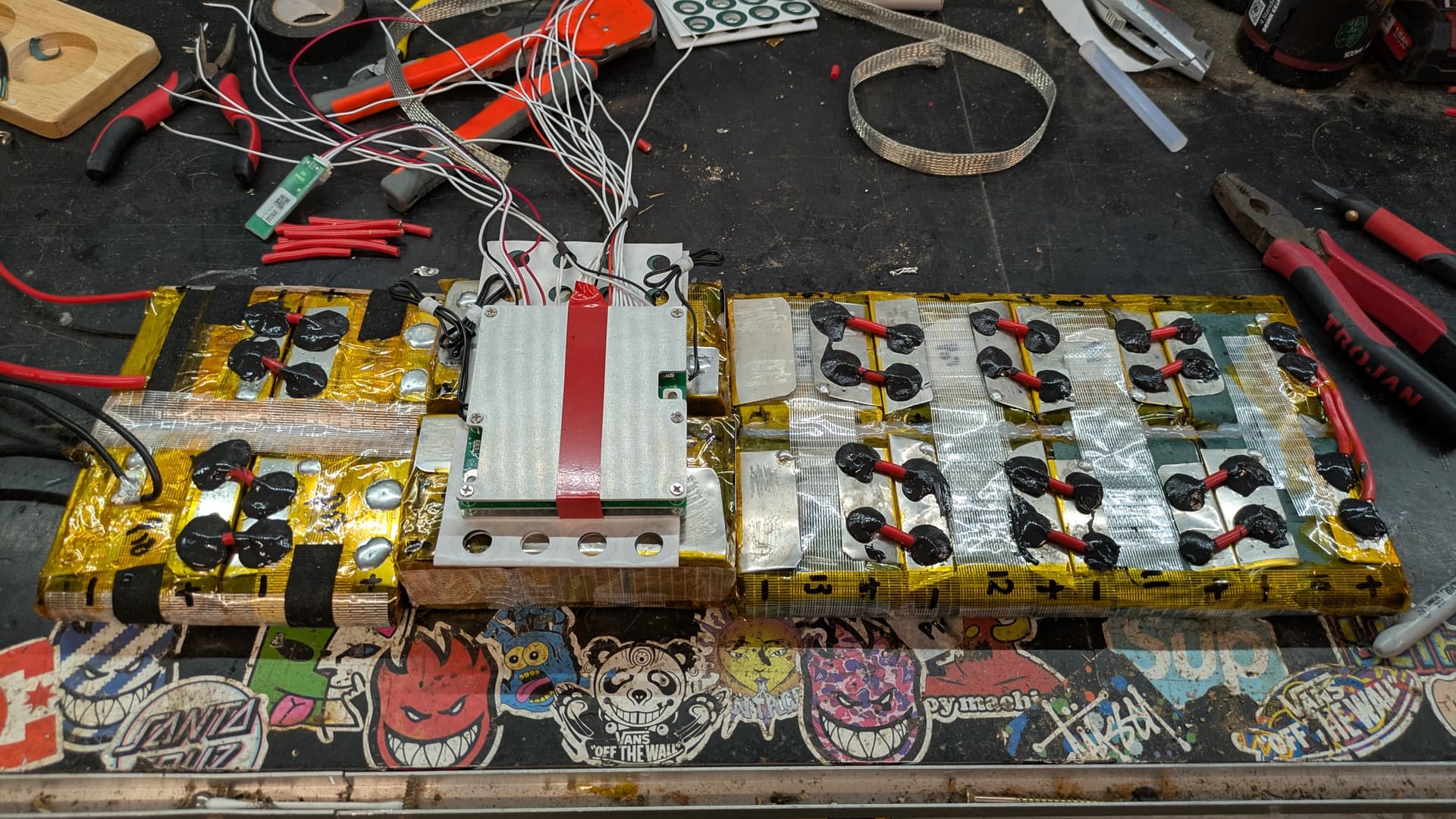

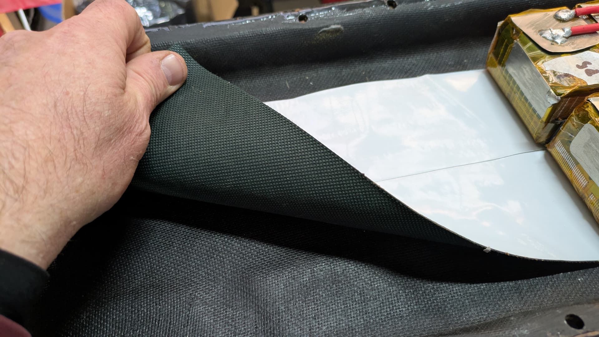

I have a solution for keeping the pack from moving apart and stressing those connections… this stuff is amazing… it’s used to stitch astro turf segments together. It’s robust as all hell, abrasion resistant and the glue will not come off anything once adhered.

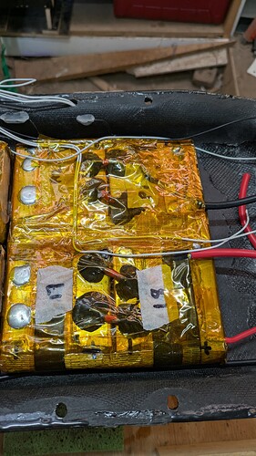

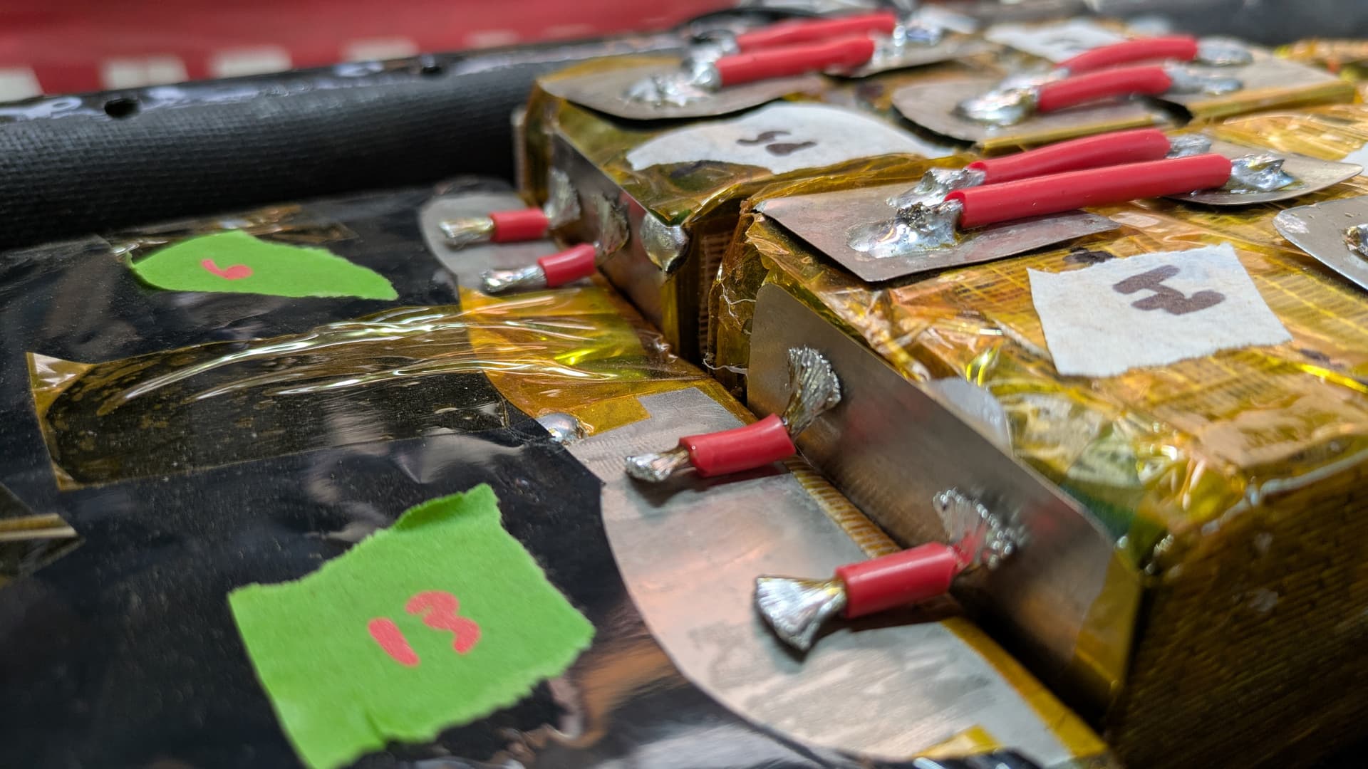

uhhhhhhhhhhh :sweat_smile: I’m probably going to regret commenting on ANYTHING about this battery build, but…
I strongly recommend using longer loops of wire, which have a lot less solder soaked into them. Those tiny segments of wire are almost certainly going to get solder wicked all the way through them, making them completely stiff and highly susceptible to breaking. Even if you somehow manage to keep the solder from soaking all the way through, the total length of un-soaked copper strands is very small, meaning any flex is going to be seriously concentrated in those tiny segments.
Use 3x or 4x the length for each wire, and angle the solder joints so that the wire loops around in a relaxed position rather than trying to make right-angles from that vertical surface. It will be easier to make, easier to solder, easier to service in the future if needed, and much less prone to breaking.
Noted, I can get about 2-3 that length with some flex in a different way. Will do.
Ty
