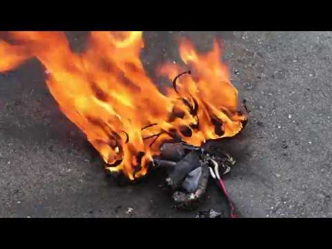

And if it wasn’t already clear,
GET THAT BATTERY OUT OF YOUR HOUSE AND AWAY FROM ANYTHING FLAMMABLE.
Here’s why:
(esk8 sized battery explosion)
(Approximately 5-10wh battery ~1/100 the size of a “normal” esk8 battery)
(Big esk8 battery)
(Not sure of pack size)
Edit: I don’t intend to fear monger at all, and I hope this doesn’t come off that way. I just think it’s important that everybody understands the risks we all take when using and handling lithium batteries.
