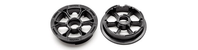

Couldn’t help but think through this a bit. If you’d take some constructive feedback -
you may look to adding a locating feature to match the two sides together. Fasteners will work in a pinch, but they are not ideal for this - they clamp, they don’t locate well. Especially since fasteners themselves are not precision parts - its not ideal to put them in precision holes.
MBS and Trampa both have this sort of locating feature on some of their hubs. An extrusion on one side, matching a recess on the other:
One other thing, @Savage1 can def speak to this better than i can, but you may increase the height of the left part (w/ bearing seat) to match the sidewall height to the top of the bearing seat. And decrease the same amount from the right part. This would mean your overall raw material size is a bit less. Same end result, just moves your ‘parting line’ over. Maybe save a few dollars

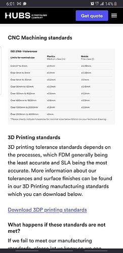

Absolutely true. Mainly, i was talking about the absolute lowest cost online shops with instant quote engines. These places (for the most part) farm the jobs out to a whole network of 3rd party machinists and can’t/don’t always guarantee tight tols without fees.
For example, Hubs.com overseas option is about an budget as you can get (unless you have a friend):
22mm bearing seat would have a ±0.1mm tol default, which is usable but not ideal.
