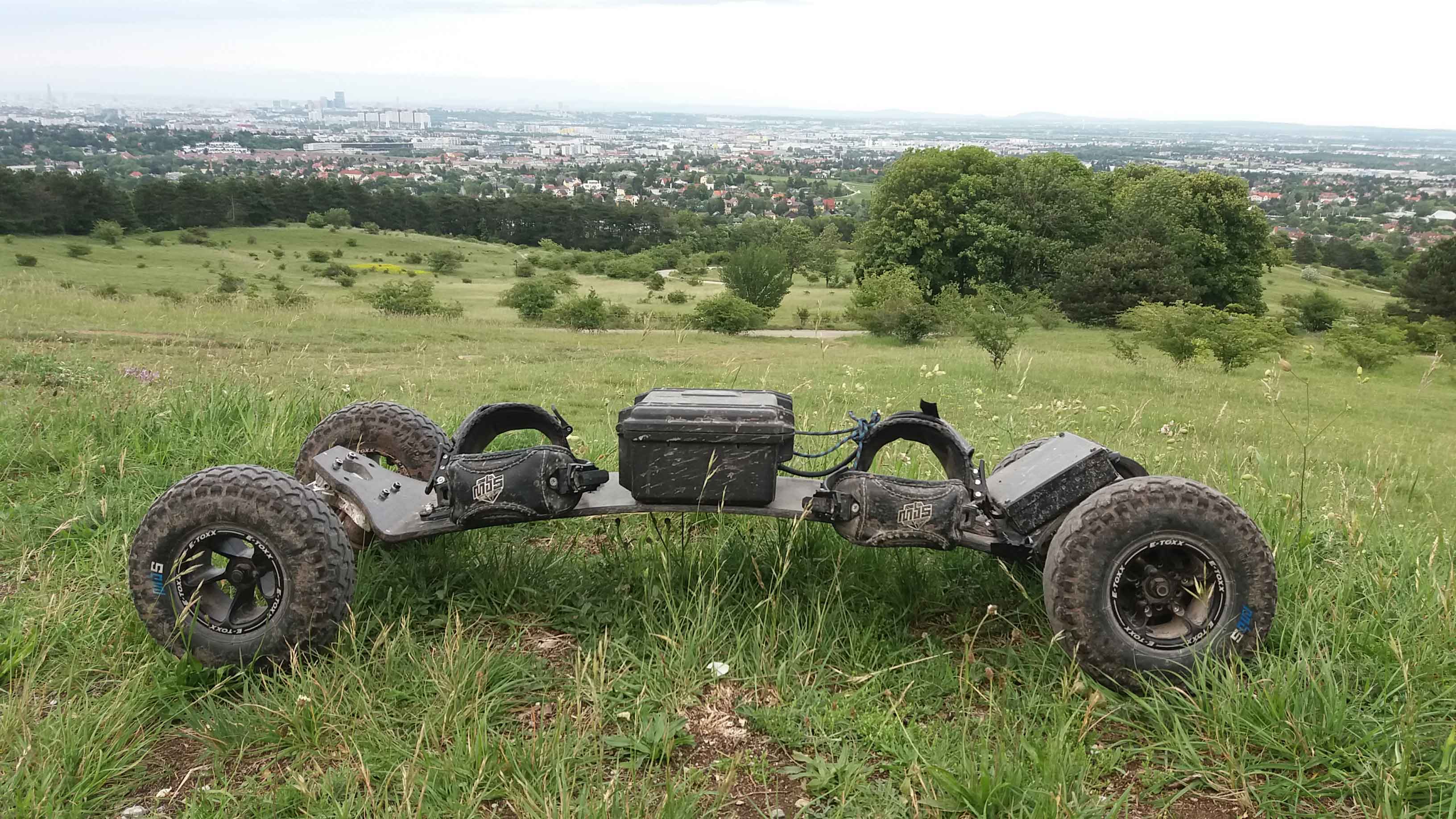

I had another ride in the same area and a lot of fun. I have no car so normally it is quite difficult for me to visit other places by bus or train with the board plus gear, too bulky and heavy. I borrowed a car so after work I could ride in a part of the vienna woods just 15-20 minutes away.
The jungle (for me as city kid :laughing:) starts here, in the background you see vienna.
Deeper in the jungle
Last year I was riding there with 8" tires and it was a bit frustrating because of too less ground clearance hitting roots and stones all the time. With 9" it’s much better but still not enough for hardcore terrain. I mean at least 20"-26" would be perfect :joy:

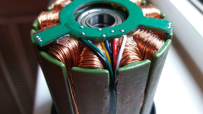

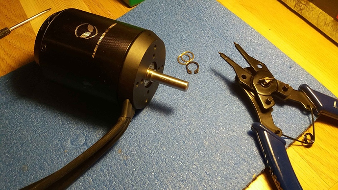

Small update, since may I’m waiting for a replacement rotor from APS for the smashed 6384V2 in vain. Before my hair get grey I need a different solution and saw one motor here for sale and bought it.
No crazy sounds, no rusty stator :ok_hand:
Ready for battle hardening and silicone on hall sensor PCB
extra safety for the wires
Glued helicals with Loctite 648
Just need to solder extension wires and then should be ready to ride again on wednesday.
One thing I don’t understand, Bruno says this motors have no temp sensors (which is baaaaaad) but why the temp sensor wire is on the connector and even soldered to the PCB? :thinking:
Maybe the sensor cables they produce/buy come with all 6 wires but the temp sensor on the PCB isn’t populated, so they just connect it to keep it from having to be cut out or flopping around.

I have seen that before on different motors. The pcb might come like that from a sub supplier and asking for the temp sensor get populated will add cost. When I asked for motors in China they usually add 5-10$ for the temp sensor only.
If you find the right temp sensor on mouser for example you could add one by your own.
(Don’t ask me which one :joy: I did know it once, but forgot it again :man_facepalming:)

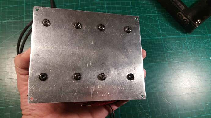

I’m so ready to ride but need to fix the vesc enclosure first. Unfortunately both Vesc 6 regularly overheat which sucks. That’s why I thought about to mount them upside down on an aluminium plate for better heat dissipation.
I wanted a full alu enclosure but have no time and also am concerned about problems with the remote receiver which is in there, too. So I planned to use the ABS enclosure which I had like this for now.
BTW I love those grommets which I use since years.
The bore hole in the enclosure is 20mm and you can cut the grommet as you want. I made slices as well to feed through the sensor connectors. One grommet is for 3 phase wires and the sensor wires. The rubber is strong but flexible. I was riding many times in rain or hard rain and had no water ingress (with ABS lid of course not like in the pic :joy:).
So I prefer to have all connectors inside the enclosure which leads me to my new problem. It is impossible to connect the phase and sensor wires when the vescs are upside down. I’m trying since 2 days and cursed a lot. I gave up and will mount the plate upside down without any enclosure, just need to find some shock absorbing stand-offs like small bushings. I want to ride tomorrow. If it rains I’m in trouble but at least the overheating issue should be gone for sure.
