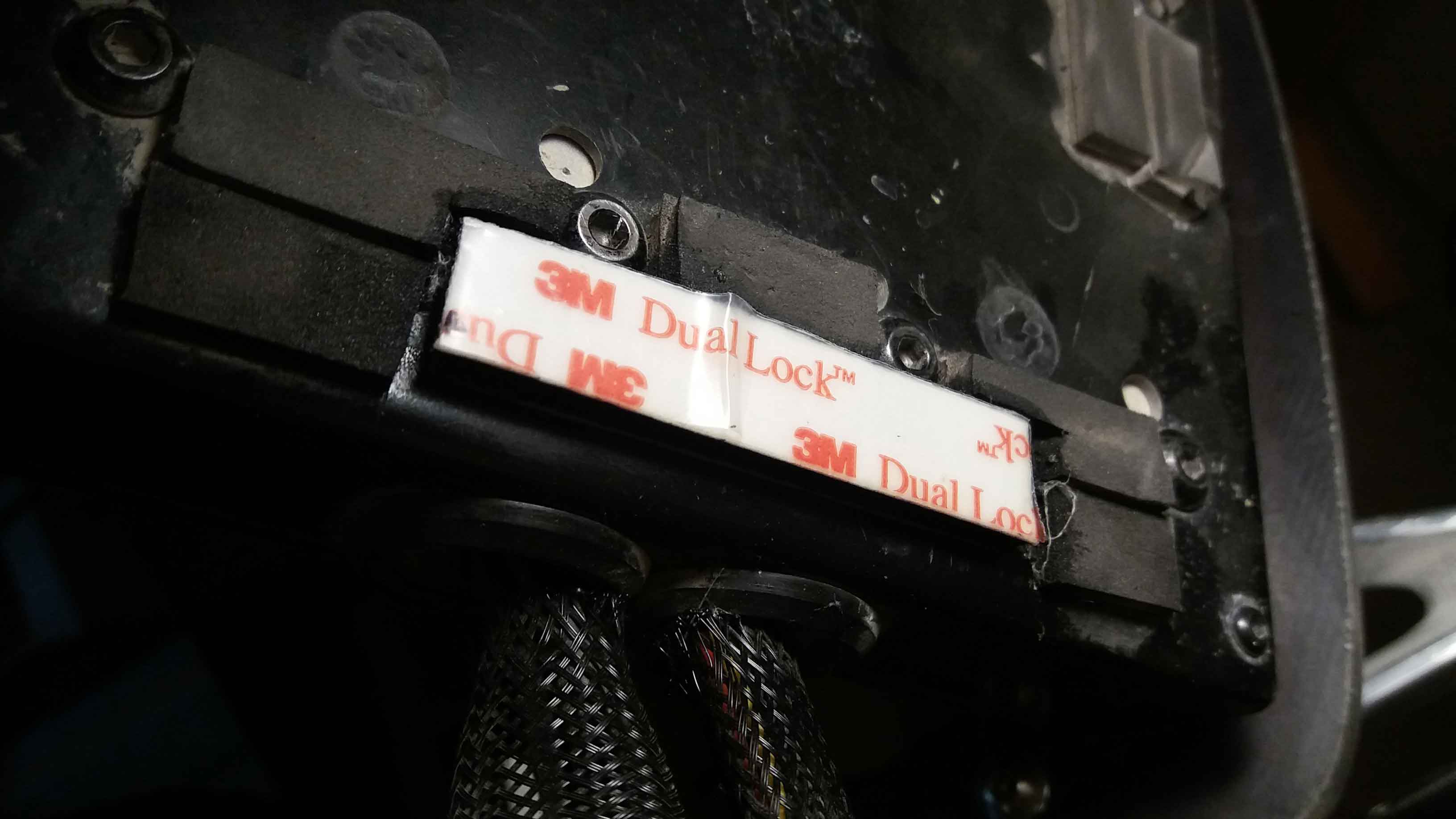

Weird is that the velcro which I used on the vesc enclosure doesn’t work anymore, there is no more function. It’s 1 day old, spooky. The same velcro on the battery holds very good to my surprise.
I swapped to 3M duallock and no more problems.
In general I don’t recommend duallock because it can’t withstand vibrations. It’s much stronger than velcro and doesn’t wiggle like velcro, locked is locked. I use duallock for the light on my commuter. With pneumatics it holds like a champ but with urethane it pops off on every crack.
You have me concerned about the motors! I have a pair of the 170kv on my board that I haven’t ran yet… I don’t have any loose shafts or anything, what other issues do you have with them?
Same experience here with Dual-Lock. :joy:

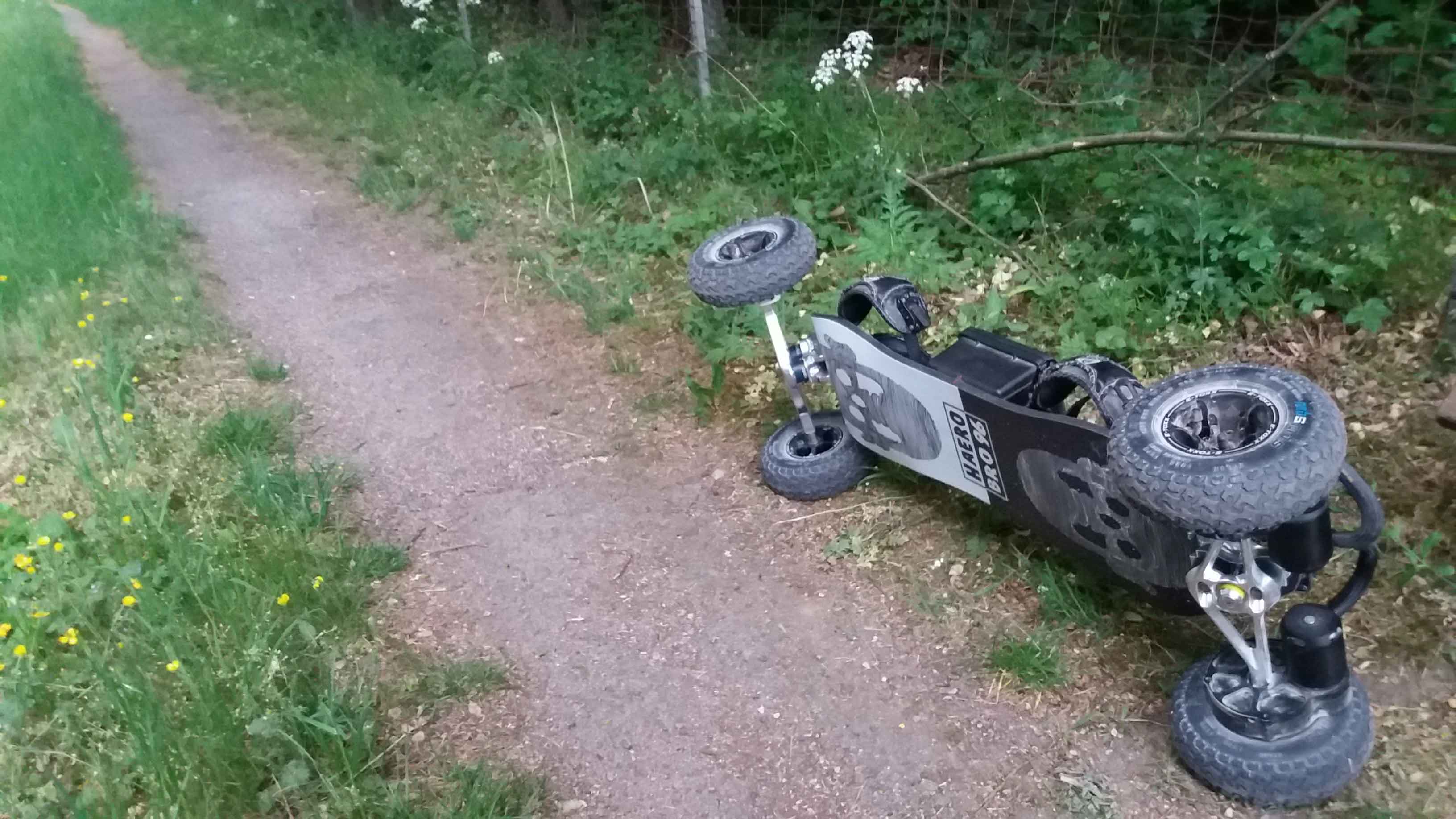

Yesterday I had a great ride after work out of town but it started as a nightmare. When I started to ride I recognized the brakes were not working. When going in reverse the brake (throttle) also didn’t work. WTF! Unloaded it worked but not weighted. I switched everything on and off several times and checked all wires and connections but still no brakes. After some minutes it worked as usual :thinking: I was riding in a hilly area so no brakes could be deadly. Fortunately the board performed flawlessly but it took a while until I could trust the brakes.
If anyone has an idea what the root could be please tell me.

NRF remote?
BTW majestic scenery
Yeah the Wand (with new PCB).
The only thing is that if it was the remote then why the brakes worked unweighted only? That’s confusing. Also sometimes there are hard cutoffs during hardcore acceleration but not on every ride, maybe every 5th ride.
Try updating the dongle.
There is an issue when you also have your phone connected to it due to an android update.
Maybe I should downgrade the dongle :thinking:. I did an update once but can’t remember which FW it was. Actually I’m running FW3.65 because I don’t trust faulty FW4 and also FW5 (without trying it but I read a lot of problems so I’m not motivated to try).
