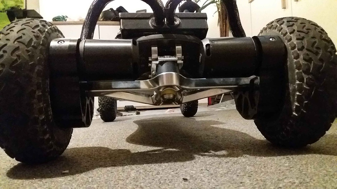

Was looking at the hanger and not sure if I like this.
The kingpin is not protected by the rest of the hanger. Same with the bushing. I don’t worry about riding with it on easy terrain, but with a lot of stones in the way it seams to be a weak spot.

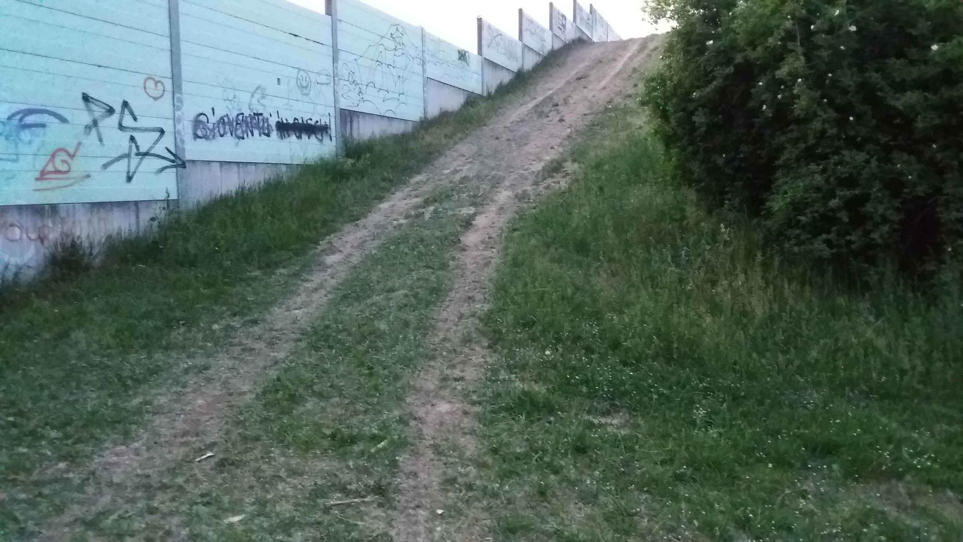

The motors… beside the fact that they make strange noises and the wobbly one starts to vibrate at higher speed I like them :joy: There is one special incline where I always test hill climbing ability of different setups, it is about 25° steep which is quite crazy.
I could climb the hill easily from standstill. During the climb I could accelerate quite crazy and ride faster . The third time I gave too much throttle and the front wheels lifted almost on the top, that was fun. I really love the 1: 6.25 gearing even with 9", crazy torque. With the former 6374 220kv i could climb this hill as well from standstill but not increase the speed.
Just for comparison, with 1:5 gearing on 8" and 6374 motors it is impossible to climb the hill from standstill. It needs quite a lot speed to be able to climb it and then the question was always if I make it to the top because you slow down and can’t accelerate any further.
Well and what’s on top of the hill? This :point_down:

I have to say that the kinpin is not tightened at all in this pic that’s why it looks like this. Tightened the kingpin is a bit above the edge of the truck and the bushing is safe.
Of course it can be hit by objects but I don’t worry too much. I can’t go into details but I doubt the kingpin can be bent even when I would hit it. If I would post some disassembled pics you would know why but I can’t. But what I can do is to hit it several times which will happen anyway and report back :grin:

With the kingpin tightened down it looks way better. Still worry a bit that stones will hit the screw and damage the hole for the Allen key to the grade that it’s not possible to tighten/loosen the kingpin.

Valid point but the kingpin is so huge that I don’t even have the allen key for it but found a bit, it’s 6mm
For comparison on the left side 4mm what we use for M8 set screws e.g. on motor mounts :sweat_smile:
The hangers I have are 300mm (the smaller ones) I haven’t measure the axle length but they are longer than MBS maybe like Trampa or even longer. The axles are so accurate that the wheels (or washers) don’t wiggle on the axle (without axle nut) which is a new experience for me.
The max width of mounted wheels is about the same (a bit more) as Matrix II trucks with E-Toxx axle extensions or with offset hubs but you could mount them more narrow than on Matrix II.
