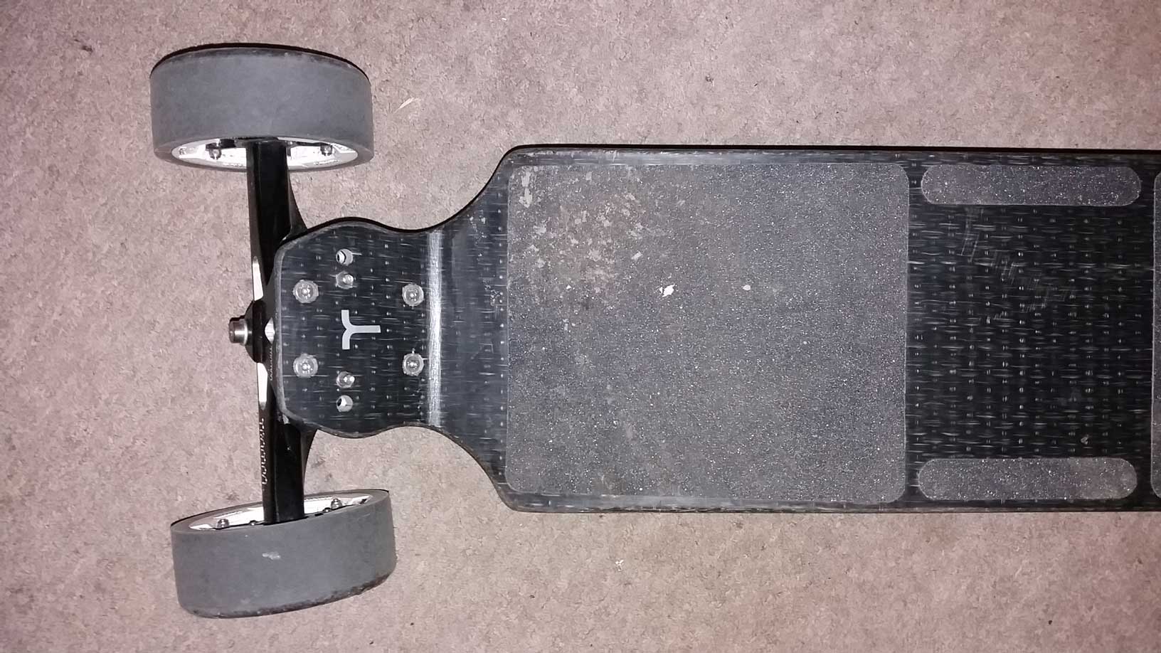

I received E-Toxx trucks for testing and they are definitely not from this planet, I’m speechless, they are sexy AF :heart_eyes:
Jesus christ @NoWind @Duffman the real kings of esk8 porn :kissing_heart:
I mounted the front truck and it feels great (in socks without bindings) compared to Matrix II, very smooth, can’t wait to ride!

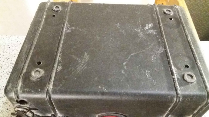

I really want a new enclosure for the battery, the Pelicase is so big compared to what’s inside
I plan a smaller enclosure like @Pedrodemio recently did, I like it a lot, also the pocket is great. :point_down:
pe
I decided to keep the Pelicase for now because I want to ride ASAP. The first time I’m going with velcro but I don’t trust it, hope it holds.
I had to make the bottom flat
Final sanding and it’s totally flat, next I have to stick velcro to it.

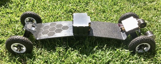

1 hour ago I’ve mounted the motor plates. I was really enjoying the accurate square shape of the hangers, mounting was so easy. For helicals with 29mm distance to motor plate I use 3mm ABS sheets (2mm+1mm). I mount the wheel helical and wheel, tighten the axle nut and push the motor plate against the ABS sheets/helical and tighten the set screws. So easy and saves much time.
Then I recognized I forgot to use epoxy putty on the wires of the motors outside. Added a bit now I have to wait a little bit more then I can mount the motors and finish installing the drivetrain.
Meanwhile I cut 25mm aluminium spacers for the front truck to keep the raw look. I do it old school
I did that often but usually I mark the tube where to cut it but this time I used a sliding caliper and could exactly measure and adjust the distance from the end of the tube to the saw blade.
Damn that’s accurate :partying_face:
This night gonna be looooong my aim is to ride tomorrow and there is much more to do.
