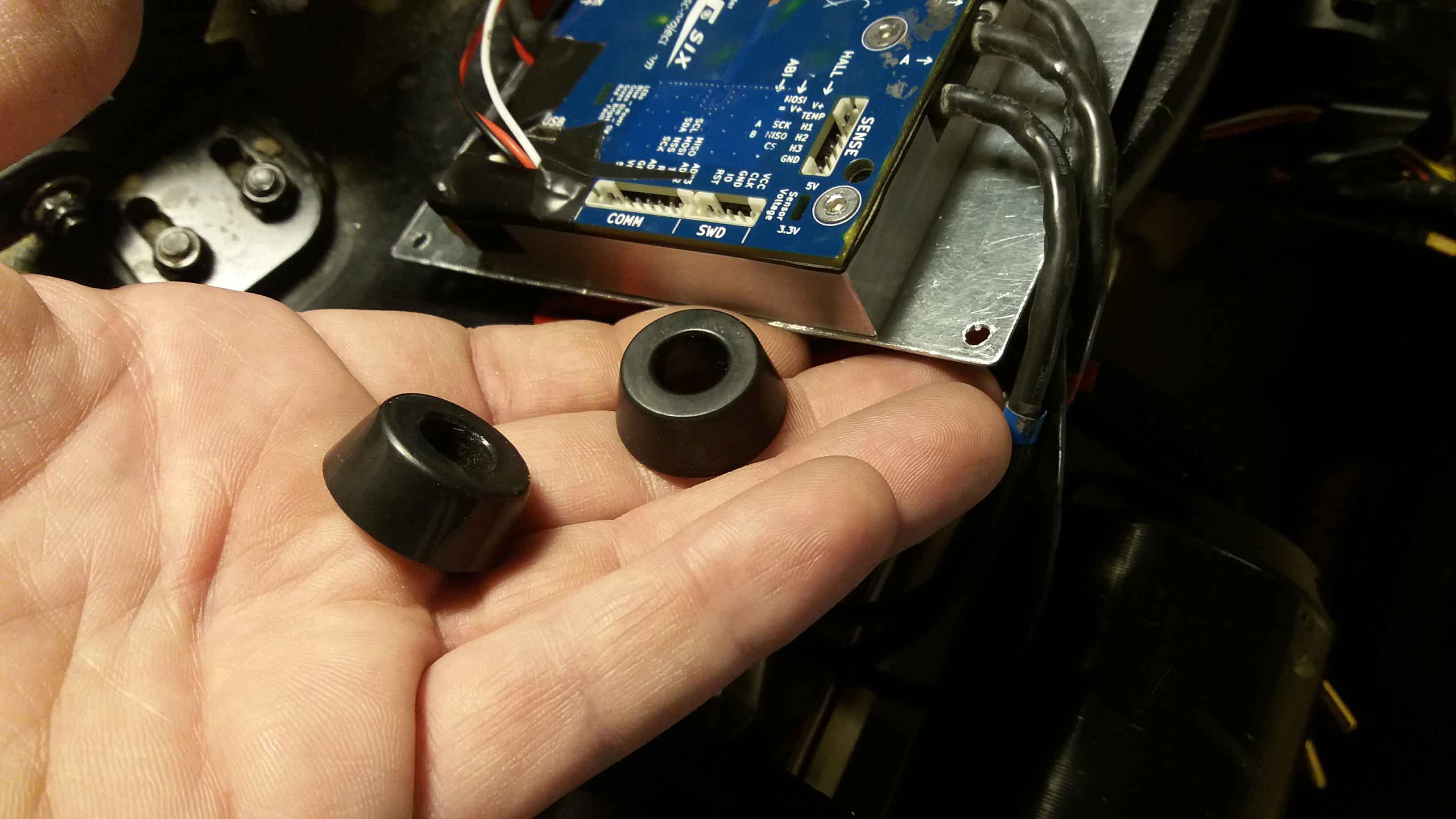

They are available in many sizes and variations. I ordered the EPDM version (link above) but not sure if they sent me silicone. I know EPDM foam but not just EPDM. My grommets feel like rubber or silicone.

Used some bushings from penny trucks as stand-offs

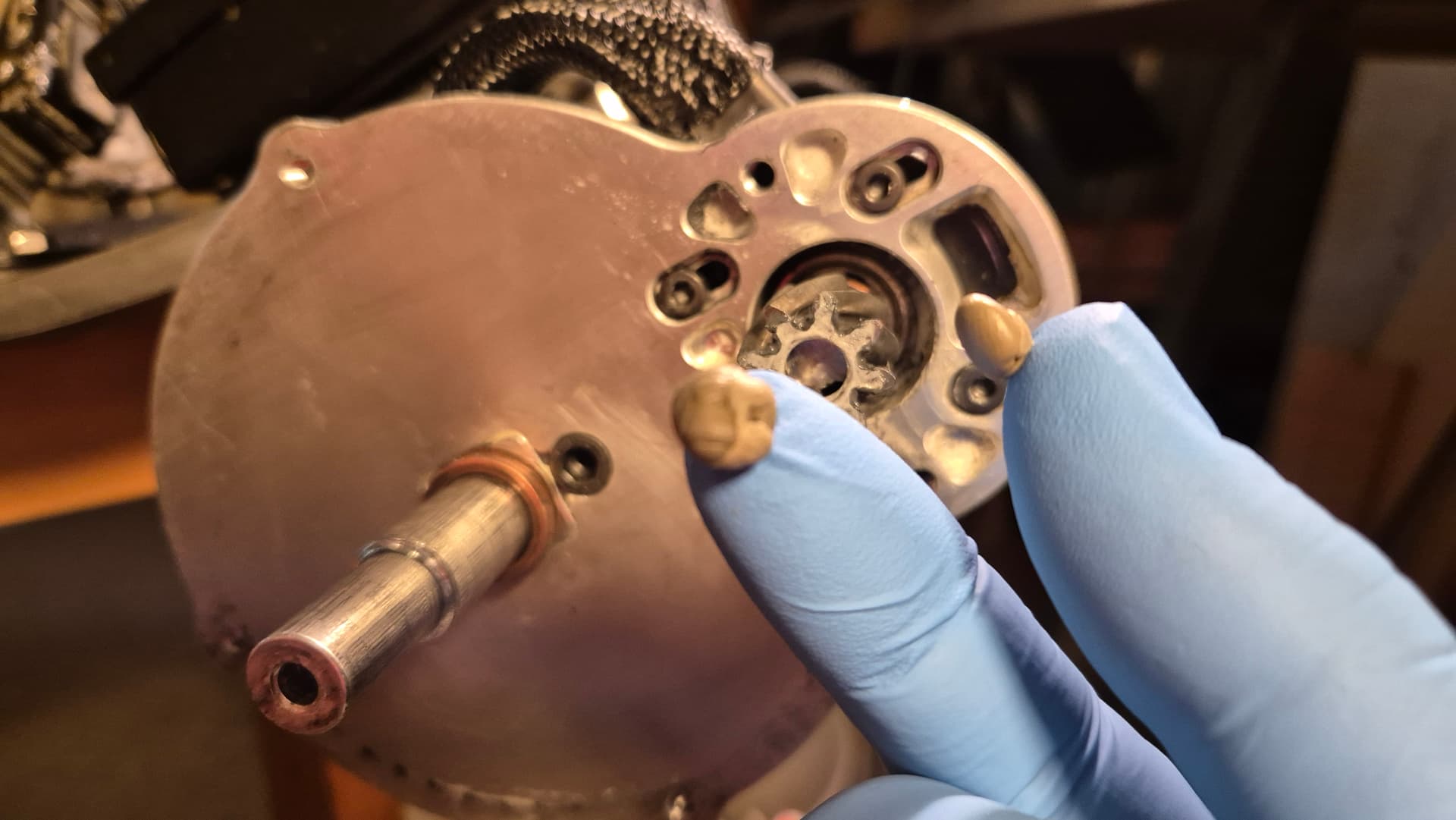

Because both motors had loose windings, I had to glue them.
There are small gaps on the motor plate where debris can enter, It’s easy to spot with backlight
I sealed it with butyl tape

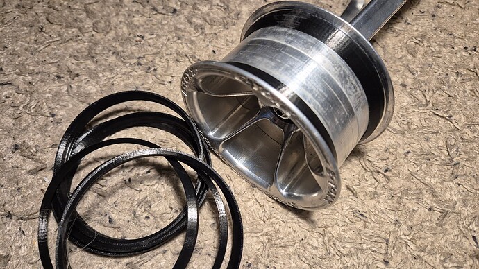

I received adapter rings today, with these 9 inch tires have a perfect fit, run true and you can use lower pressure. In my next accident, the tires won’t slip anymore
