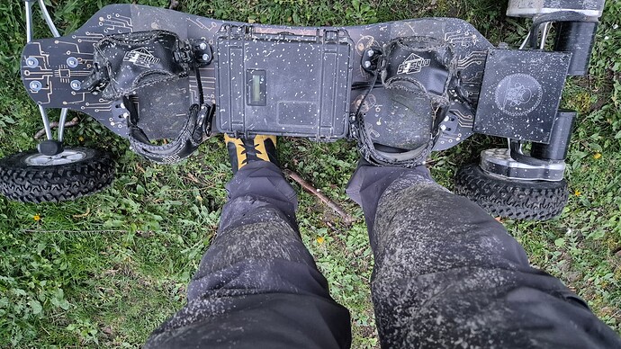

I decreased the tire pressure from 2 bar (30psi) to 1.5 bar (20psi) and it feels waaaaaaaay better in off-road conditions, really nice with the rigid mud pluggers.
agree - 20 psi on 9" mudpluggers riding offroad is something special
After a few rides I have to say this is the best setup I’ve ever had :star_struck:
Shredding in the woods
I’ve also been to the bike park and ridden the flow trail and it’s never worked as well as it did this time.
But I had quite a few problems with the remote control (which I had in the past as well). Several times the VX1 disconnected in the woods, thank God I didn’t die! Only after turning off and turning on the remote control again was the connection back, I guess I have to replace it. The other 2 VX1 remotes I use on other boards have no such problems.
But what scared me even more was that the anti spark switch turned off during riding, this has never happened before. Fortunately the bindings saved me from face planting, it happened during heavy acceleration. The physical switch on the outside of the enclosure has turned off due to vibrations I guess.

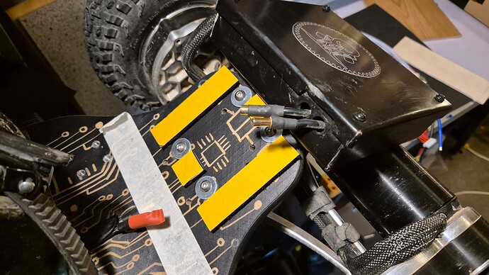

The velcro strips have become loose after a short time and the whole case wobbles back and forth like crazy, this could be the reason for the problem with the on/off switch. Actually, I wanted to bolt the enclosure to the deck, but unfortunately this is not possible because there is no space at all inside the enclosure.
I have it now with double-sided adhesive EPDM foam fixed to the deck and so far nothing moves.

I glued 1mm thick foam strips because it was way too slippery

Don’t worry, the problem was the receiver and my fault. The lid of the enclosure was touching the wires and bent them, after some time I had regularly full throttle sensations. If you don’t bend and stress the wires that shouldn’t happen. Second I had cut outs every time when heavy vibrations occured (e.g. curbs). After wrapping the receiver in soft foam, this never happened again.

Unfortunately, the case for the Vescs doesn’t hold up and I have to come up with more creative solutions like gaffa tape or zip ties because I don’t have any more glue material left.
