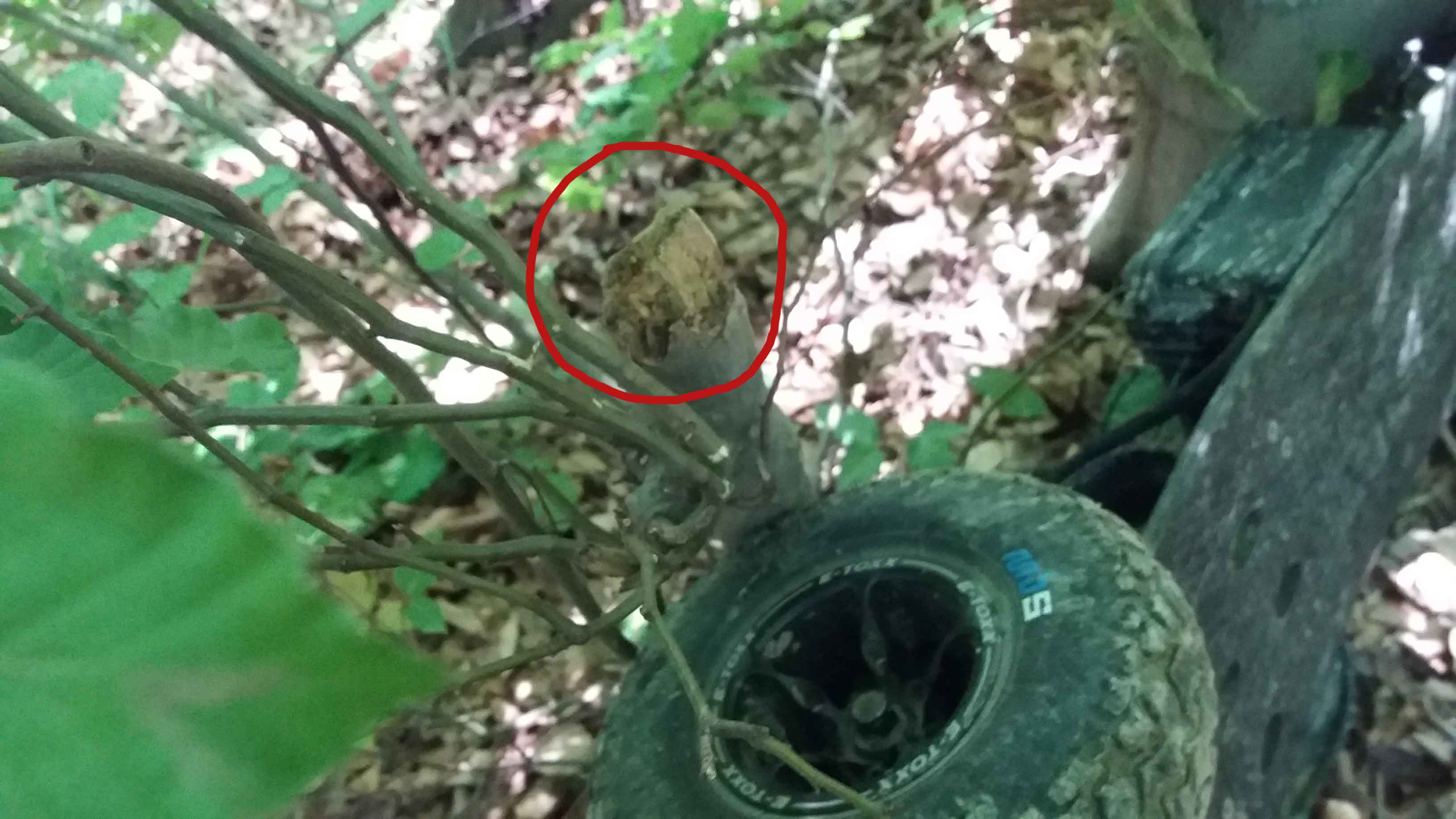

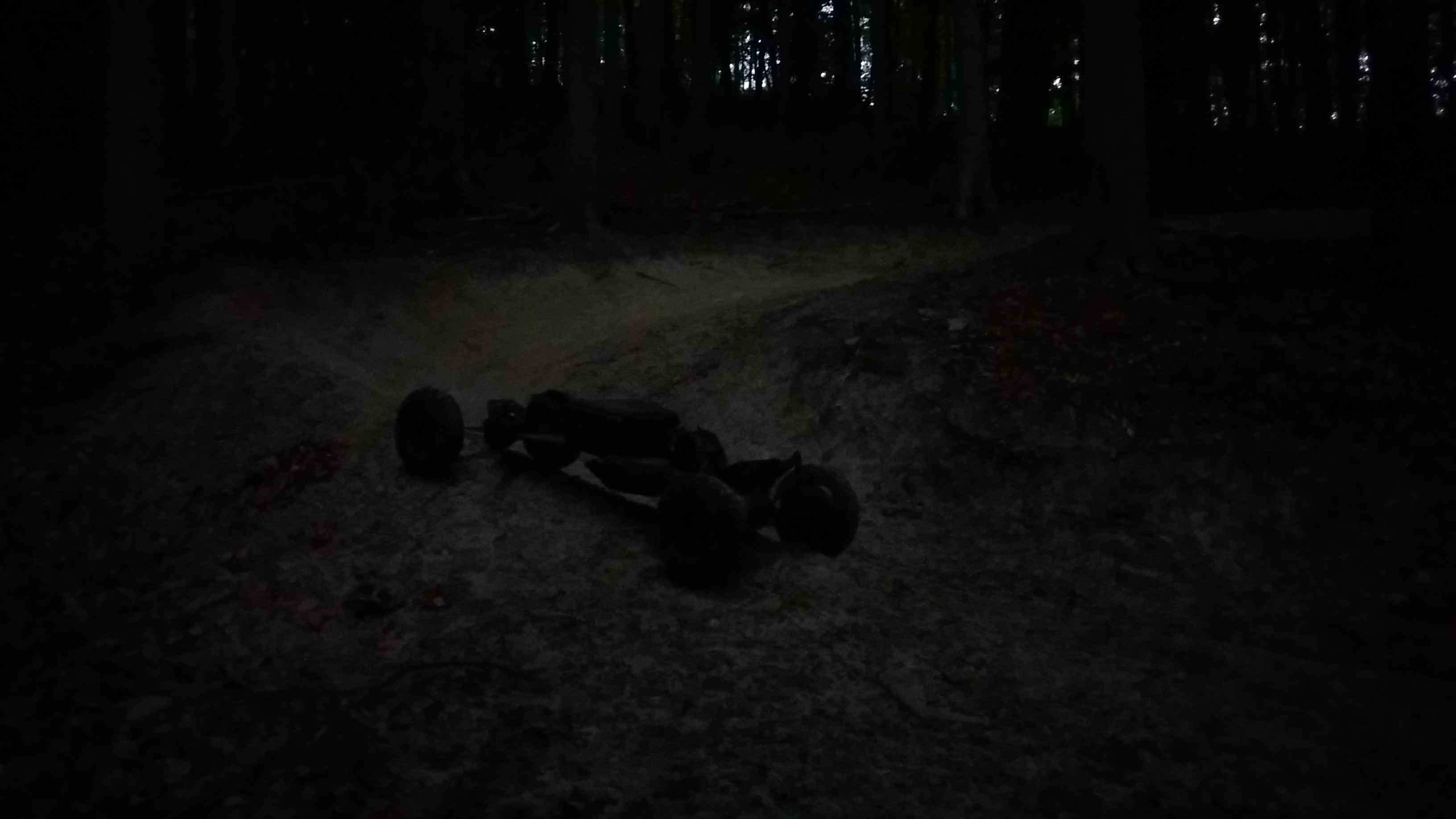

This time I knew the trail and did ride a bit faster with carvy trucks, not the best idea. In a berm I was leaning to much and due too loose trucks the board bent over and at the same time I was falling down the hill. Well I overran my left thumb and then the whole hand with the front wheel which felt stupid but the pain was gone after some minutes.
Then I was really lucky when I fell, skatan saved me from this trees. I couldn’t believe nothing happened here.
The small snapped trunk was even more dangerous than the big tree
This and more crashes happened on the first ride so I decided to tighten the trucks for better stability. It helped and felt better. The thing in general is that when you ride berms you need some speed and lean for the tight curves otherwise you lose balance and fall. Loose trucks make it worse, some light berms are easier to ride at slow speed but that’s no solution. It’s better to lift the front and correct the position if the curve is too tight. This works much better with stiffer decks (without pushing down). The Trampa deck is like a trampoline but often there was no time to push it down and so it felt like pudding and hard to control.

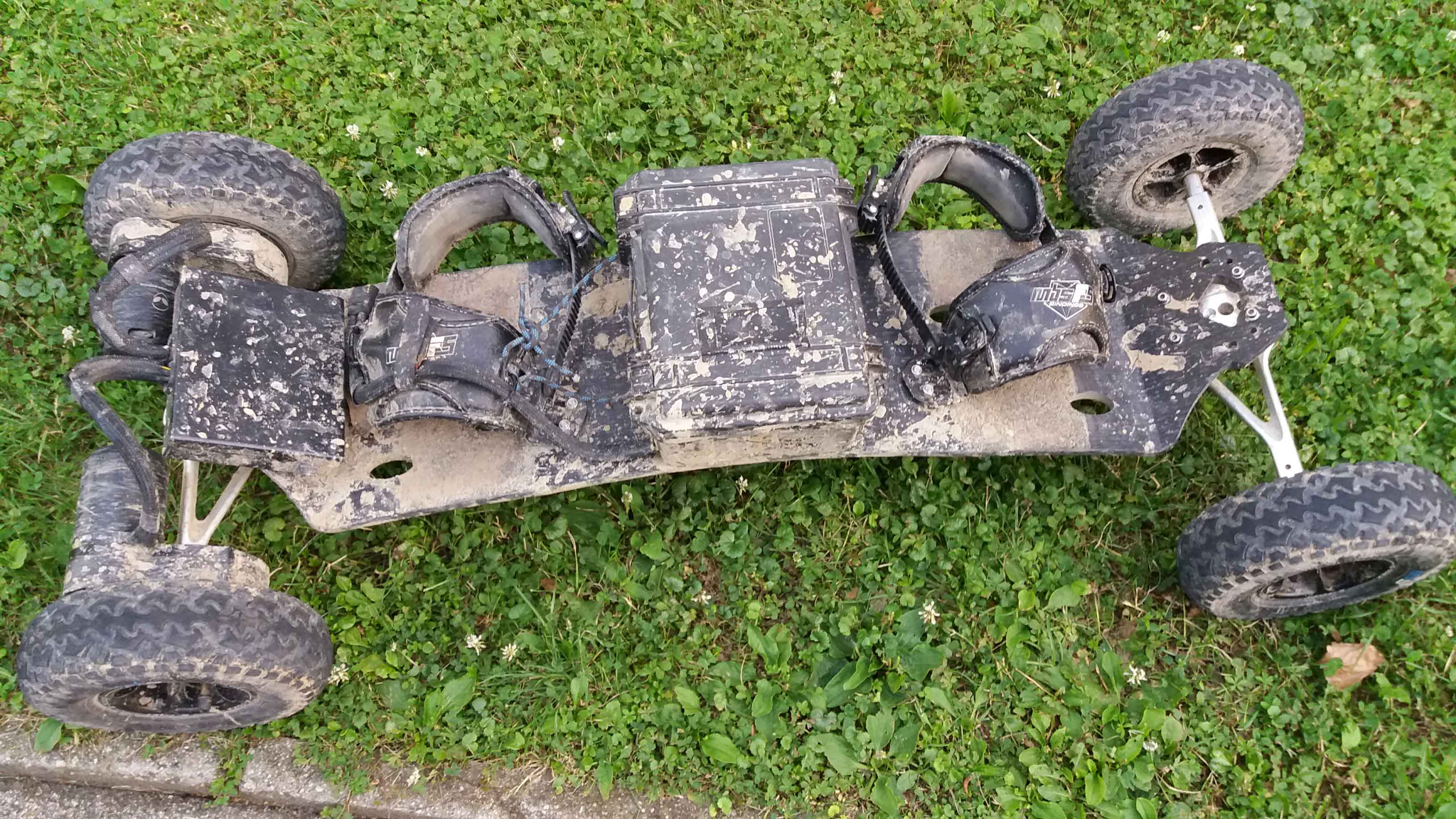

It was a bit muddy as you can see

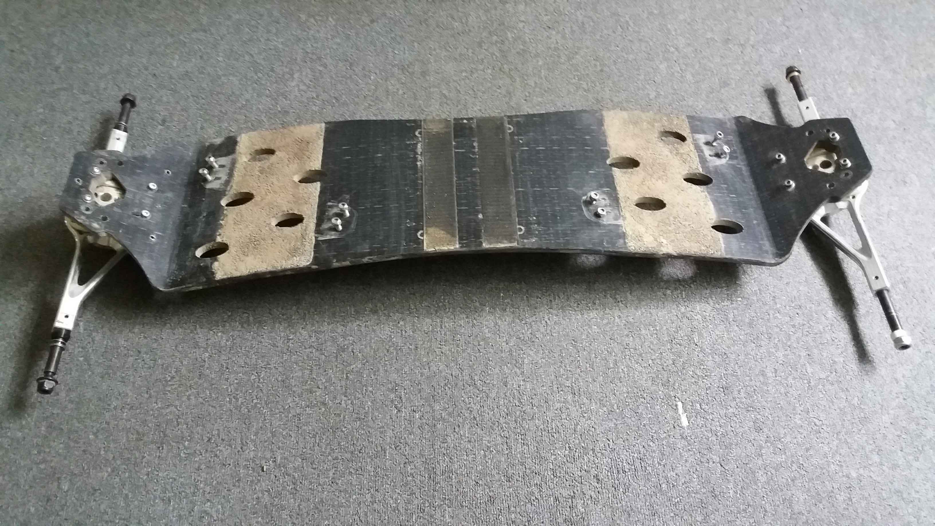

As mentioned earlier I want to visit more bike parks this month and therefore I need to change the setup.

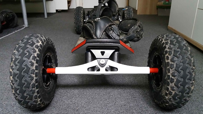

Switching to MBS DWII deck and Trampa vertigo trucks with E-Toxx elastomere dampers. I think this setup could work well on trails I’m very curious. Still some work to do but should be finished within the next days.
That mean those nice etoxx trucks going spare? :wink:
Yeah collecting dust :joy:
Joking aside, I just want to try and compare different setups especially for bike park riding.
Matrix II trucks with DWII deck works fine but wanted to test it with vertigos. The advantage of the elastomere dampers is that there is stability plus tight cornering is possible.
The E-Toxx trucks are from another planet and feel different to any other truck I’ve had. It’s hard to explain they are very smooth, carving on concrete feels like deep snow. Due to the position of the bushings the resistance when turning feels very linear which is unique. With soft bushings and slightly tightened kingpin they are so carvy that the motors gonna shave the deck.
Funny is that I bought the DWII deck for jumping and the Bro for replacing the Trampa deck. I like the Bro more for jumping and the DWII felt good on narrow trails.

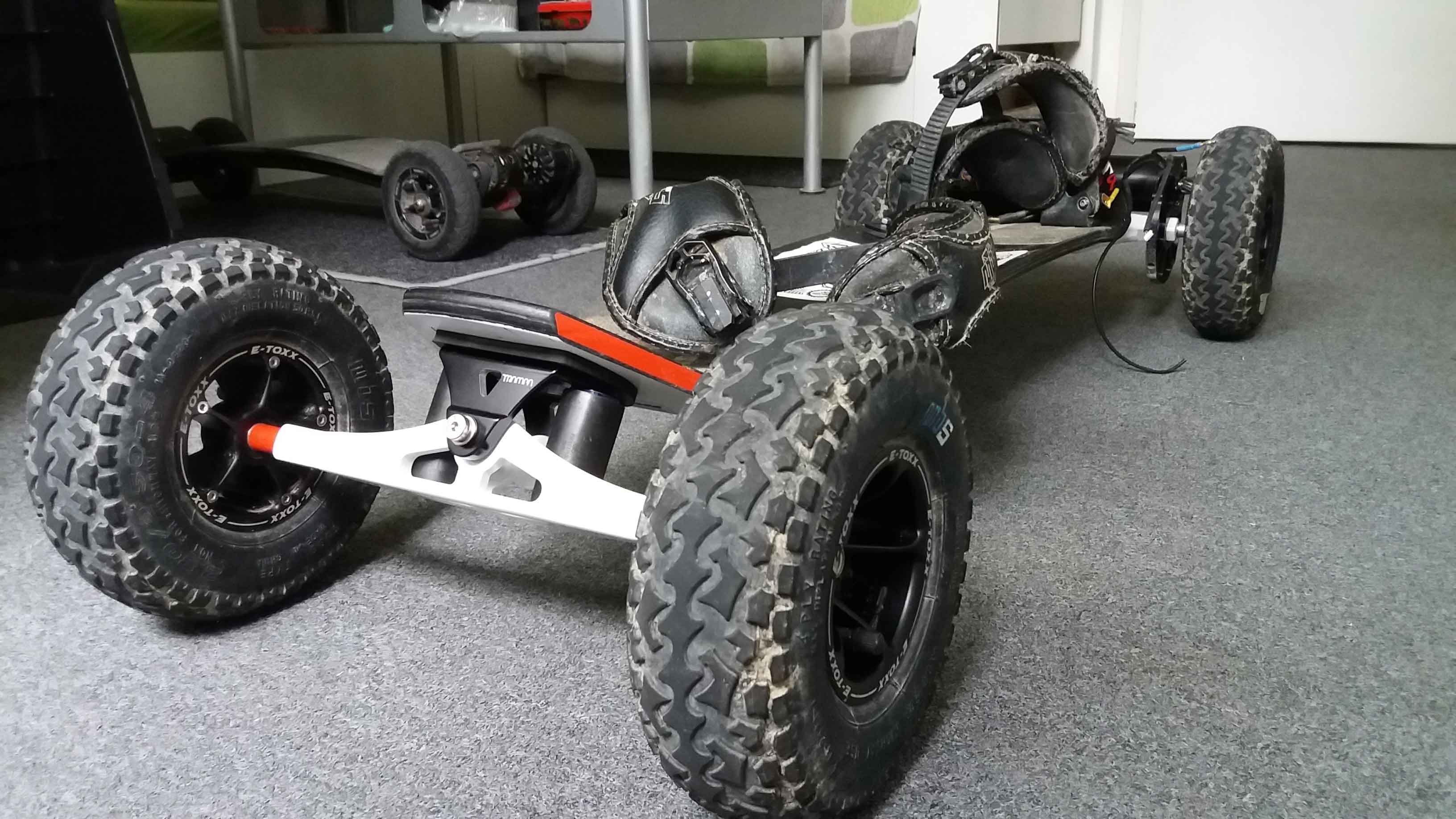

Here some pics of the actual setup
There is one thing I don’t understand, the Trampa trucks with elastomere dampers on the flexy HolyPro deck felt stable at speed and were carvy as well (for tight curves). The same trucks on the stiff MBS deck feel very unstable like trucks for kidz, I get speed wobbles above about 25km/h (15mph) or on hard acceleration which is sick. With the Trampa deck I never had speed wobbles up to 50km/h (31mph). :thinking:
I am trying to compress the dampers a bit for more stability. I started with 2mm washers and if it is not enough I’ll add another one.

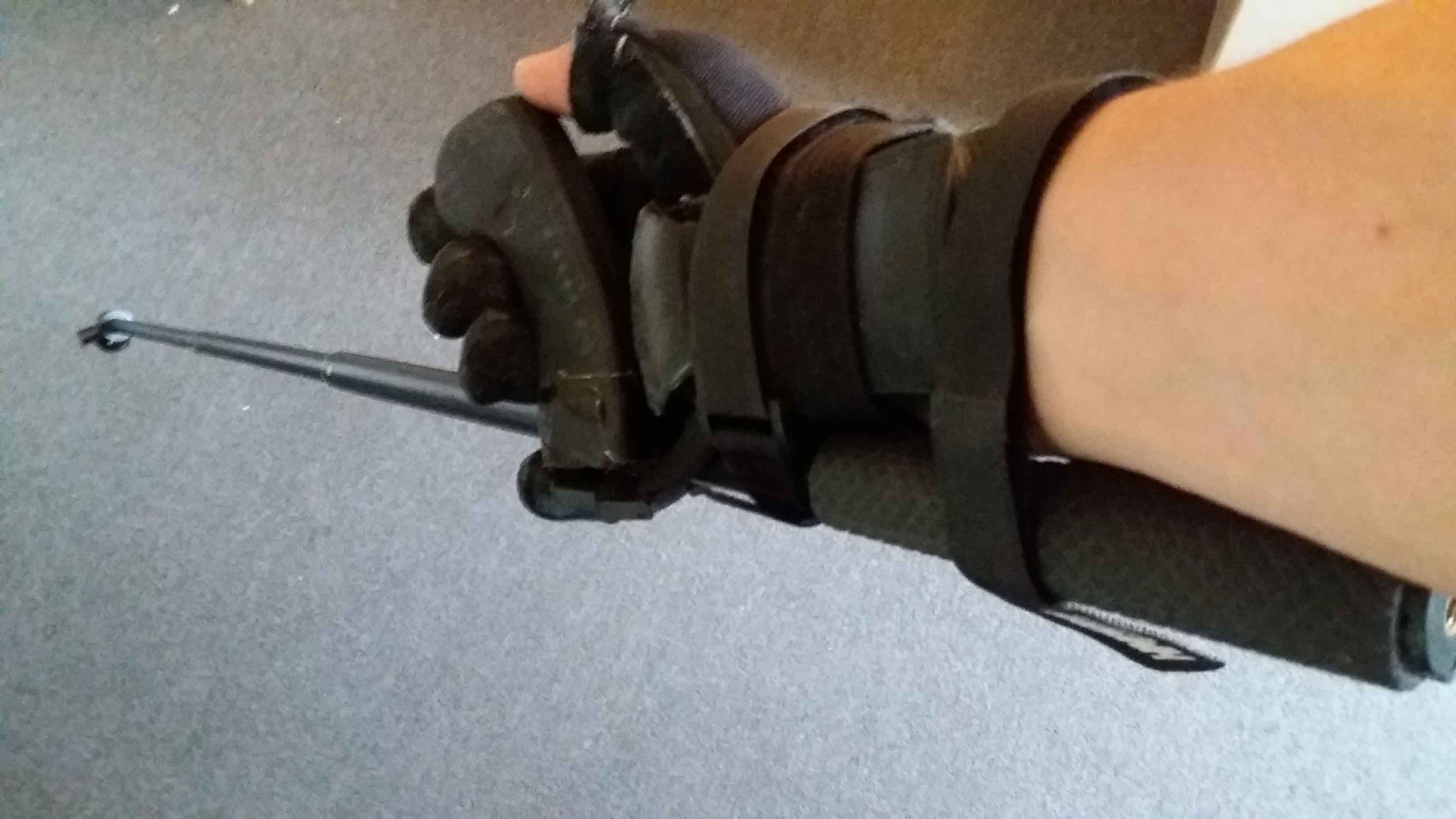

Thanks, I’m not that satisfied but it’s not bad. It was the first time that I mounted the camera to my right wrist with a strap mount. I prefer footage from selfie stick but it’s more difficult to ride and I hold the remote in my right hand so no good rear view shots possible when holding the stick with the left hand. However you inspired me to try a technique and it seems to work :sweat_smile:
Attached with 2 velcro straps to my arm and with the little finger I hold it and avoid rotation, gonna try this the next time.

The camera [quote=“rich, post:16, topic:35972”]
[/quote]
Looks a little dangerous in case of a fall. Are you sure it can’t twist your wrist?
Unfortunately not so I can’t give any feedback
I hope it is :rofl:
I wanted to test it today on a trail but it was too muddy and shady.
I am sure it could be dangerous but I need a good angle to film :laughing:
But now when I think about it maybe you are right, I could brake the little finger, wrist and forearm with a single fall :thinking:. Maybe I find a better solution or just risk it.
