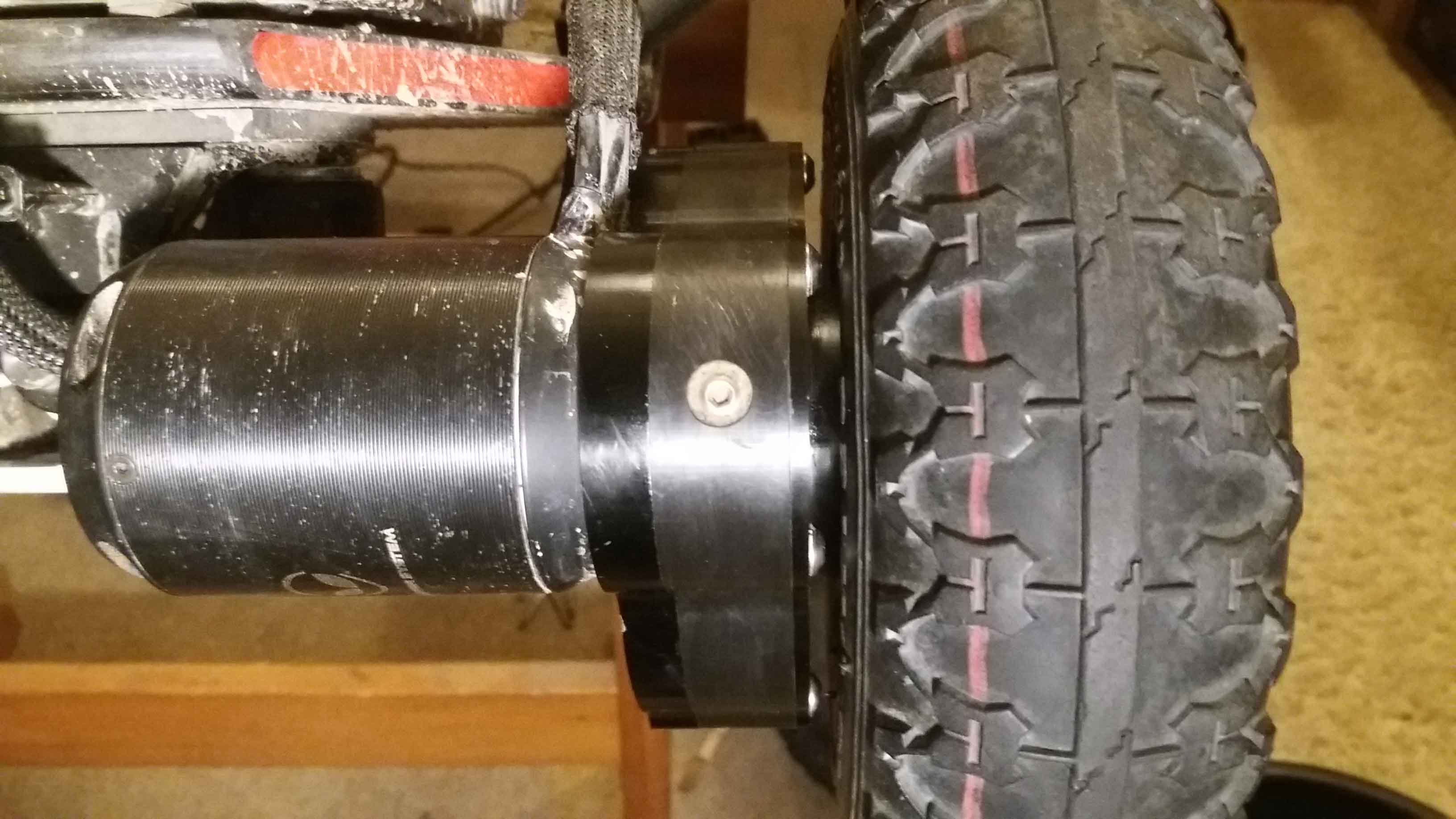

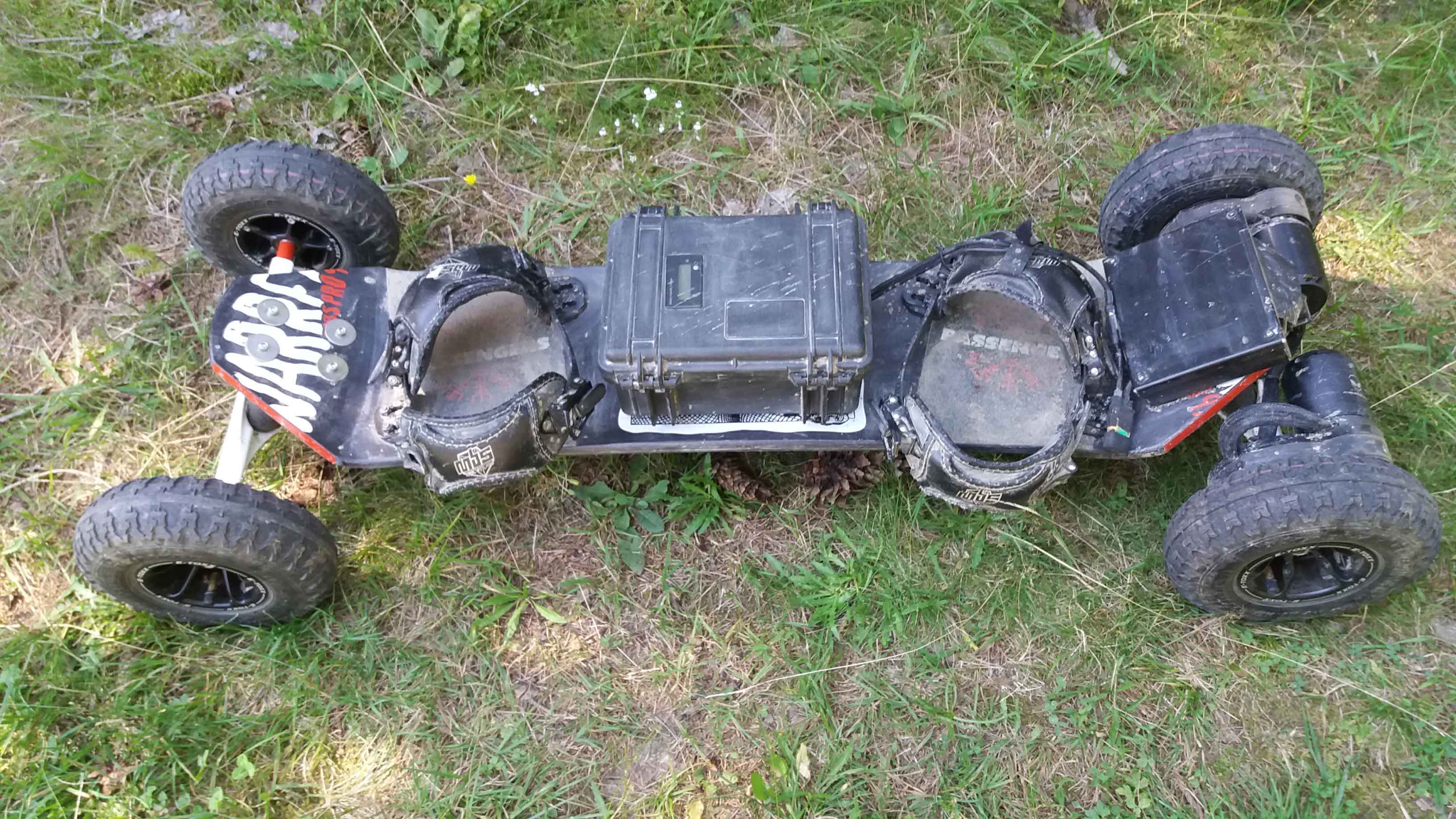

The tires are part of the problem, the MBS T2 tires are quite hard and made of nylon.
The same DWII deck with 8" T1 tires feels much better. T1 tires are super soft and made of rubber, they smallow a lot of vibrations. I wish 9" T2 tires would be the same rubber compound.

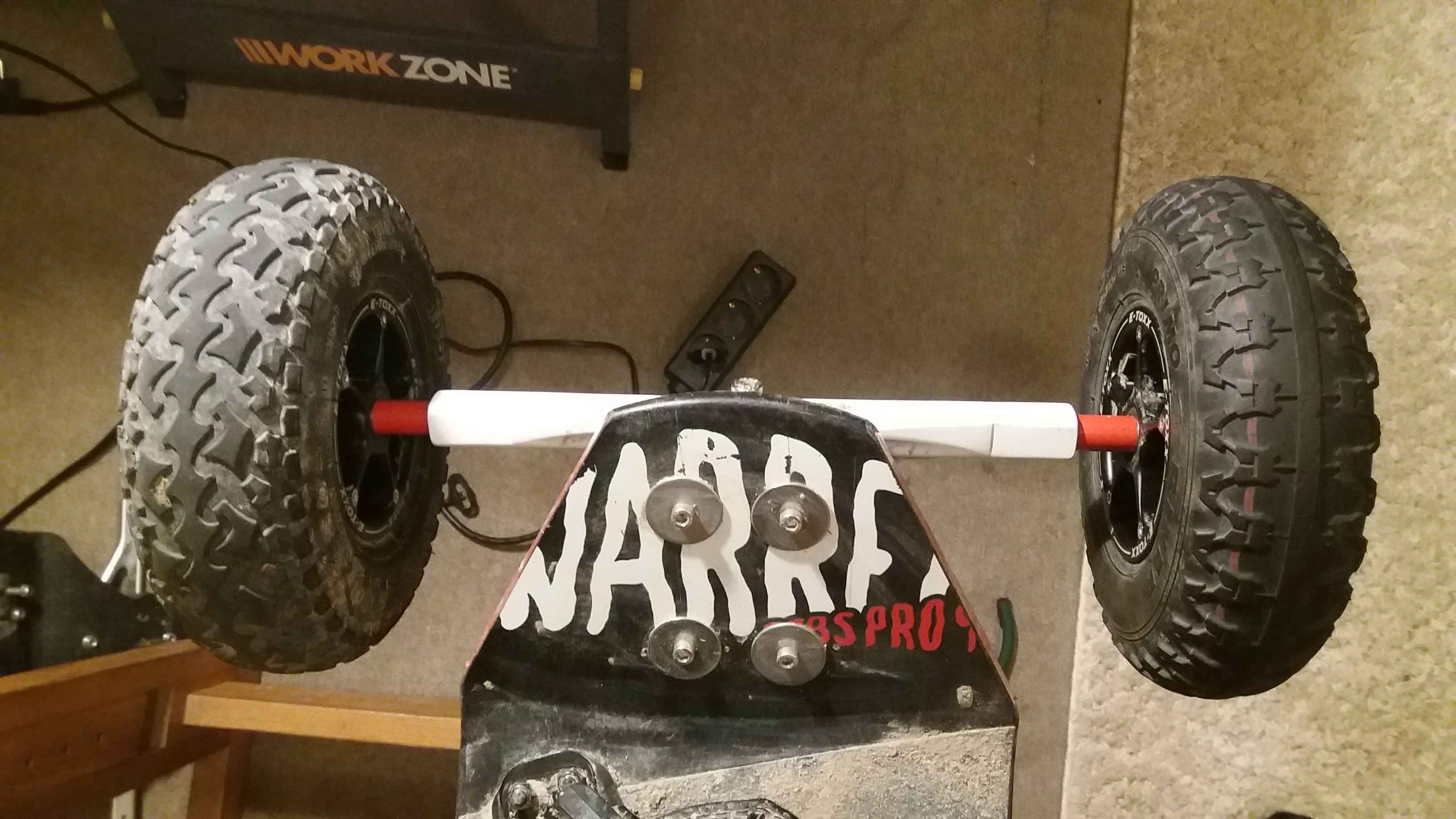

Back truck looser than front truck… it’s the trick to get thru hairpin turns (there are limits to what it makes you Abel to do, but you will clear more than before)
Loose back truck also works like traction control on the rough surface… it will keep you from lifting a drive wheel on hard turns…
Mbs matrix II trucks… they are far less bouncy than trampa… witch on off-road translates to more control and better traction

The rear truck carries all the weight of the drivetrains and motors and starts to wobble on hard acceleration or higher speed and feels way to soft for me right now. Compressing the dampers 2mm helped a bit but not much.
The problem with the stiff deck is that often the rear gets lifted or twisted when riding over roots or bigger stones which is awful and I had several falls because of this. With the Trampa deck this never happened.
Yeah just came back from dirt park with cranked down red shock blocks. It is super stable off-road and I feel very safe. Unfortunately I can’t steer well which I would need for trails. With orange shock blocks I don’t feel safe when jumping, too soft.
I would consider Matrix II trucks but the motor mounts shift which is annoying. Furthermore the black ones are always out of stock in EU :man_shrugging:

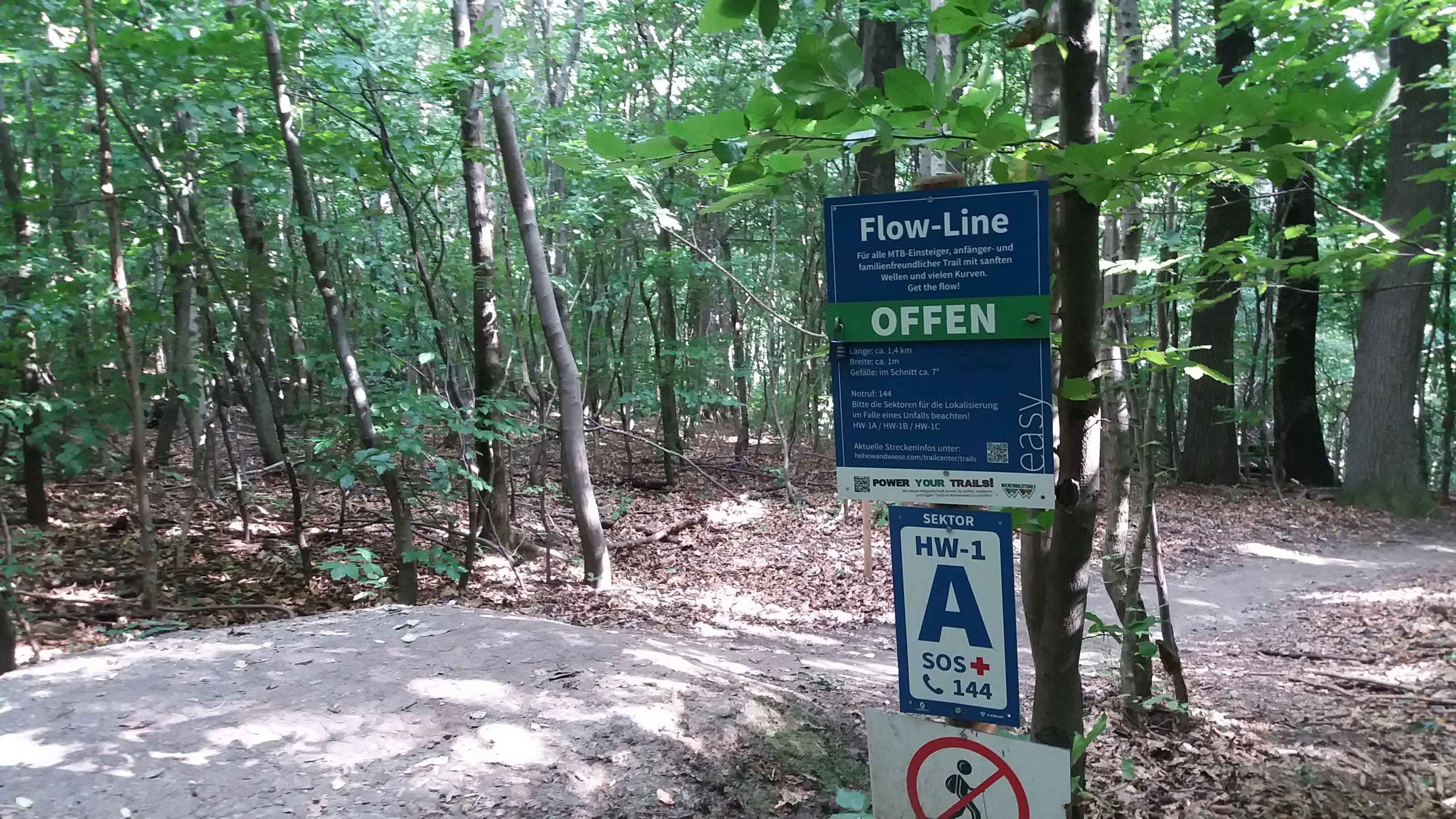

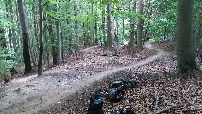

Yesterday I’ve visited another trail park but it was a bit disappointing.
I rode the uphill flow trail but it was quite difficult to ride with narrow tight curves and it was pretty steep. Several times I lost balance and fell.

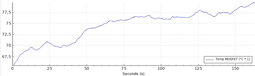

It was only 25°C outside but the Vesc6 did overheat within minutes. I had to take many breaks.

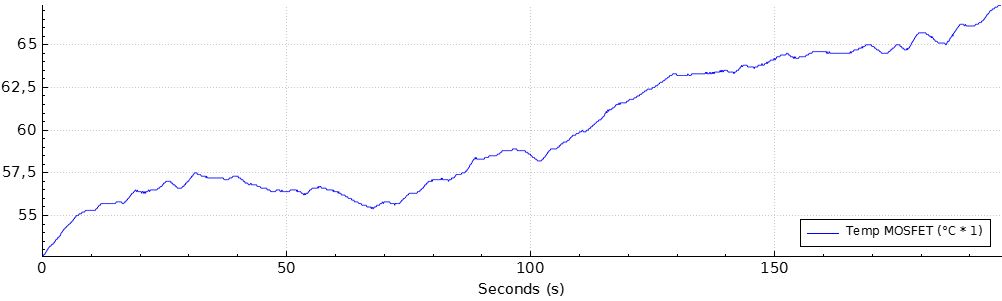

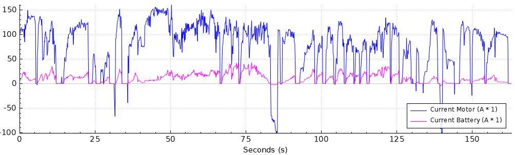

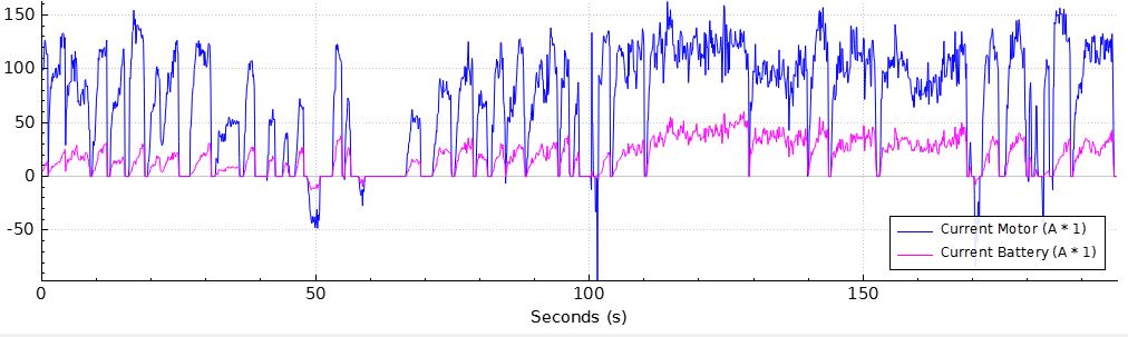

I recorded some short logs to see what’s going on. Well after a break it took 2:42 minutes from 65°C to 80°C
Here the currents
After a long brake I rode 3:15 minutes and the temp climbed from 52°C to 67°C.
Even when the temp was at 60-70°C the power felt very limited, strange.

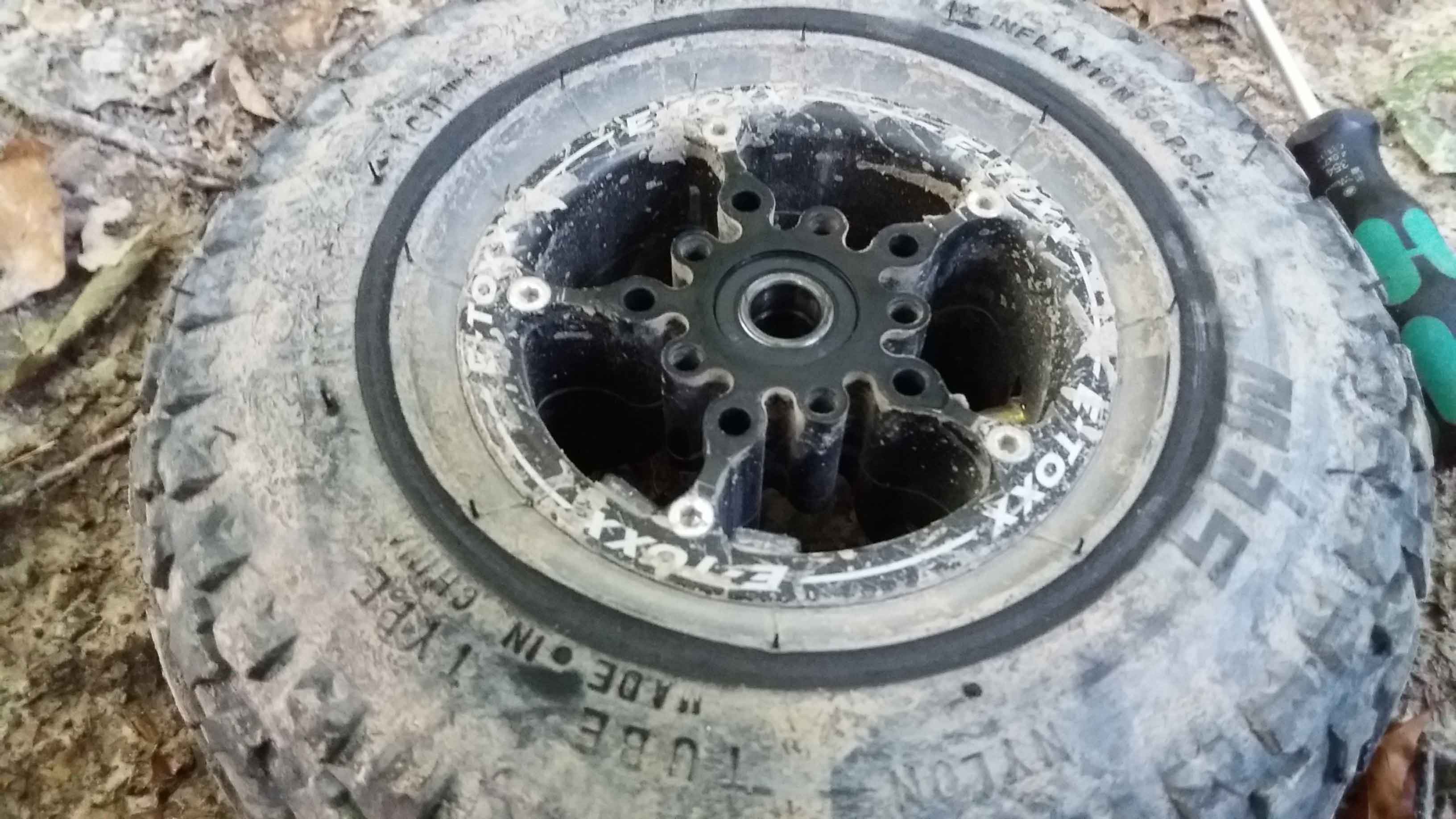

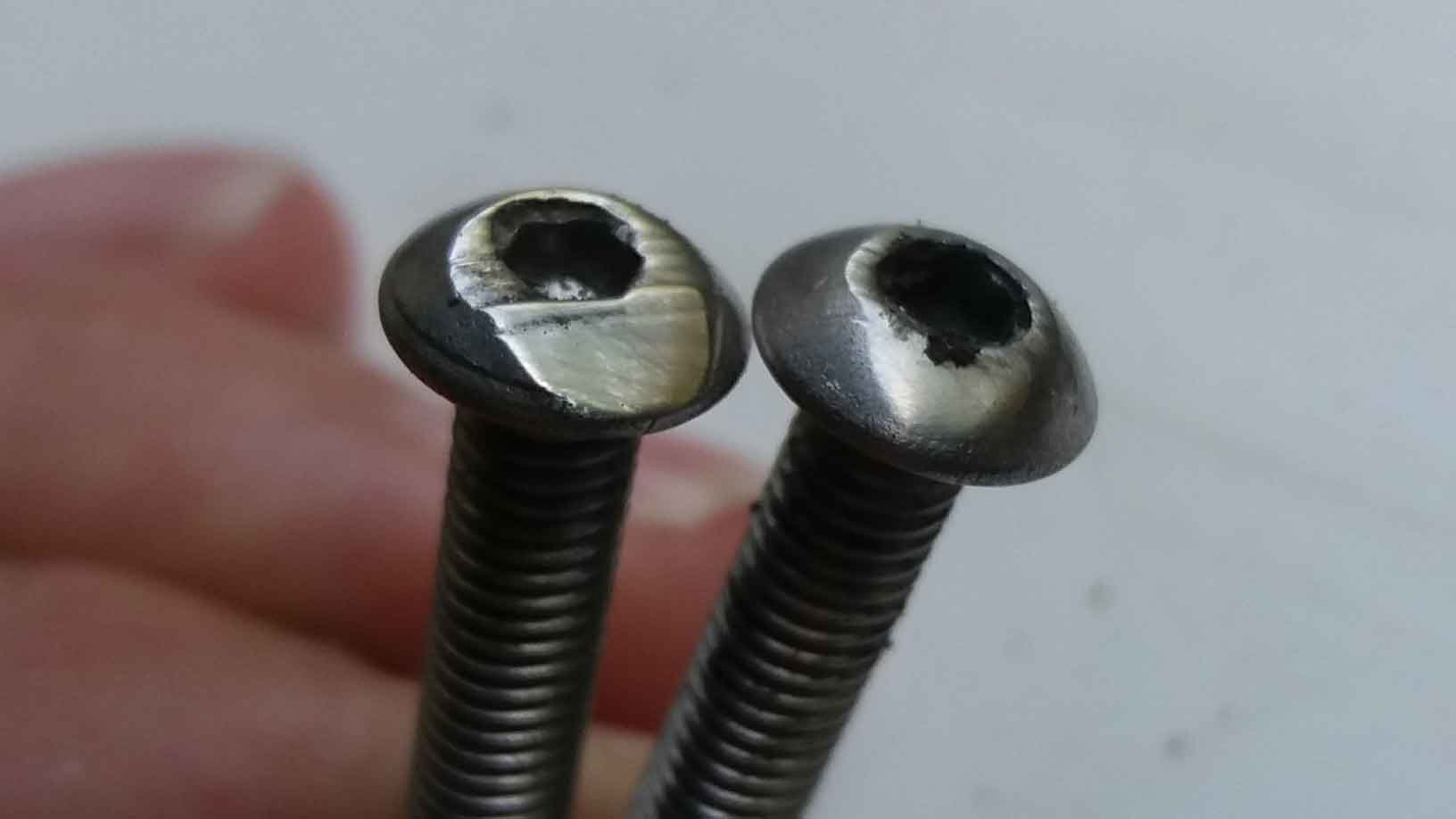

Then I climbed the hill again including breaks and then I recognized the drag, the T2 tires deformed again and got shaved.
I don’t know why but this happens only with the “new” swapped tires. Last week a part of the side wall deformed and scratched on the bolt of the housing. After de- and inflating it worked again but now the full side wall moved outward. The other side is the same just not that bad.
The rubber shaved the stainless steel bolts as well, sick!

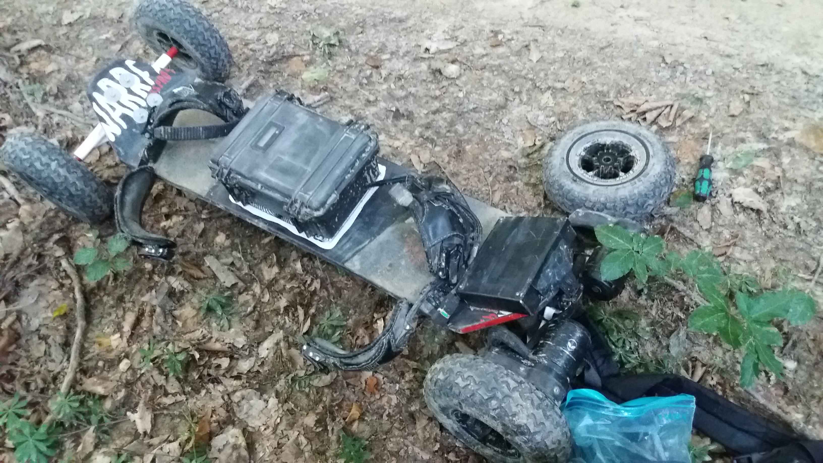

At the end of the day a motor mount came loose which also never happened before.

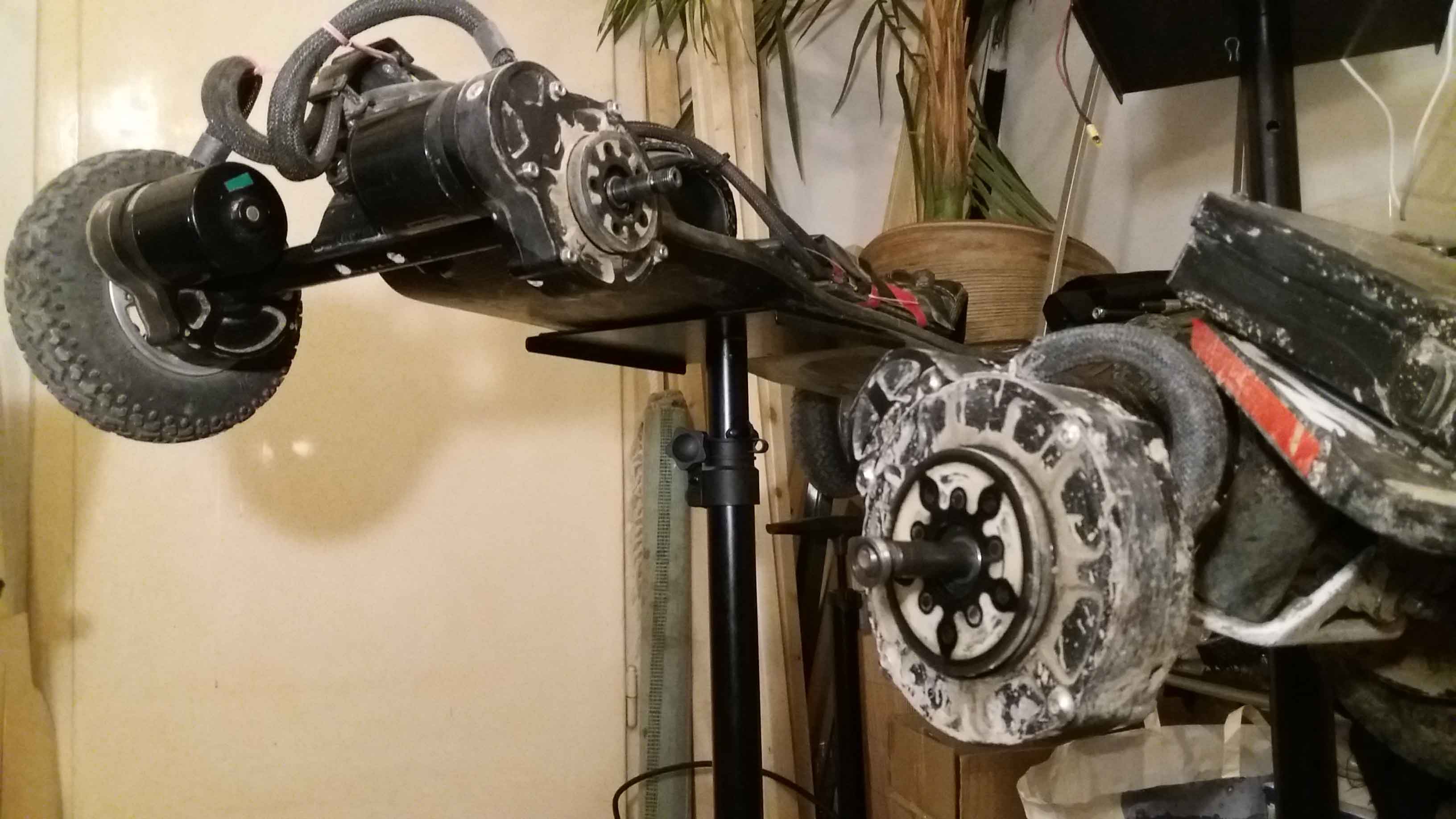

I wanted to drive to Wexl trails today but that didn’t work, both boards under construction.

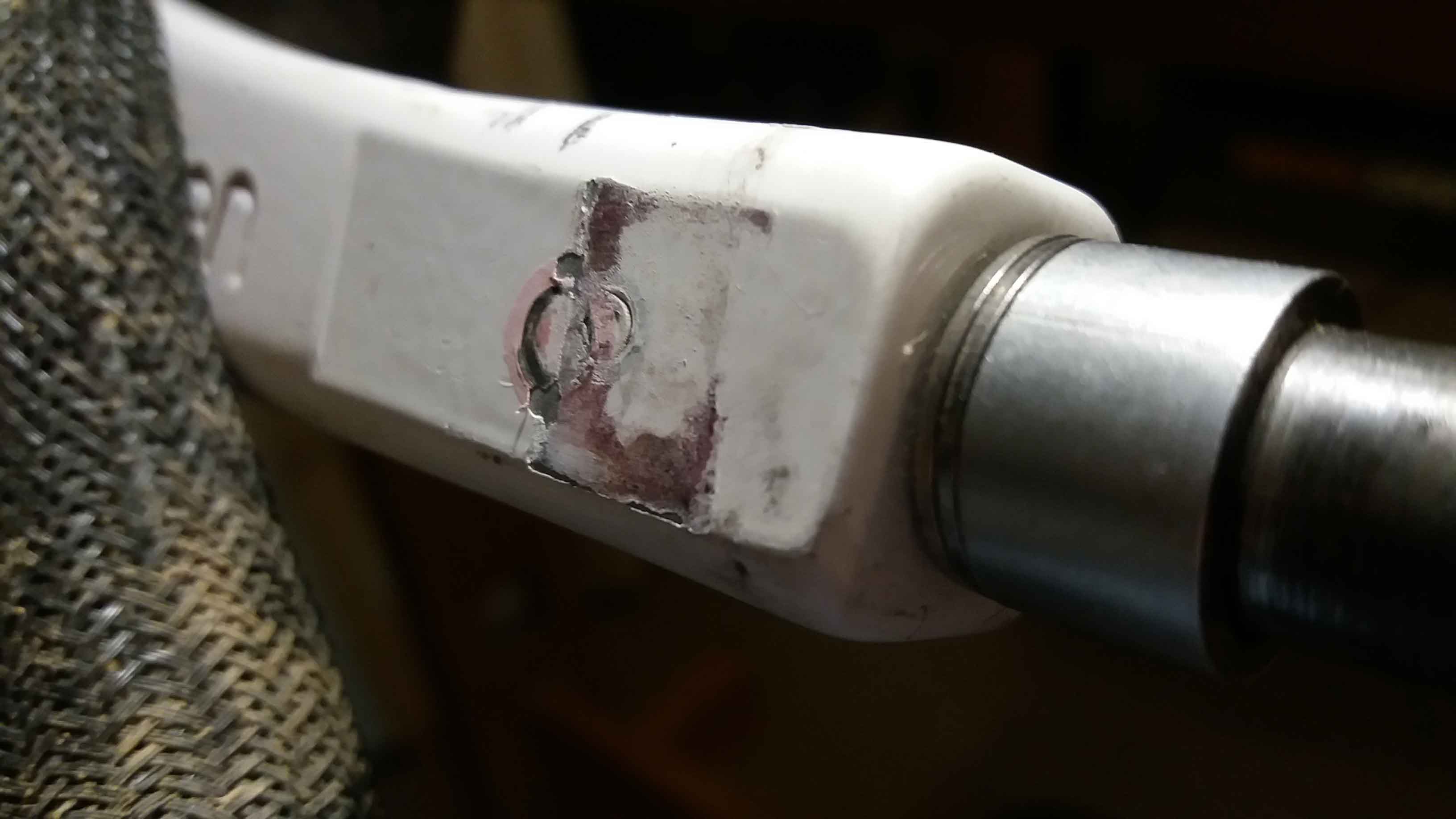

It is weird how damaged the hanger looks.
Meanwhile I put everything together and have to wait for the thread locker to cure… boring. 3 days left then I’m back at work and can ride less.

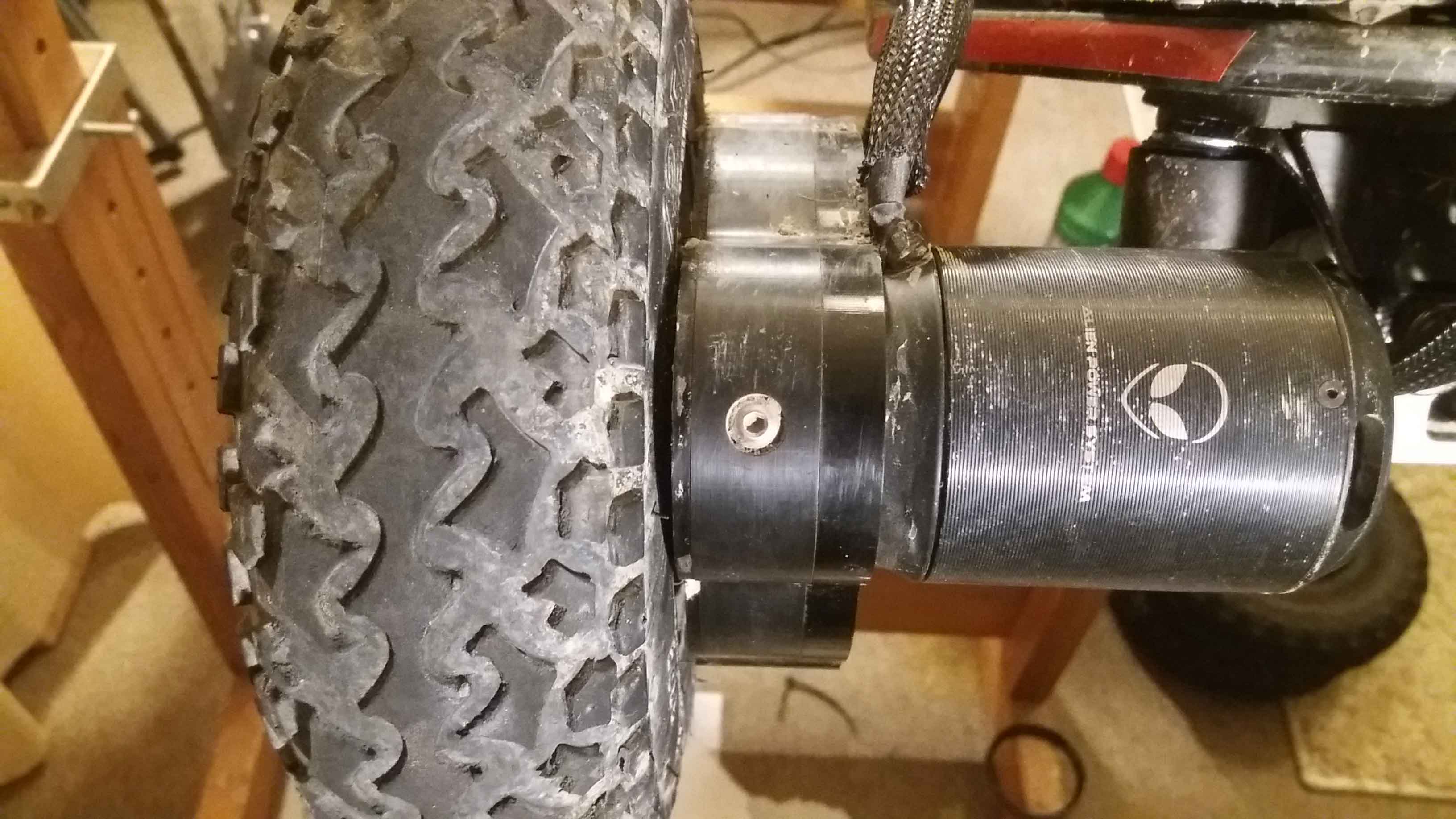

I switched to 9" Primo Strikers, never had them before but they look tiny in comparison.
Big advantage is the large gap between tire and mount, no more tire shaving…
compared to T2 tire

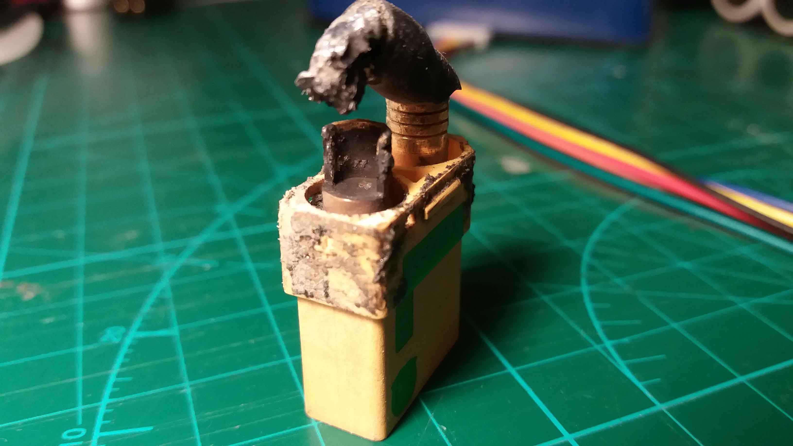

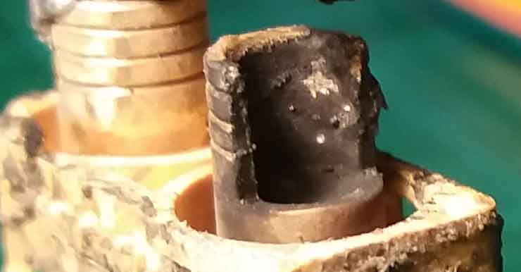

Today I checked the loop key and could lift the wire, the connector is burnt
I guess that happened when the XT90S got loose last week where the board also shut off several times. I’m thinking about going back to anti-spark switch where I feel safer because vibrations are no problem at all…
I doubt that was the cause. I would stick with the loop key if I were you and find a way to keep it in place if this is a problem
Any other ideas? Would be interesting.
I just read several times that XT90S get very hot and can melt if they are not 100% plugged in Mine was 10% plugged in when I recognized it and before I rode with a loose loop key for some time.
TBH I don’t like loop keys, for me it is annoying. I just made the loop key because a cable of the AS switch broke and it’s a tiny 5pin connector with 1 mm pitch, need to research where to buy. I have 3 boards and all of them have anti spark switches. I run 10s and 12s on standard AS switches and the MTB 12s on direct FET AS switch (before the wire broke). The switches are from 2016, 2017 and 2018 and never failed. I know many switches failed but not mine. The only problem with the cable break was that I had to wiggle the wires to switch it off. But that was not dangerous. I also switched to a loop key because I thought it’s much safer. Meanwhile I lost several times control of the board when going downhill due to a problem with the loop key.
AFAIK a broken AS switch just gets stuck in ON position which is better than losing control.
the blackening is from the connection sparking, most likely it was a dry solder joint and the vibrations just made it finally fail.
Although that is true, in order for the solder to melt, you would have to reach temperatures that would probably melt the plastic part first.
Like @Pickled_Monkey said, it could have been a cold solder joint.
I had a loop key for a long time and after it was connected halfways only like in your case once it started to smoke and some days after it came of.
One time I broke my as switch wire during a ride. (on/off):joy: (Battery was the traitor…)
Shuts off immediately. But since the rework, no issues so far.
