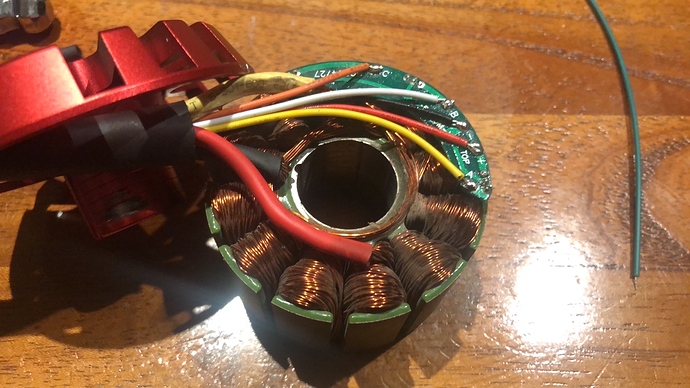

Well my cursed board hit another snag. One of the 6354 motors I purchased from @dickyho had faulty solder points on the hall sensors. I’m hoping that I can fix the motor but we shall see. First step is to take off the motor housing to get to the PCB.
I’m not trying to say anything bad about @dickyho but it should be noted that the quality assurance of these motors is lower than ones you might purchase elsewhere.
This happened after less than a mile of riding.

I repaired a very similar motor. Was easy but I do own a pair of circlip pliers.

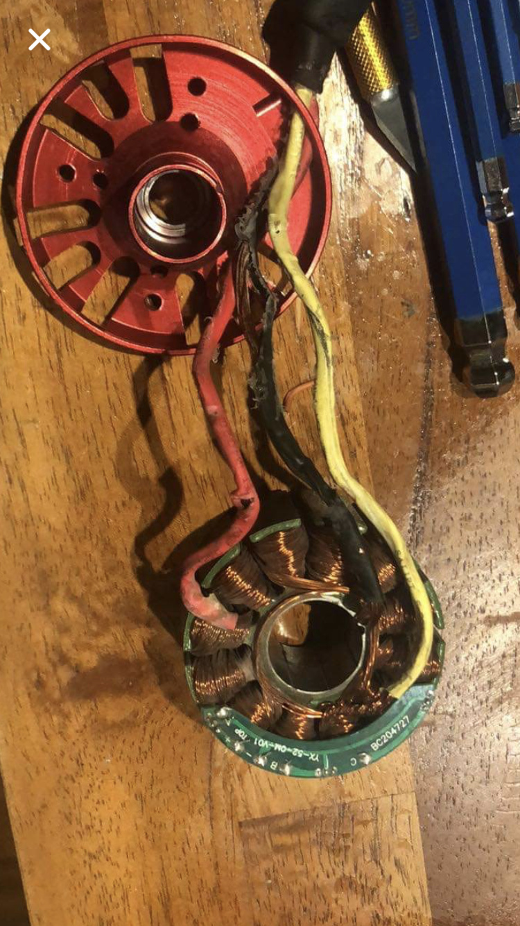

I found the reason my sensor wires pulled off was because the stator shaft was rotating because the locating pin either fell out or wasn’t there. I epoxied a new keyway in when I reassembled it as well as soldering on new hall sensor wires
I was actually lucky the former epoxy let go because it made repairing it much easier
Thank you! Really appreciate your sharing these photos. Once I get my circlip pliers. I will investigate the locating pin when I open it and potentially epoxy a new keyway as well.
Finally got around to this repair today and I cannot for the life of me remove the stator. Any tips on how you got it out?
Got the stator off the shaft, but cannot get the stator off the back motor casing. Looks like the locator pin is missing on mine too and the designated ridges on the motor housing and inner stator bore are misaligned. Do I just torque-twist this thing off?
Pics of where you are at now?
