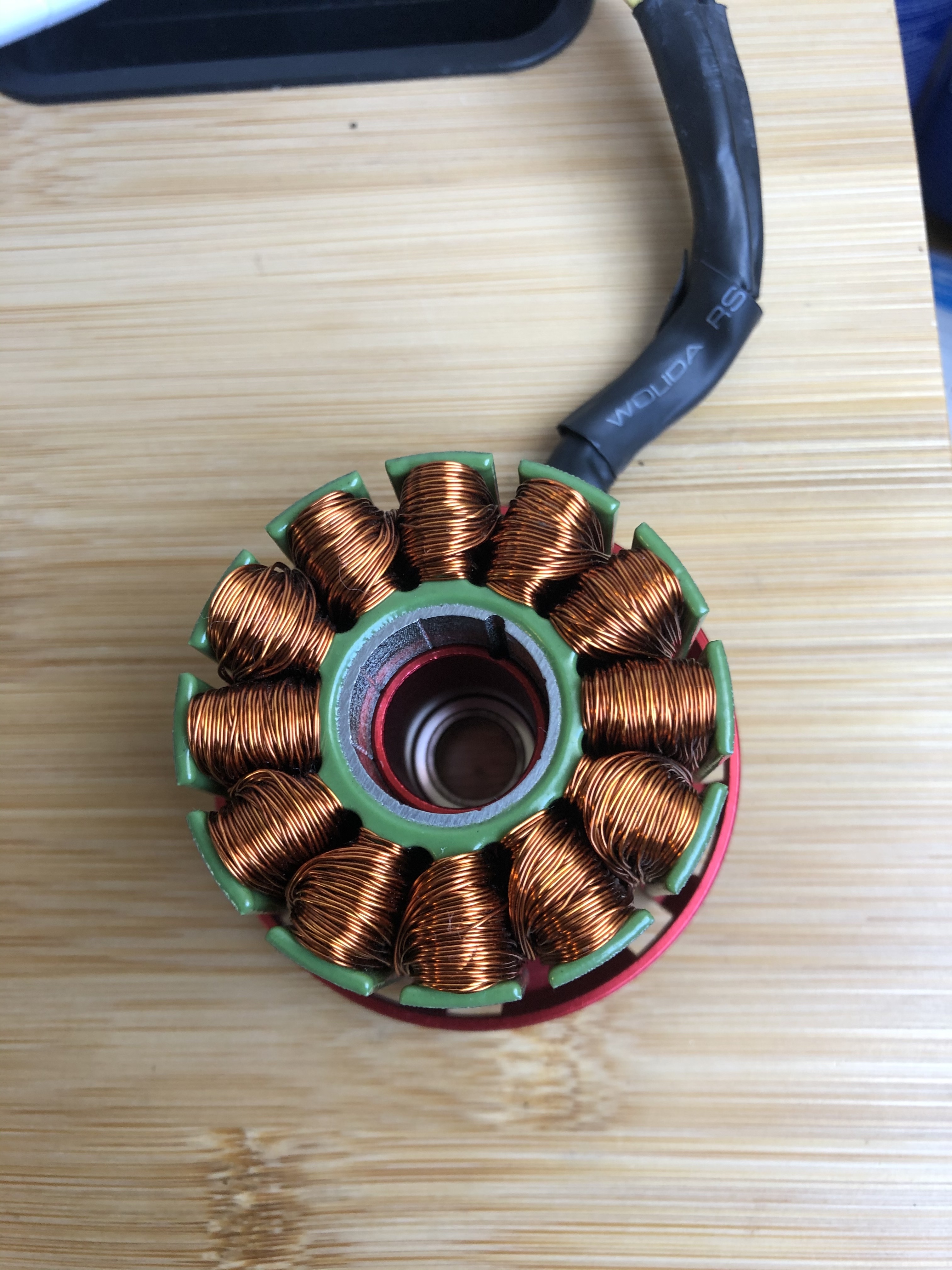

Well, not quite out of the woods yet. I opened the other motor and entered a nightmare.
These motors are big heaping piles of absolute shit. I wasn’t expecting these motors to be this bad. Stay FAR away from these motors.
The omission of the locating pin in both of my motors makes them completely defective. I’m outside of my PayPal coverage, so I’m S.O.L. on this. What an utter disappointment.
I have no idea how to fix this these copper windings. Can I just resolder them?
As mentioned above, @dickyho sells defective motors that will fail shortly under load. If you were unfortunate enough to have purchased from him in the past, there is a simple DIY fix–provided your phase wires were not damaged like mine.

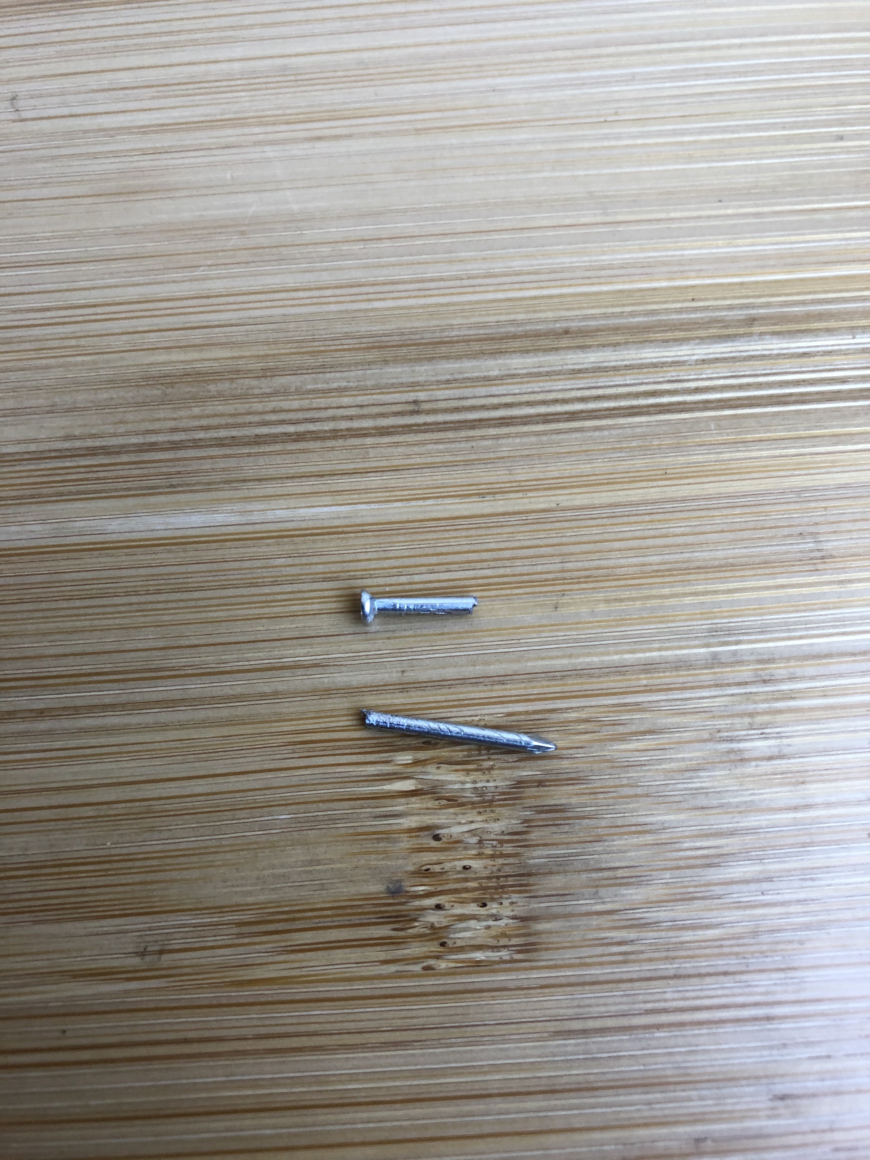

The missing pin for the stator/motor shaft keyway can be replaced with an M1.5 grub screw or shaft of some kind.
I discovered this by inserting an M1.5 allen key into the space.
I happened to have some nails that were the same diameter, so I hacksawed off the end like so and inserted it into the void keyway:
This should hold up well and won’t fall out as it is flanked on each end but the motor bearings. A small amount of torque will also lock it into place.

yeah I just made a new keyway from some welding rod I had the Allen key looks even better for the task than what I used.

Oh boy… That’s pretty bad. Those are a pain to solder because they’re usually all epoxy coated, so you’d need to sand the ends of every strand before anything sticks to them
Yep, I doubt these are specific to dickyho but rather to this generic China motor model. I suspect that all of these motors are defective. The reason why some may encounter this issue and not others is probable a function of two factors: rider weight and degree of riding incline.
Someone lighter than me and riding on mostly flat surfaces can probably get by fine with the epoxy that holds the stator to the motor housing shaft. Without the locking pin, the SF hills I have been riding caused the slipping that damaged mine.
Yeah I’m fat too
Yeah, it doesn’t seem like soldering them is going to be feasible, especially where they broke. I’ve decided to buy another and keep this around as a spare that I can use to practice rewinding. Being able to rewind a motor seems like a skill that will come in handy in this hobby.
