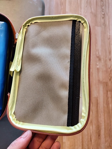

I was originally going to use a bigger battery and a hard enclosure, but decided to go with a rear top mounted smaller battery for portability and ease of the build. I got the idea from @TheDude’s budget build thread and like how simple it was.
  • Super cheap zipper pencil case that looks decent.
  • Able to quickly hot swap batteries on the go
  • Don’t need to figure out an antispark/loopkey solution. (Just unzip and unplug the battery)
  • No holes drilled into the deck!

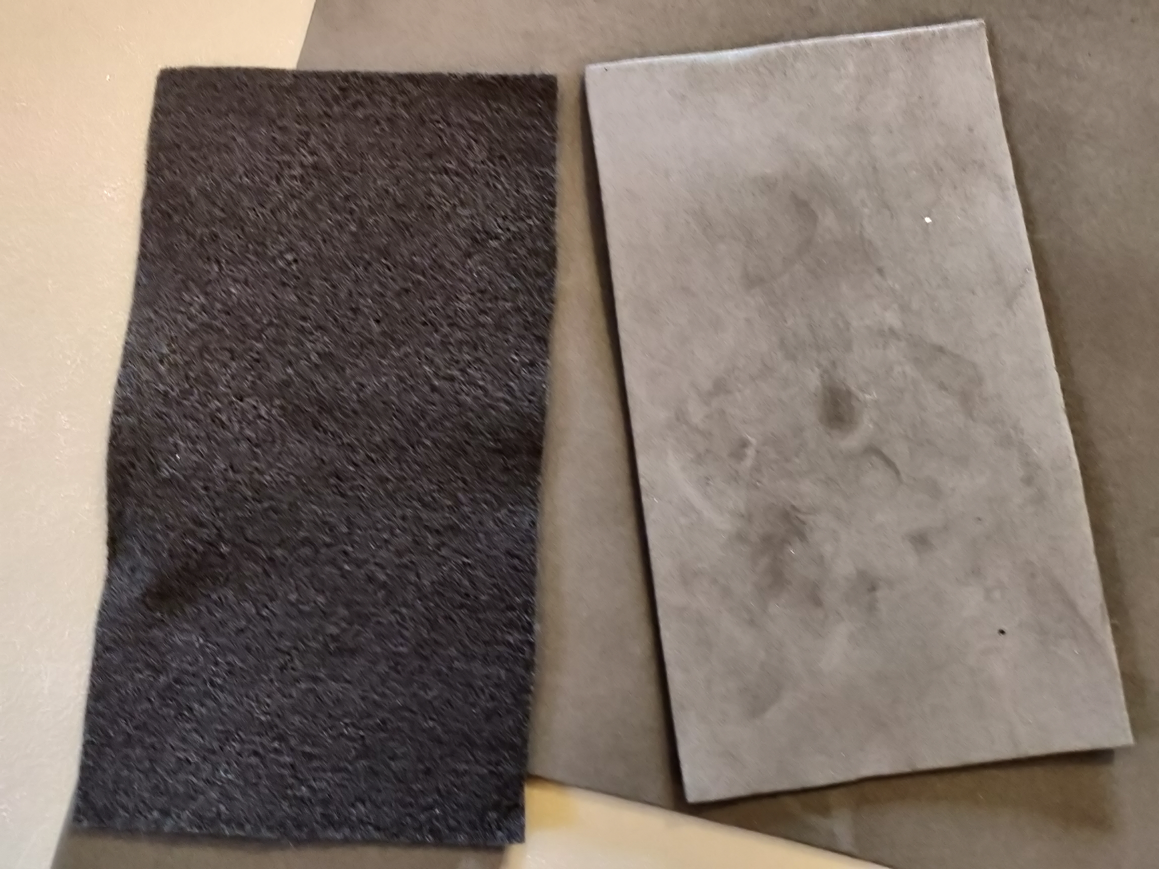

I put some foam on the bottom to protect the battery from vibrations and the screw heads:
Perfect fit of the battery!
Also 3D printed a lid support to keep it un-wrinkled:
