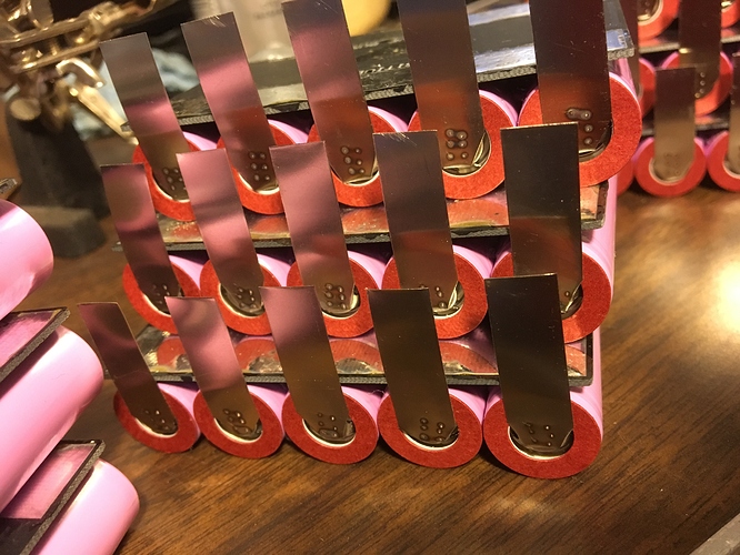

Home-made 10s4p made with 30Q’s

Home made 12s5p 30Q pack

Did you cast your parallel cells in resin? Just wondering about your experience with it, is your pack still doing ok?
haha, yeah, I was waiting for someone to notice that.
the battery is doing great, cells stay balanced, never notice any heat from them, the dual focboxes warm up nice and toasty, as to the motors, with the braid and the balance leads all conformal’d I got away with riding it in the rain. Killed the focboxes tho…

Never actually seen anyone casting cells in resin, the only concern I would have would be in case the cells heat up and expand, some pressure could build up and lead to the resin cracking or exploding, I noticed you did not put it on too thick so the heat transfer should not be affected too much. If a flexible material with a good heat transfer coefficient could be used to cast the cells it would be ideal. Would be nice for someone to start experimentig with cells casting.
Check it out. @TheMrLarin
https://endless-sphere.com/forums/viewtopic.php?f=14&t=71125
These guys did it back in 2015, except they did 10s1p potted packs.
