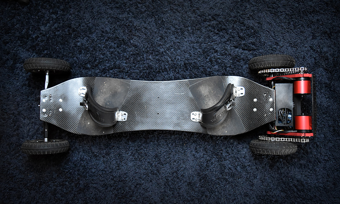

I just want to save my old and fav board here.
My Darth Vapor, evolving since 2015 year after year, here is some quick view of the stages until this summer :
2015
Proto : deck Scrub - front Scrub Chanel truck, rear Vertigo with welded motor mount by Willozboard - 9" Primo Stricker tire with Scrub plastique rims - chain h25 - APS 6374 170kV - APS 120Amps ESC HEV - 2 x 5s 8Ah 35c Lipo - GT2B
2016
v1 : deck Scrub sandwich carbonized - front Trampa vertigo - Trampa Footstrap - VESC !!!
v1b : Superstar 8" w/ Primo Stricker - V4.10 install on the motor mount
v2 coming : New custom motor mount.
2017

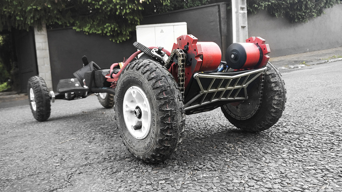

v2 Proto : Deck a bit reshape visually - Vertigo trucks - custom Xmount - 8" - Iso06B chain - Overion 6374 130kV - Trampa VESC 6 Beta - 2 x 5s 5Ah 45c Graphene - GT2B 3D case
v2 Street Fighter mode
v2 Off Rooaaad mode
v3 - waterproofing a bit the thing ^^
9" 5star rims - bigger ratio - 12s 12Ah 15c Graphene
2018
v4 - New shape again, I cut it the shorter ap, wedged riser to get 30° tips.
v4b - New MBS straps, new diy box for fun, new grip … front bumper (diy anodizing ^^) !
Sale summer 2018 … with Fox vs. V6, and 10s5Ah vs. 12s12Ah …
But !
:relaxed: fate has sealed us for life I guess !
New shape once again, to work with the next upgrade of the drive
2019
V5 / e-toxxification! - New shape - Rockstar 2 rims 8" Primo - MBS Matrix 2 (v2) trucks - FS 6380 150kV - full e-toxx gears !
v6 / downgrade - 5star 9" Primo - 2.5/3kW battery - 6384 80kV - chain iso6B - Dual ESCape
What will be next !? :smiley:
I will post detailled part or step that I want to save here with loooooot of photos !!

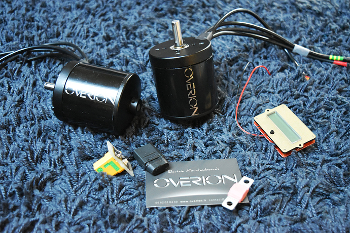

Weird to buy a loopkey tho !
haha ^^, Maybe but … it’s just part of the list … and I need it ! I use it for around 2 or 3 yrs at least I guess.
And, no weirder than your comment :joy:
People should know it exists !
They are very studying, I like the details, clean slick look (for the last version in full black), and the pcb very helpful to also directly use ubec, charge, led power, etc. And to easily set it on your enclosure, strongly fixed with screws !!
I recommend it to you, and for only 9€ !
Plus, in addition, you are helping a small French artisanal company that has brought so much to our community! I would do it again with pleasure !!! :kissing_heart: (I prefer to by my HK XT90S from him than directly from HK)
