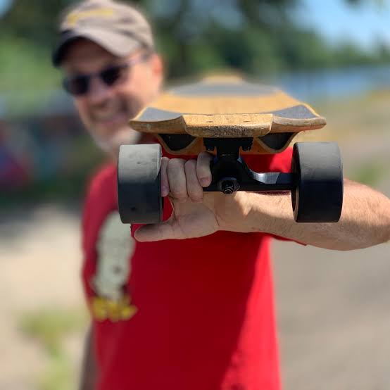

Yeah but doesn’t have that mitred corner bro…
Nope, but there must be a hole in each corner
I don’t see the compound corners, like Ross said, it appears as a simple cover
Holes in corners.

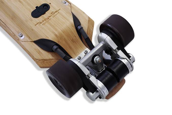

I have been thinking something like this is a great approach for a diy.
Removable enclosure as a cover with no holes or plugs etc.
All cables and switches etc made through moulded risers on the base of the deck, that the enclosure is moulded around and sealed onto. Waterproof and fixed to deck. All batteries etc fixed to deck.
My next board will be similar… we’re on a wavelength here… It won’t even be an enclosure but a dust cover secured with a few 1/4 turn appliances… no BMS, no on/off button… nuttin…
everything fastened to the board… you could drive it without the enclosure… the enclosure is a dust cover and a skid plate…
So maybe, going the hoyt way, then filling the holes with FG to prevent whater from getting in there
Anti spark button on one and charge plug on other side. Running lights on front two?
