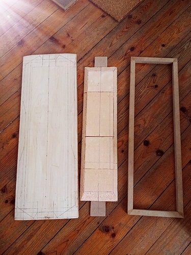

Custom Enclosure : pressing wet plys with epoxy (question)
Getting closer :scream:
From left to right : 8 plys uncut deck, mould, to-be-clamped frame
Super Soft 2 advanced veneer softener. I have some hard angles on the bottom of my decks and they will crack on occasion in the press without it

Test forming one plys
It might work :sweat_smile:

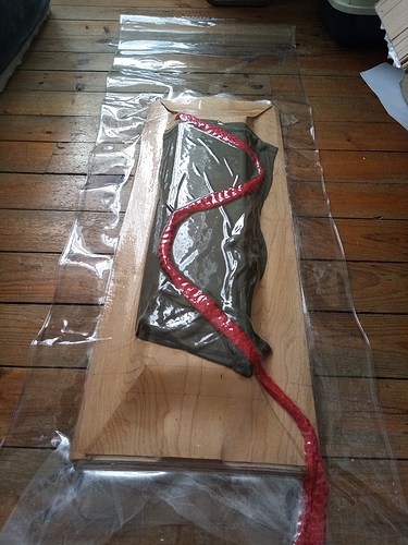

oh you’re going to vac bag it! that’s better than a press for one offs for sure. Can’t wait to see the results.
This is so ambitious :joy: i fucking love it
Yeah I’m trying with vac bag but It’s really hard to place theplys correctly when it’s inside
it seems to work well though
I build the wooden frame in case I need clamping but honestly this freaking Roarockit bag is a beast :heart_eyes:
Yeah, honestly my kids and wife keep asking me why the fuck I’m so invested in this :rofl:
Could you drill registration holes in the plies and tie them together somehow?
The plys will have the exact same shape so pretty easy to place one on the other but the problem is more how to precisely place the plys on the deck+mould
You could use the same idea. Just have registration pins on the mould with corresponding holes in the veneers
Hopefully you have left yourself enough space on the flanges to do these points in segments that will be trimmed off later… or just do them in the middle and they will get glassed over anyway :man_shrugging:

What kind of vacuum setup are you using with the roarockit bag?
The provided hand pump, why?
I thought you might have gotten their new barb attachment that lets you use a vacuum pump… is that bag easy to seal up? thinking of getting one of those.
The first time it seals very well but when the gum gets slightly dirty it’s almost impossible to have it perfectly sealed
