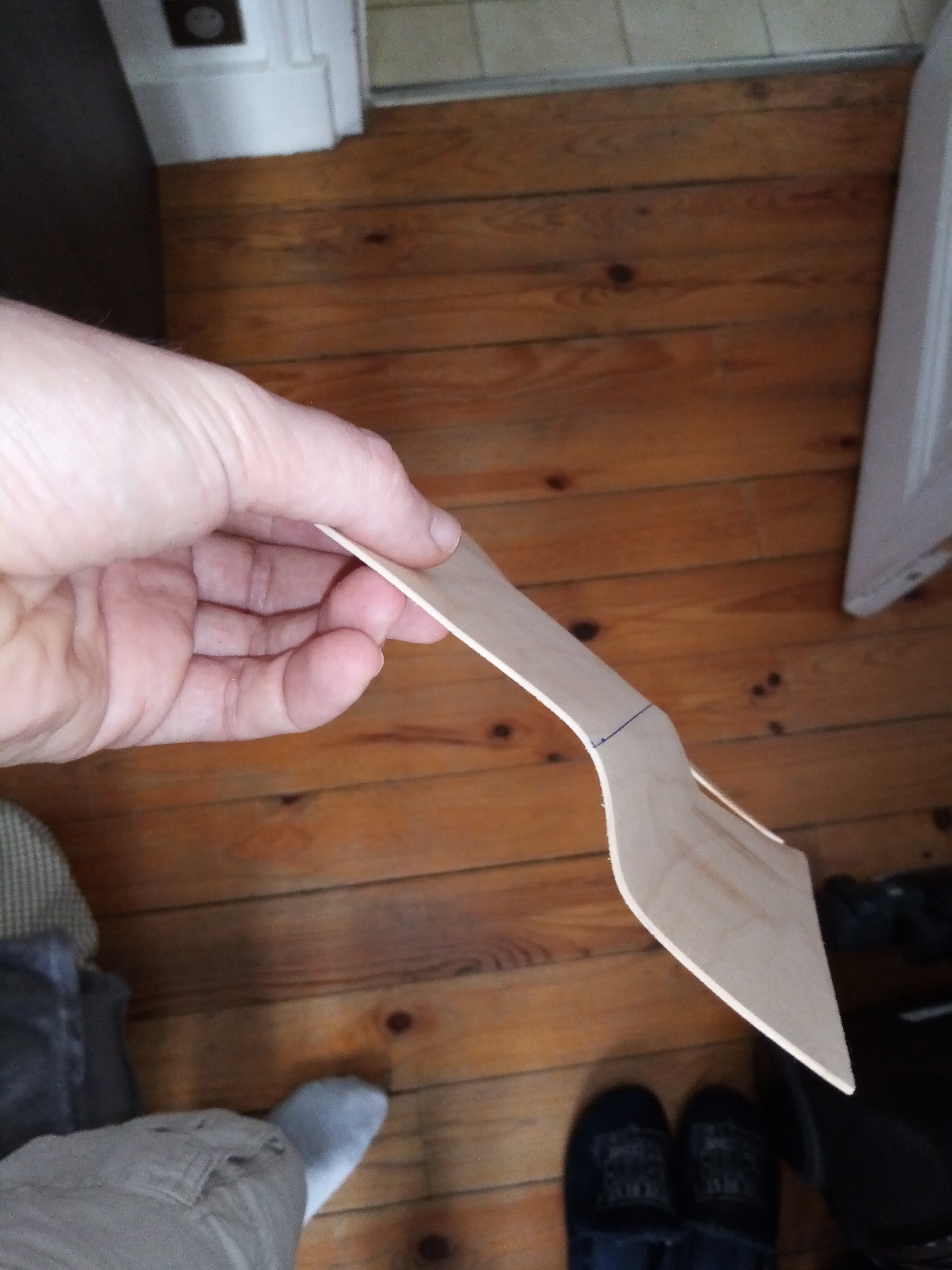

I’m in the process of building one of my designs and I have a very sharp corner to make with my plys.
I tried to form a small piece of ply by soaking it in hot water and it works.
I wanted to shape the plys like this, then glue them but it appears the ply came back to its original shape after it dried.
So my question is: could I soak the plys and put my epoxy, fiberglass and all inside my vacuum press?

Water and epoxy are not friends.
You would need to thoroughly dry the shaped ply while it was still being pressed. And then do your layup

The thing is my test sample, even if 90% dried, did not keep its shape entirely, so I’m afraid the wood will break if I press it afterwards

I was watching an episode of How It’s Made and I think they steamed their wood for like half a day until it was warm and pliable. Applied glue between each ply. Then they clamped it to it’s desired shape or vac formed it for like a couple days until it was dry dry. Then they applied the finishes or epoxy

I thinks gluing wet, let dry and then fiberglass could indeed be the solution :ok_hand:

You can get veneer softener, understand your spray on, clamp while drying to assist flatness or shape or whatever you need.

you can always see if you can leaving in the press super long with multiple veneer plys and while it’s drying think about how you can clamp it… make sure it’s super dry clamp it
and then quickly lay up your board and press it again
you may even have to wet press it multiple times to dry and then bond the veneers and repress it

1 ply small piece, it dried for an hour or two but it’s like 40°c over here

Why not glue and vacuum clamp laminate just the plies with pva glue first (slightly damp veneers probably ok then???). then on your completed shaped part, do a wet layup with epoxy and glass???
Like @kook suggested - multiple stages

Small piece was just to test the forming process, I will have to get the same result with 2 full 100*30 plys
How was that formed? Clamp or vacuum bag into a buck? If one laminate works, would two? The glue between layers will help it hold shape after cured…
